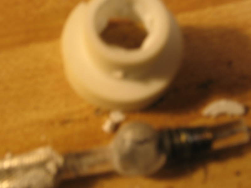

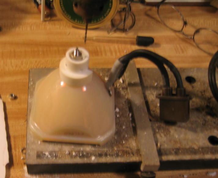

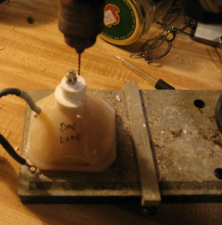

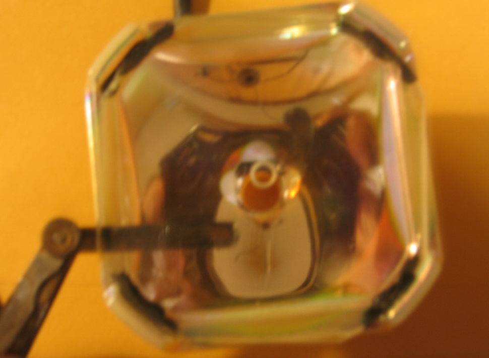

The Pictures say it all. A feeler gauge blade is slid under corners of blast Glass to break adheasive seal.
A Small drill. Do Multiple short Passes until you just break the surface of the cement from the rear. Wiggle it . Then dig it out
Hope this helps
