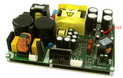

Hello,

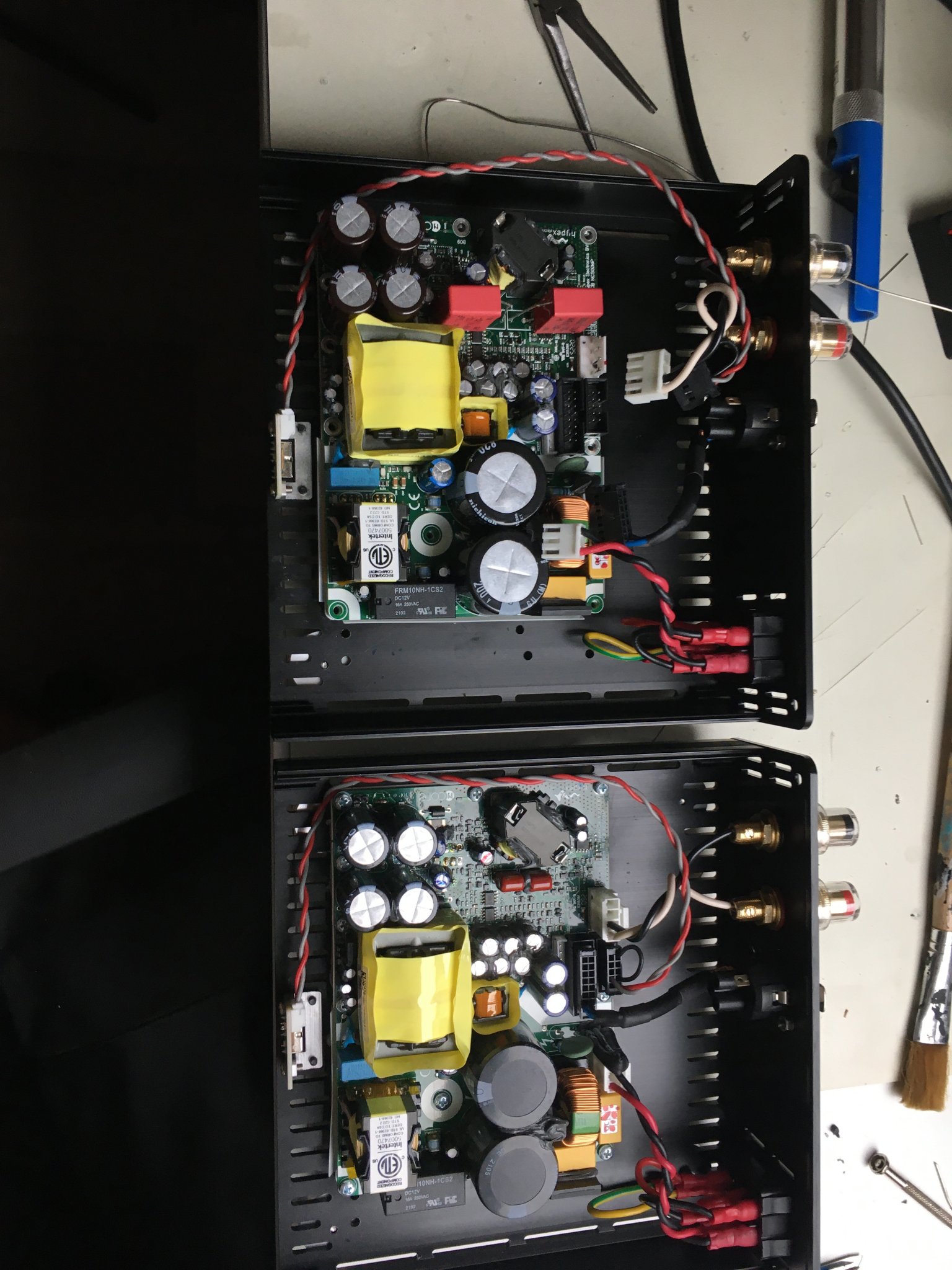

I've bought one year ago two hypex NC500MP modules, and mount them in two differents enclosures, and run without problem.
After power shutdown in my house, the two cards are burned !?!

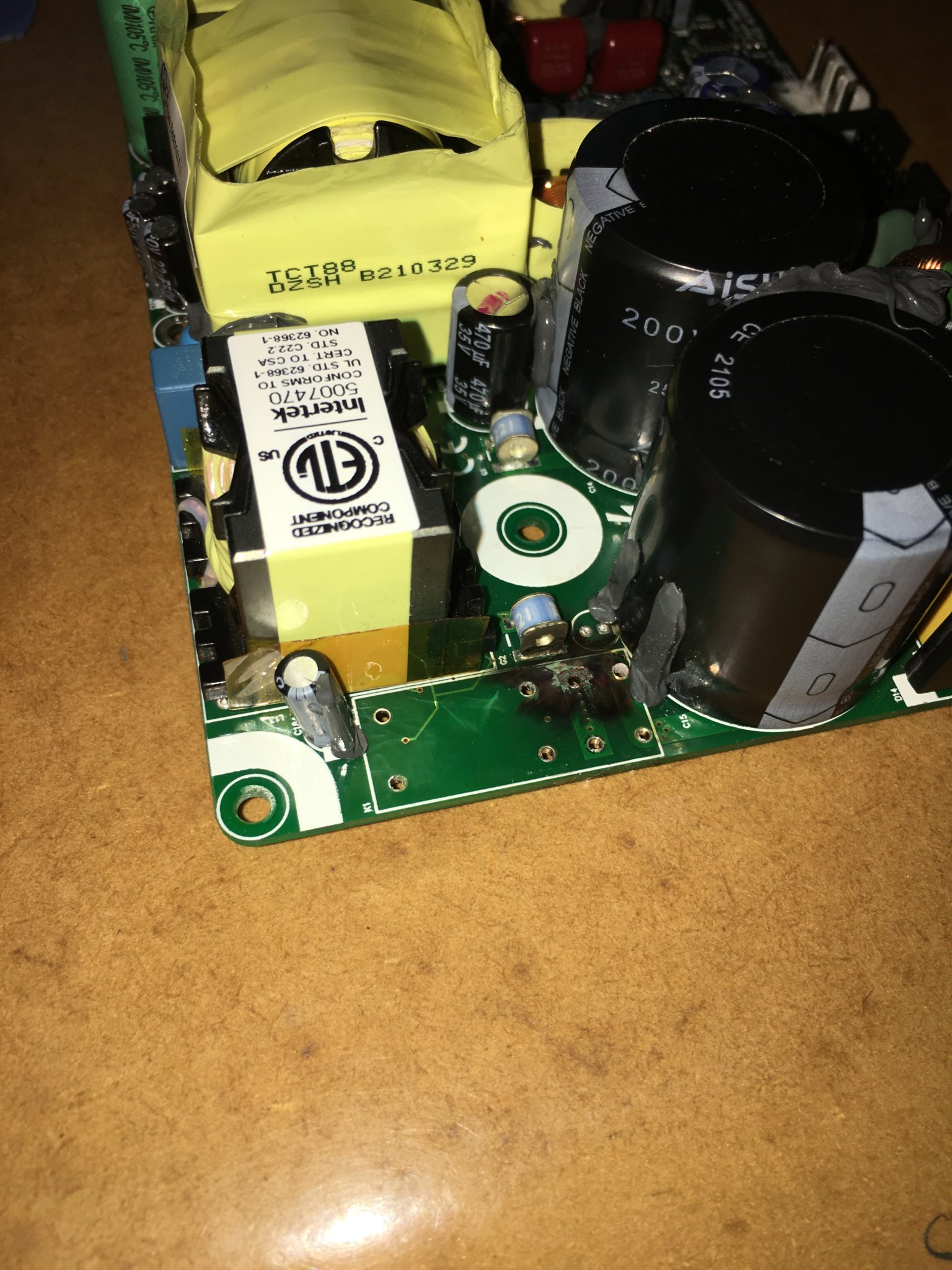

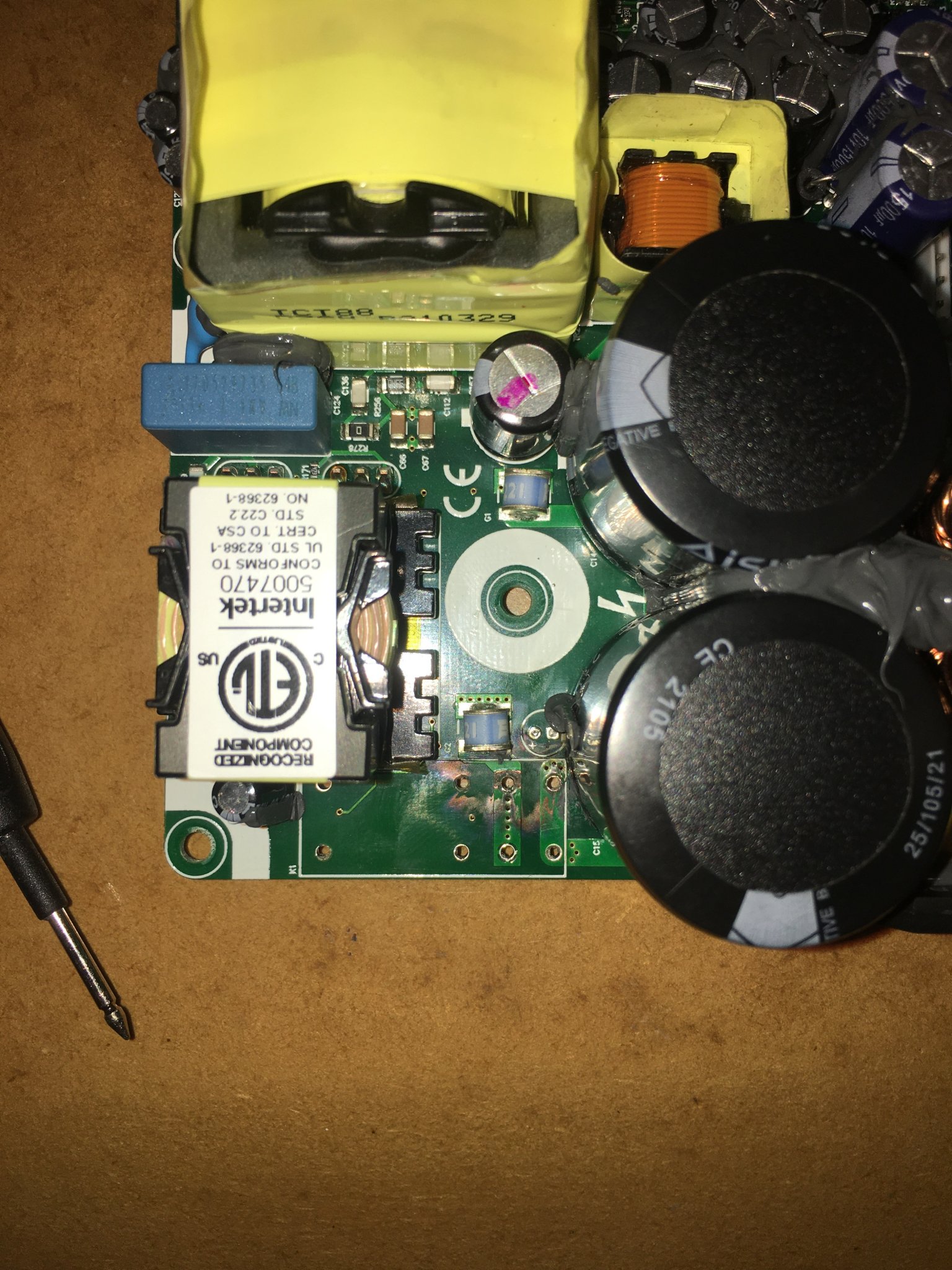

In one of the board , the main fuse have burn , and the seconde one, the capacitor C44 have explode, but the main fuse is ok...
No burning traces on board or componants ...
My pre-amplifier, DAC, Computer are Ok.
Do you had this experience with Hypex amplifier board ?
Thank you,Best regards

I have had a few Hypex UCD400hG HXr modules blow from a tube preamp turn on / turn off transient...I managed to get them all back in service by replacing the transistors, with a little direction from Hypex. These guys are very helpful.
After blowing an expensive Ncore 400 module, I finally put in a 60 second delay circuit in my preamp...duh. No issues anymore...
Replace the fuse and blown cap, test the transistors on bottom and you could be ok...
