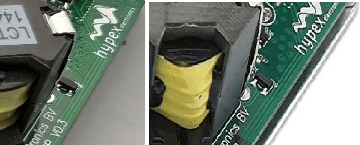

Well, its quite possible that they are geniune. However, I looked at pictures of this module compared to the pics at hypex.nl, and there are for sure some minor differences, like the Aliexpress module is using white glue between components, while all the genuine Hypex modules I've seen (and own) use black glue.

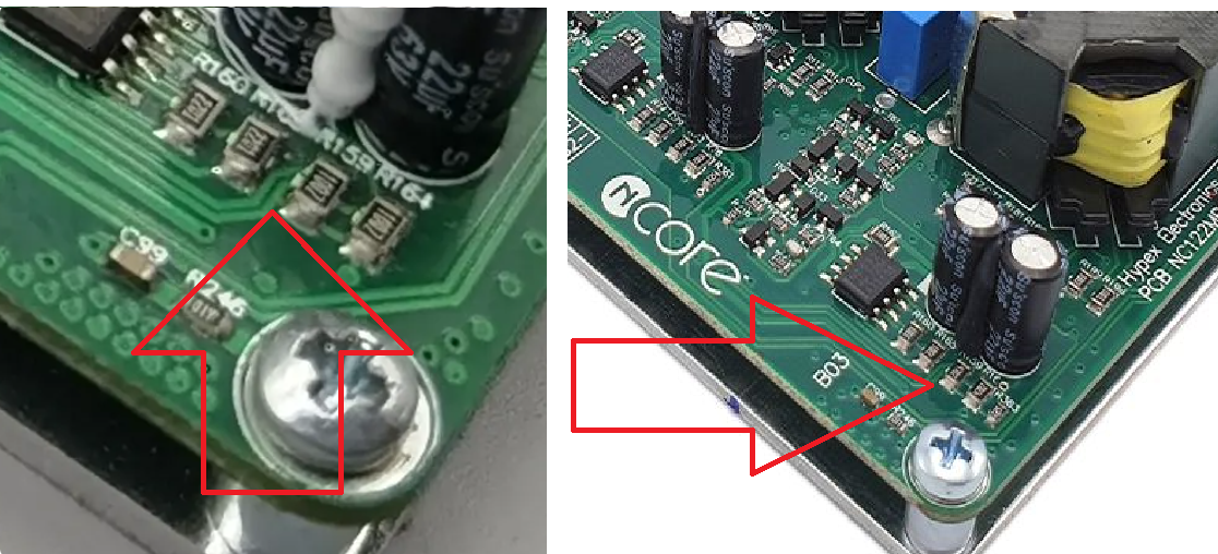

Yes - it could an different revision. The one to the right is from the hypex.nl website. Note the five SMD parts in a row there, while the Aliexpress one has got four. Some writing on the PCB is also different. I must say that I am skeptical here..
