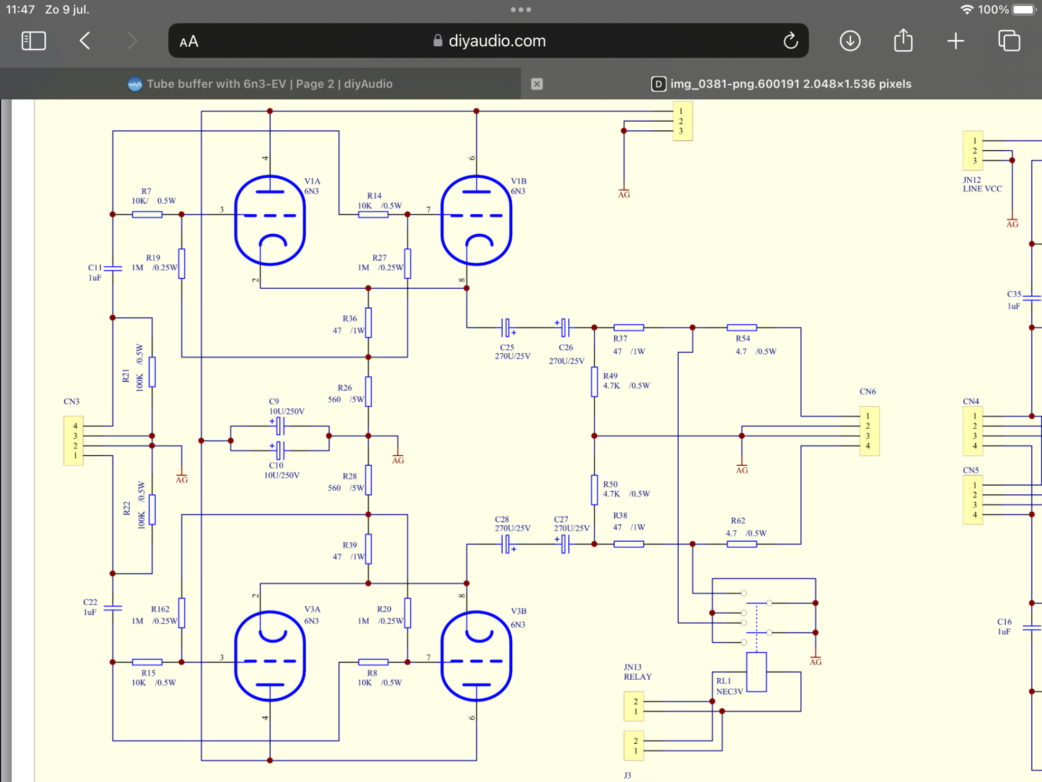

This buffer of my shanling cd-t100se you can also use for a nice passive source select and volume control. Just ad a source select/ volume control board . You have no gain.
Anode supply is 200V/ min 50mA.
