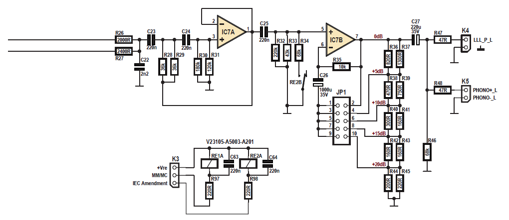

After having tried an awful lot of versions, this is what will be built the upcoming weeks. Instead of building a 10W Class-A, this one is working up to 10W in Class-A and 25W in Class-AB, biased at 1.5A. My opinion is that I rather have a little more AB headroom than a clipping 10W pure Class-A.
With the help of the ThermalTrak diodes and a pair of 1N4002 (mounted away from the heat) a trimmable slope temperature compensation is constructed.
As there is no negative feedback the distortion will rise considerably when going from Class-A to AB. Simmed results are below .1% at 10k below 10W. At 25W the simmed result is just over .3%. It will probably be higher IRL. Output impedance is indicated to be in the region of .3ohm.
12V for the heaters is a switched "notebook-adapter" and the highvoltage goes from there via a switched 5W Recom 12/210V DC-DC module.
After building this little critter I will also try one with a Lundahl LL1635PP (1+1:1+1).
In my opinion the simmed figures are a little optimistic. But the interesting thing will be how it performs when listened at.
Schematic: http://www.eflatjump.se/LTP/LTPsch.JPG
Frequency-plot: http://www.eflatjump.se/LTP/frekv.JPG
Waveforms-A: http://www.eflatjump.se/LTP/A.JPG
Waveform-ABclip: http://www.eflatjump.se/LTP/clip.JPG
(Current plots are taken at the .33 "emitter-resistors")
Temp-plot: http://www.eflatjump.se/LTP/temp.JPG

A few quick notes:
--C4 and C5 may not be necessary. Try the circuit without before committing. The MOSFET Gate capacitance will tend to roll things off on its own and may be sufficient to keep the circuit out of trouble. You can always add them later if you need them.
--R8 and R10 can probably be reduced.
--You might consider a pot to fine-tune the bias for M1 vs. M2, even if you intend to match the devices (which I would advise doing). Unfortunately, MOSFETs don't have a predictable Vgs and even matched ones tend to be off by a bit. Given your bias scheme, you're going to run smack into the Vgs problem. The circuit may work, but you'll end up with unpredictable performance and higher than necessary distortion.

Hi Grey,
Thanks for your comments!
I also got the indication that the depletion fets might vary considerably. I also did some simming of what might happen. By changing the drain-resistor R6 to 27ohms, I ran 25 resp 38mA through them instead of 38mA through both. Even if this is not exactly the same as two FET´s with different characteristics the following happened:
DC-offset went from 0 to 70mV at the output terminal.
Bias rose with ca 100mA.
Distortion rose insignificantly.
My friend who uses the DN2540s for CCSs has ca 20 items from the same batch so some initial matching won´t hurt.
About C4 and and C5 I chickened out 😱 when I noticed -3dB was at 3MHz.
About the gate-stoppers I was not so serious when choosing them, but rumours tell me these devices have a tendency to oscillate in the MHz area. But maybe 200-300ohms is sufficient?
Anyway, I had to delete the caps and lower the stoppers (to 330 ohm) to see what happened:
With only the caps removed there was a hump at 1MHz at +1dB.
Together with the lowered stoppers the hump moved up to 1,5MHz and was a little higher at +1,5dB.
With the original resistor values 100p was exatly what was needed to get rid of the rise. The -3dB lowered to 1MHz.
So I might keep them until I have checked the real life situation.

Just realized that the temp-comp was to complicated. Instead a suitable resistor above the two ThermalTrak will do the job. With the factor 3:1 between the two resistors the temp-comp might be right. Biased at 1A it will work in Class-A up to 10W. Also added the Vgs adjustment pot suggested by Grey:

Very interesting design and clever bias solution!
What are R9 and R12 for and how did you determined the values?
Cheers. Borko.
Cheers. Borko.
Hi Borko,
R9 and R12 is for centering the Circlotron to ground. Can be choosen between 50 and 500ohm, I guess.
