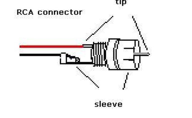

Right, the hot center pin is just connected to the ground shell for a shorting plug.

Try cutting one of the cold wires, left or right, doesn't matter.
Should break any ground loop.
To make sure I understand you correctly, my sub has the L/LFE in, and the R in (in RCA form), and assuming my receiver is connected to L/LFE, you're suggesting I effectively remove the entire R plug? (or cut the cold wire to the R plug)?

Your sub uses left and right rca connector, my proposal is to open one of the rca plugs and sever the cold wire ( outer ring on plug) if it actually is a groundloop the path of hum should now be broken.To make sure I understand you correctly, my sub has the L/LFE in, and the R in (in RCA form), and assuming my receiver is connected to L/LFE, you're suggesting I effectively remove the entire R plug? (or cut the cold wire to the R plug)?
Why would that help? It's not connected to anything anyway? I suppose it might be connected to the chassis... but does that matter?
