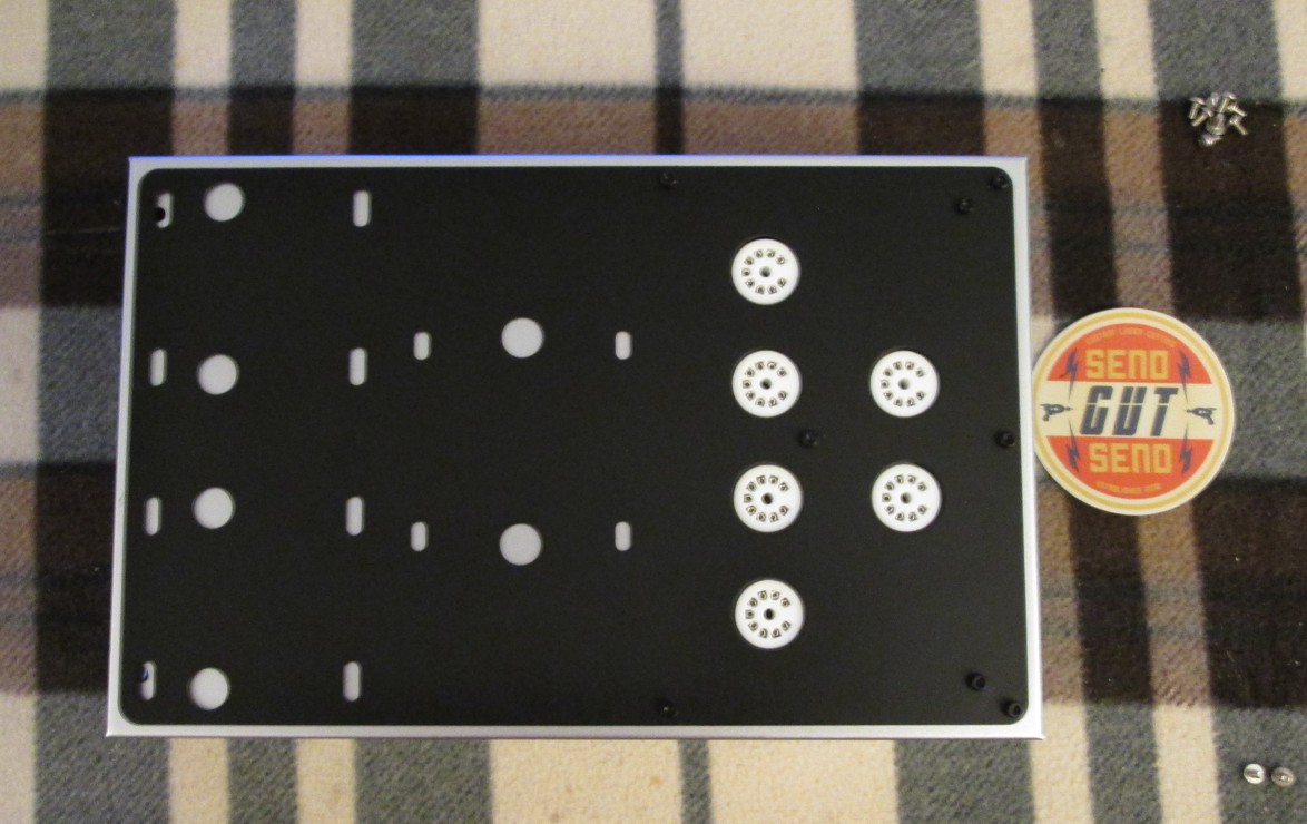

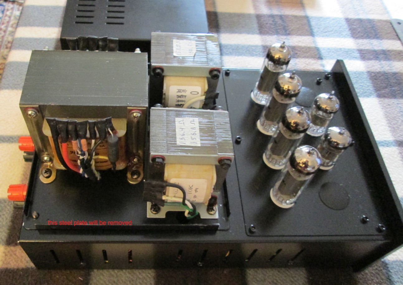

I am very happy to report that after having to set this project aside since my last post in March 2024, I have finally been able to resume.
The next step was to have SendCutSend make a new top plate for me to accomodate all of the new holes required. I had them make it out of steel with matte black powdercoat for durability. I had to enlarge my front screw holes a tiny bit, but everything fits perfectly including the PCBs and the tube sockets. That's a relief! The cost was $56 including tax and shipping, and I considered that quite reasonable. Now I have to figure out how to open up all of the areas in the chassis (the silver areas below) to match the holes in the new top plate. I'm not quite sure how to do that, but I envision a lot of drilling and hand filing. I want it to be neat and clean. As you can see, I am again leaving out the magic eye tubes so there are no holes there. I just don't want them.

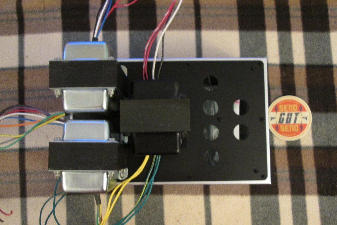

The top plate openings for the new transformers are perfect. Custom power transformer by Musical Power Supplies to work correctly on USA voltage. The massive output transformers came from Primary Windings in England. They are bigger than needed, but that's what he sells.
My next step is to open up all of the holes in the chassis to match the top plate, then paint the chassis and transformer bells matte black. I forgot that I already bought a miniature stepped attenuator for volume, so that was nice to find in my parts box. Now I need to order all top-quality parts to populate the PCBs and six top quality tube sockets.

Pay attention to the orientation of the transformers, relative to each other.
This is also why it is useful to do a "dry run" assembly before choosing the final assembly.

That issue comes up every time someone sees the laminations going in the same direction. The laminations do not control the orientation of the magnetic field. The coil winding does. On the PT the coil is wound horizontally, parallel with the chassis. On the OPTs the coils are wound vertically, perpendicular to the chassis. Therefore, the magnetic fields are at right angles to one another. The coil and lamination orientations are the same as the ones that come with the kit, and there is no hum.
This is the pre-tested and final assembly layout.
Reference materials: RE transformers and magnetic field orientations. This is why a nearby transformer with a coil wound at a 90 degree angle relative to another transformer's coil will not induce a voltage (hum) in the other transformer.
Magnetic field orientation is relative to the coil, not the laminations.
Original design has identical coil orientations, with vertical coils on OPTs and horizontal coil on power transformer, laminations in the same directions are ok because they are not the controlling factor. I specified the transformers that I bought to be oriented this same way because it works. I just shifted the power transformer to the middle of the chassis instead of the back.

What is the purpose of the big black resistor in series with one of PT windings? The voltage was too high?

Yes. The power transformer that comes in these kits from China is designed for 110 volts, which is fine in many other countries but not here. Even the newer ones that are labeled 115 volts are still actually 110. USA voltage is 121 volts where I live. So that resistor is to drop the voltage to the 6N1 driver tube filaments just enough to keep them in proper range. In the power supply, I had to also change the 100 Ohm in the C-R-C filter to 200 ohm to get proper voltages. The original build thread is here: 6P14P/EL84 Kit Building. With those adjustments I ended up with perfect voltages, despite the 110V transformer, and without having to use a bucking transformer or 100V supply, and it works perfectly.
The other two resistors you see there are a "virtual center tap" on the filaments for the output tubes. Many people miss those because they are not included in the kit, and without reading the direction manual that I translated (https://drive.google.com/file/d/1e6C1yM-10nynSAAbiULZAbfQxw6WqdfS/view?usp=drive_link) some people would never know because they only receive a schematic, which does not show them, and not the full 67 page direction manual that does show them. Those who do get the manual get it in Chinese, so I did a public service and translated it to English. Anyone who wants a copy, please download it because sometimes the Google link quits working.

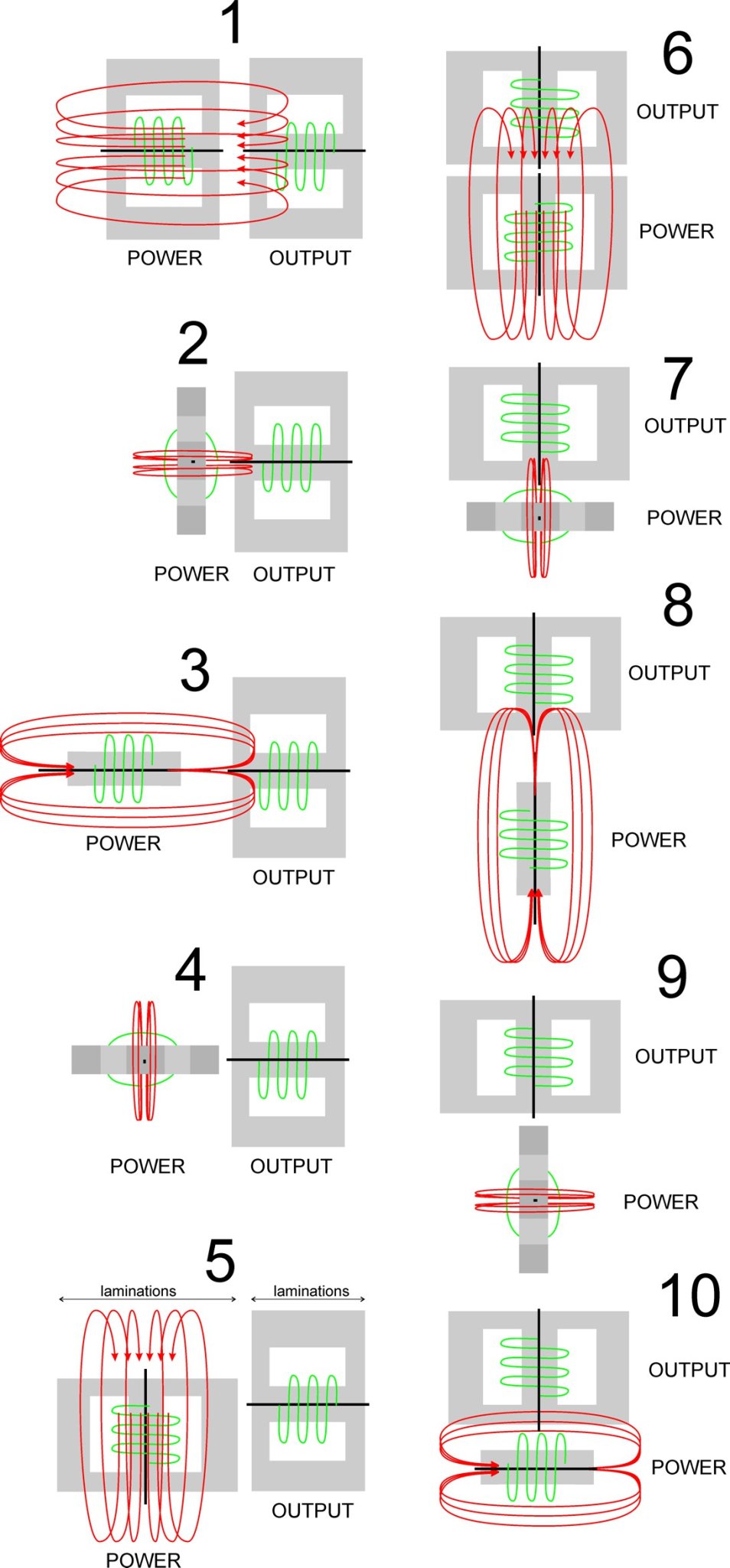

I like that, but I wish he had done a better job explaining the magnetic fields involved, especially why his "better" option is not ideal.
I'm not good at rotating objects in 3D in my head. Maybe this drawing will help someone in the future. I have tried to show the situations where the magnetic field lines would run parallel with the core of the OPT. My drawing skills aren't great, but this should be adequate. If anyone sees something obviously wrong, let me know so I can fix the drawing. This amplifier uses layout #5. That's the way the original kit was laid out, so I kept it that way when I ordered the transformers.

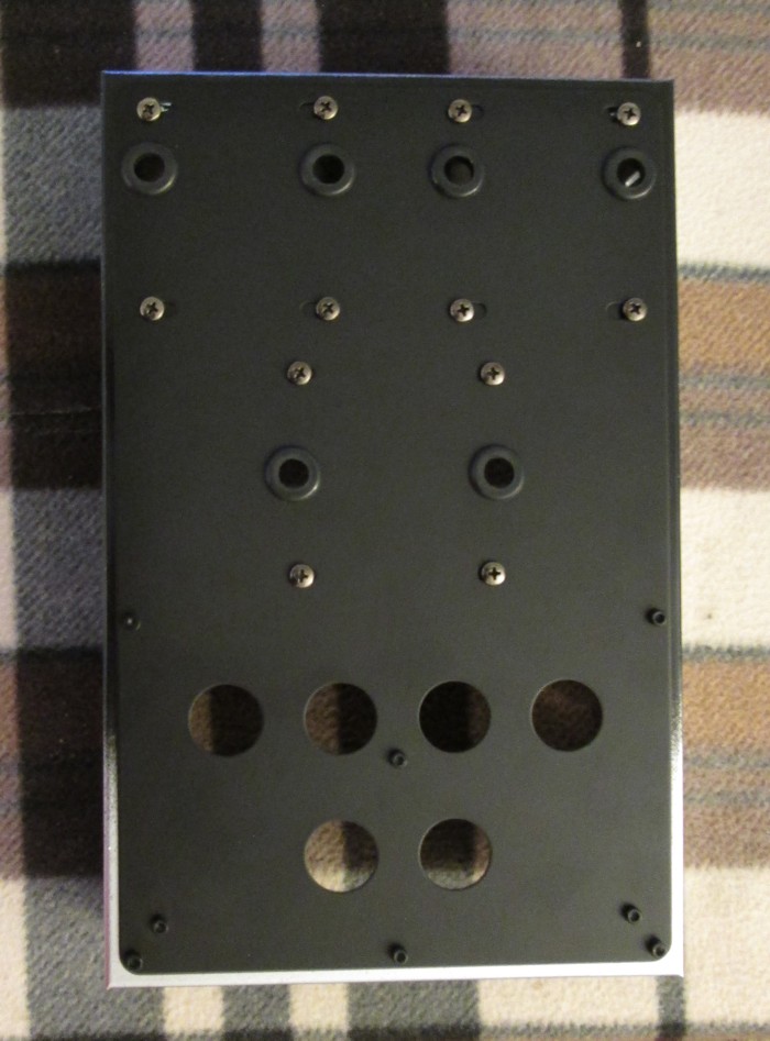

I can't believe that I just paid NINE DOLLARS for six rubber grommets! 😡 At least they had the correct size. For that price I almost used double heat shrink instead. The holes in the chassis under the new top plate are nice and smooth. I filed and sanded each new chassis hole I had to make until it was all smooth to the touch.
Now I have some more black painting to do, but with rain and freezing weather, painting is a no go right now. 👎 The PT and one OPT are finished, and the bottom is finished. The chassis, face plate, and one OPT remain. Then decals and multiple clear coats.
Top plate is nice and clean, and everything fits perfectly.
