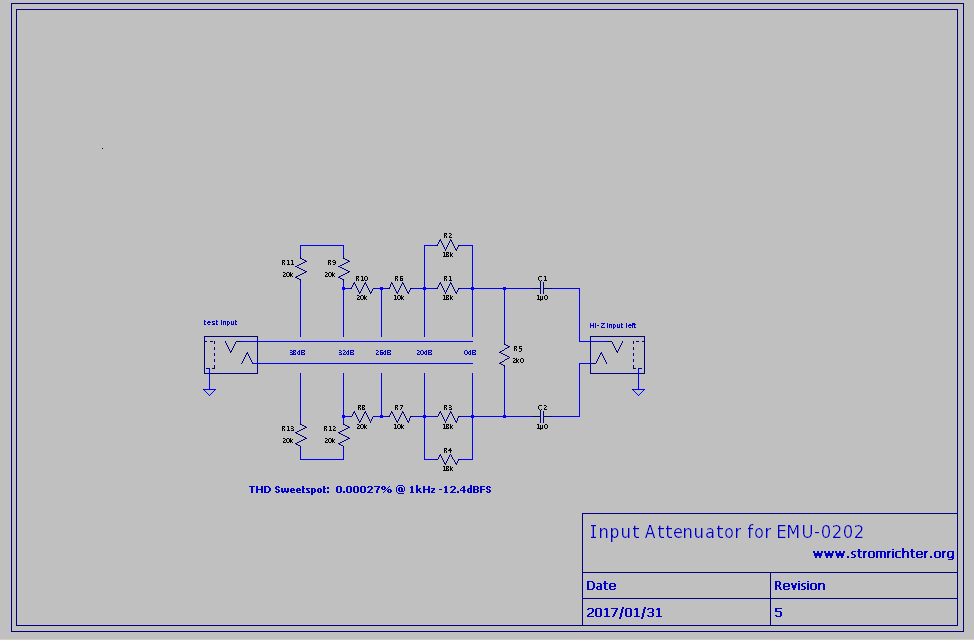

This is the schematic from Post 1:
759761d1559165648-howto-distortion-measurements-rew-a6089679-b353-4e2b-abd2-b248adb1a49a-jpeg
Now replace the DUT with your preamp, and the 8ohm dummy load with something like 10kohm - or whatever load your preamp is supposed to be able to drive. Some preamps are designed to drive 600ohm loads. Some are more like headphone amps and can drive 32ohm loads.
The important thing is to make sure your load resistor is non inductive. Wire-wound and thick film metal oxide are terrible for low distortion.
Use metal thin film if you can. You may need to adjust your signal attenuator to match the range of your audio sound interface input. Also use quality metal thin film resistors here. Dale CMF55 are great for this.
The attenuator design by Voltwide is very handy. I just use one or two values that get me the 10:1 or 20:1 range I need. For a preamp, usually the input of the sound card can handle the full dynamic range unless it’s one of those monster preamps like the Aksa Lender capable of 60Vpp.
Here is the Voltwide attenuator - it’s AC coupled to the balanced inline input so also good for BTL amps:
779737d1567772891-tpa3255-reference-design-class-amp-gb-att-png
Looks like this:
779736d1567772891-tpa3255-reference-design-class-amp-gb-evm3255_pvcc_test_no_load_p2160001-jpg
Make sure your grounding is good and you are not close to mains cables or have big laptop SMPS plugged into same outlet as you test equipment.

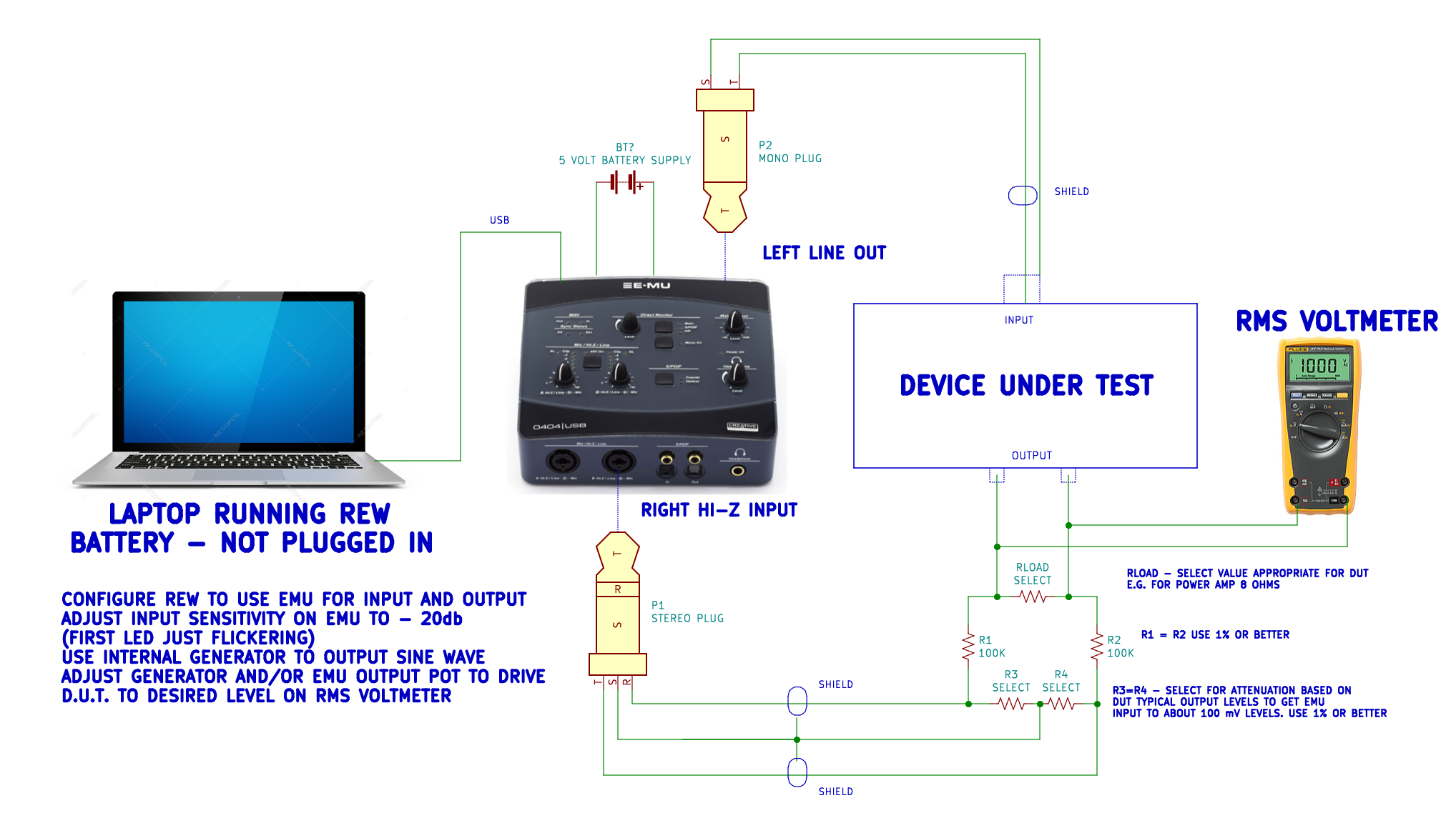

Here a sketch of the setup I have been using with an old EMU 0404 USB. I am using the Hi-Z low-level balanced inputs. I found that running the EMU from a cell phone battery supply eliminates a lot of the noise from the default wall-wart. Also, based on the findings of some other people, the right (or B) channel is a little less noisy than the left. I typically adjust the input level pot to just get the first level indicator LED flickering.
It would be useful to replace the fixed attenuator resistors with a selector switch as was previously mentioned in this thread, but I did not bother to do that because so far I am only doing power amp tests, not line level preamps.

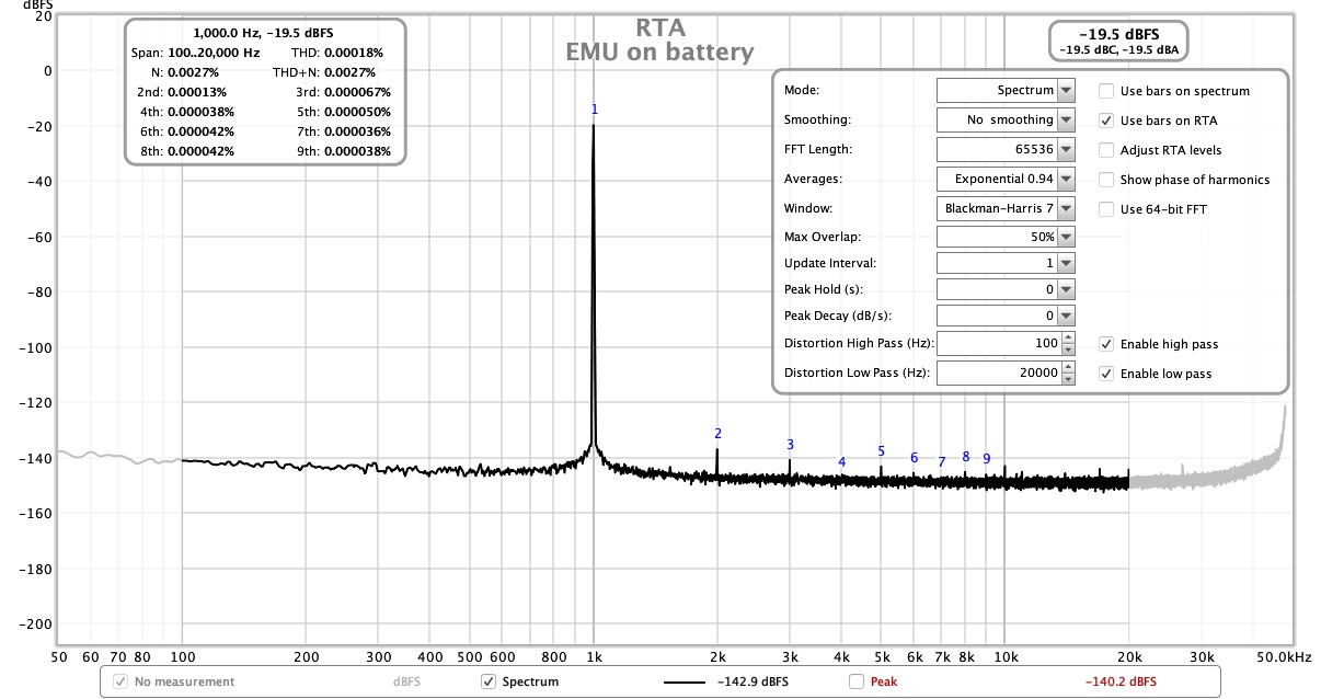

Here is an REW FFT of the EMU loopbacked:

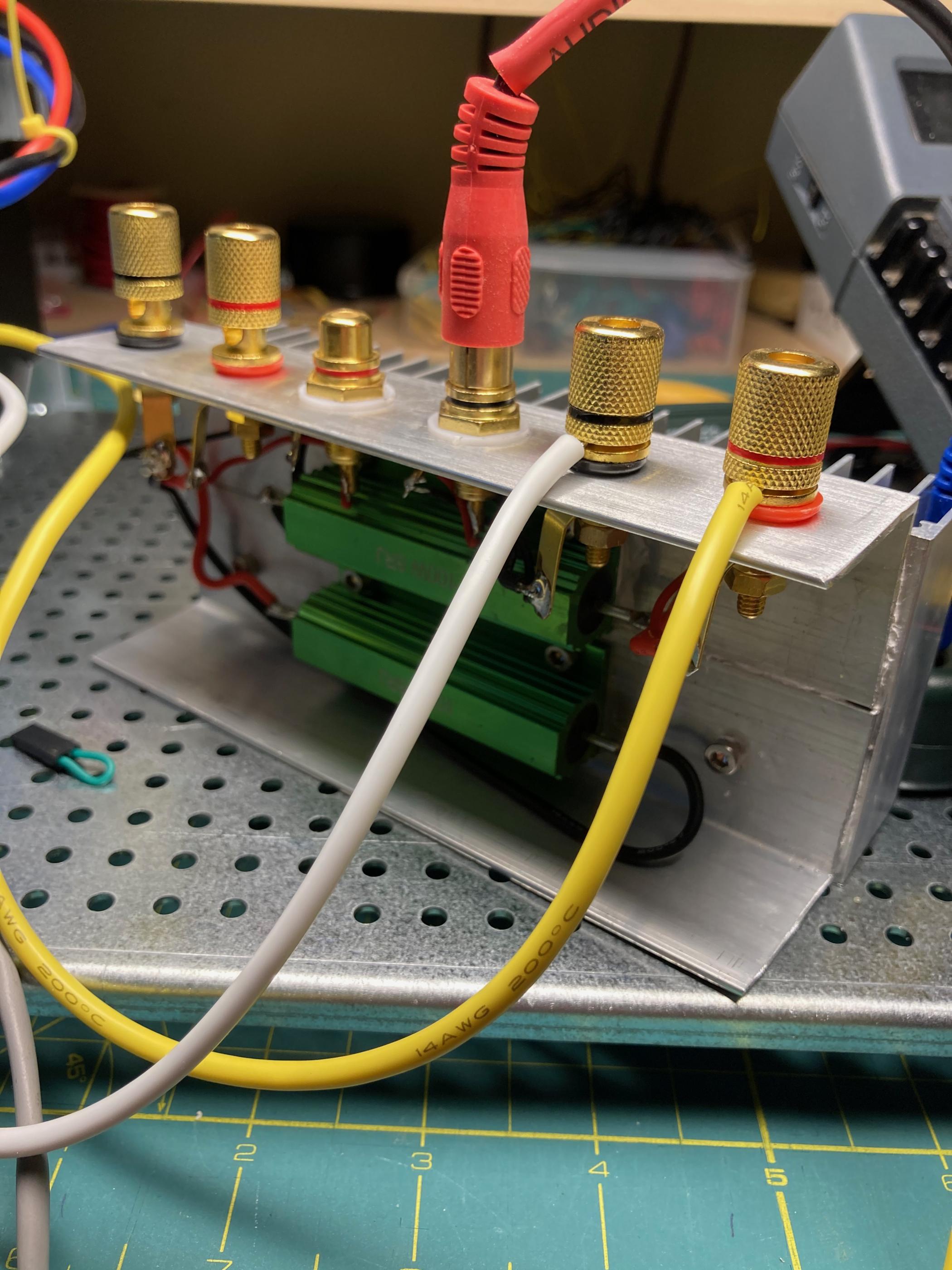

And here is my quick and dirty dummy load with the attenuator resistors:
EDIT: that's an old picture of the dummy load, just showing the load resistors. I added the attenuator resistors later and use both RCA jacks to feed the differential signal to the EMU.
Slight update on the attenuator resistor values in the sketch I posted before. For the series resistors, I currently have 10K (R1 and R2) for the series resistors and 100 Ohms (R3 and R4) for the resistors to the common connection.
This gives a 100:1 voltage reduction, which seems to work OK for amp testing up to about 30 Volt p-p without overloading the EMU's inputs.
You could pick a lower ratio for line-level testing.
