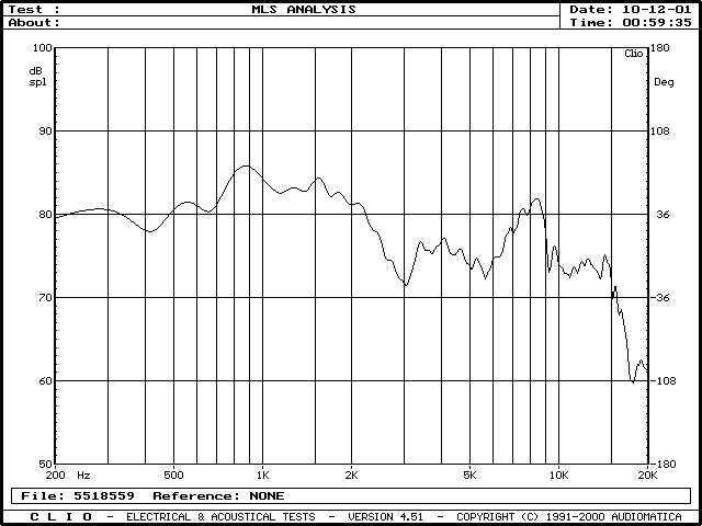

The MCM 55-1855 i have done some work with... i don't find that they rolled off that quick -- particularily after a bit of modding (blue curve). (in box, uncalibrated mic)
dave

here's what zaph says about'em on his webpage, this is more like what i heard.
"Using a pair of MCM 55-1855 aluminum woofers and a Seas 27TFFC. These woofers are one of the all-time great values at $13 each. They required a low crossover point due to an early rolloff, which in turn required a tweeter with the ability to cross over low. Aside from that, these woofers are well behaved and sounded excellent at low to medium volumes. The response curve was almost a straight line, but intentionally tilted down a few db across the top 4 octaves. This gave a smooth, warm relaxing sound, particularly in larger or reflective rooms."
a few db tilt across the top four octaves is not a biggie to me. my ears prefer that to a ringing dome...

The woofers are well behaved, but only below their intended crossover frequency.
To me the PE woofer sounds just like the MCM. No coincedence since they measure the same and are made the same.
If you would like a copy of my design docs, let me know and I'll email it to you.
I don't like people misinterpeting my words, so I have to reply. When I said the response curve was tilted down, it's because I intentionally added circuitry to the tweeter crossover to do this. It's not from running the woofer full range - That would sound both dull and piercing at the same time from the rolled off top end and breakup node. I crossed over at about 1800 hz.noisenyc said:

4th Order Linkwitz Riley. It only takes two components combine with the natural rolloff to get there. These Seas tweeters have some serious low frequency power handling balls.
Full range metal cone drivers are rare, but I've heard some people say the MCM 55-1291 is a little more suited to wide range use. I haven't measured one though.
