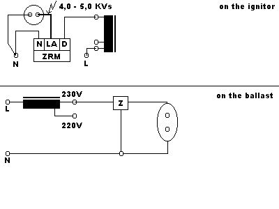

hi,
had a hard time, getting my scanner to work again, and in the end, i used good old ms-paint 😉
here is the circuit-diagram from the ignitor and the ballast (the Z in the ballasts circuit diagram means "zündgerät" -> ignitor, i think).
i can't figure out, how to wire up the ballast, cause in one diagram the small line from the ballast-symbol shows in one direction when everything is put together, in the other diagram it points in the other direction.
thanks for helping 😉

Both drawings are the same; you have 3 connections on your ballast, only 2 are used. The ballast can be connected either way as long as you leave the connection for 220V unused(polarity = dont care).
L,N connect to your 230V. (polarity = dont care)
Just use the schematic from the ignitor, that one is the easiest to trace.
btw
I don't see any capacitors in your schematic. Your power supplier wont like that. (and it might cause interference on the powerline and screw up radio reception)

hi,
i tried wiring it up, using the ignotors diagram, turn on the power switch, and my room went dark (fuse came out).
any ideas, what i might have done wrong ?
there are no circuits short etc. 🙁
do i have to ground the ignitor also ?
(i did connect the ground to the ballast, cause there was a screw with the symbol for ground on it, but there's no such symbol on the ignitor... just this huge screw 🙂 ).

Assuming your parts are not defective you *****ed up during wiring 🙂
All you need to do is enlarge the schematic from the ignitor, put your parts on it (top left=bulb,center ignitor,ballast on the right) and connect pieces of wire according to the lines on the paper.
The connections on the ignitor viewed from the top (where the schematic is on) correspond with the connections as shown on the schematic. Remember not to use the 220V connection on the ballast.
I cant be more specific then this. (Give a child some wire, an enlarged schematic and this description and he'll get it wright 😉 )
Good luck

i double checked it and it seems to be correctly wired. i was using a multiple
power-socket thing (sorry, don't know the correct expression for it 🙁 ).
basically it is something, you connect to your power socket, to increase the number of power sockets you have 😉
this "multiple power socket thing" has a swith, to turn it on and off. when flipping the switch (with my setup plugged in) the fuse drops out. i remember having a similar effect when connecting my tv to it and switching it on.
maybe our wires can't handle that much current at once ?

sounds like an overload of current try it with out it, the thing is called a double adapter, and they are dangerous lol but u have a protected one so it should be ok, whats the rating on it?
