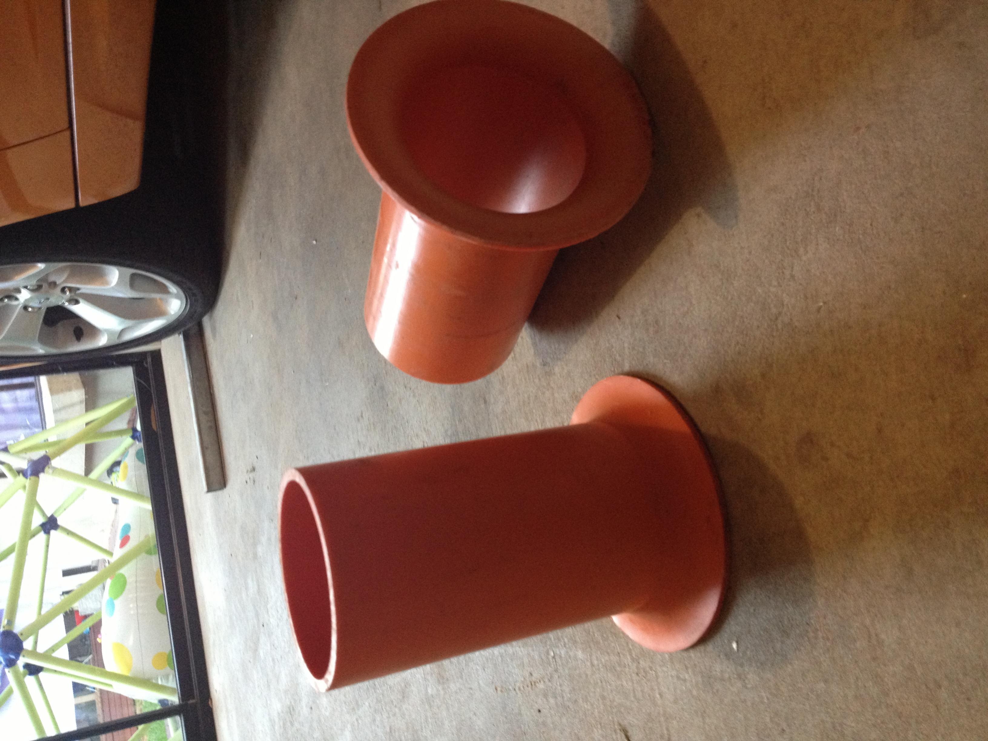

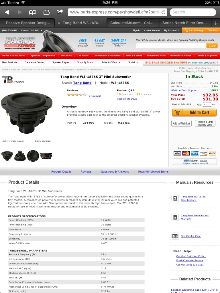

I've got some electrical conduit flares 100 mm internal by 210 mm long and wanted some thoughts of what they could become 2 thoughts maybe stand alone subs stand the flare off the ground and driver mounted in top or the same as before but extend conduit up and a small line array 500 mm high any thoughts

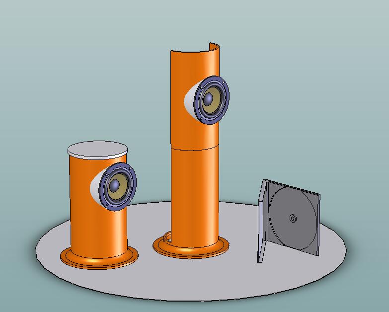

Open baffle
I like the open one looks sweet but might use two drivers per side is what you've drawn open baffle ? Dose this type need to be close to a wall to sound good? Thanx for the effort you've put in I'm gonna have to start fabbing need to thing of a top colour for them
Most people seek for colour in the sound -or absence of it- when making speakers. Needless to say most of DIY objects are obscene at first sight!
But...the goal is good sound, the looks come second.

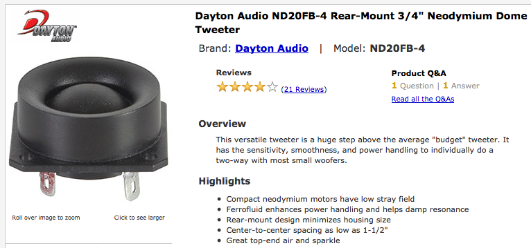

BTW I was looking at the first TB speaker either. It has double power than common speakers ( those that come supplied in cheap Pc speakers ).
Maybe you need a simple fullrange because that one don't make any treble sound.

I would build a box instead of thinking what to do with those tubes.
For me, a double chamber reflex worked well.
