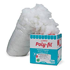

Hello, I just made a pair of speaker cabinets for my PS95 Dayton audio full range drivers which are going to be used with a sub as a 2.1 system. I am having trouble figuring how to stuff them. I understand that the best way to stuff speakers is to try and see what sounds best, but I would like some guidelines. The internal volume is 0.1ft3(2.8 liters) and I am using this insulation Buying a Sonofil - Black? | SoundImports - SoundImports and Buying a Monacor MDM-4? | SoundImports - SoundImports
Am I supposed to just layer it in the inside walls or try to expand it and stuff it inside? How much should I putt? How close to the driver?

Both of those look like batting, not polyfill which is fibrous. The 2nd one is certainly a poly.

What's the difference between batting and polyfill? They are sealed.
For your application, I would choose the Monacor 60% cotton, 40% polyester mix, but the other seems OK too.
For your sealed enclosure I would form the damping sheet into a loose cylindrical roll whose dimensions suit the enclosure.
Leave some 'breathing space' directly behind the driver by ensuring that the driver's magnet won't unduly compress the damping once the driver is installed.

Batting is in sheet form, commonly 100% polyester, typically made for making quilts and such. Its form works well for lining the enclosure walls. It can also work well for stuffing, as Galu illustrates, or by using very thick sheets and layering them.
Poly-fil is the same stuff as 100% polyester batting, but in loose form like in a stuffed animal or pillow. That works well if you intend to stuff the enclosure fully, or to the point that it begins to affect the thermal properties of the system. If you go this route, again be sure to leave a little room between the driver and filling.

Batting is much easier to tease out into the chaotic mess that works best.
The above is acoutastuff — a bit harder to properly tease then standard polyfill.
Bat is a sheet used for making quilts/coats etc, fill is used for pillows and such.

I’d typically choose the damping material with more organic material. Do note that a good trick is to mix polyfill with sheeps wool to get the best of both (you still have to worry about moths).
