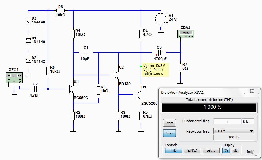

All those changes are good.Thanks
and how to set VCQ3? which resistor to adjust?
I will use an SMPS with 24V/100Amp rating + enough filtering, so no issue on
You should add one more diode in the input.
Makes 3 diodes for the first transistor.
This will make the VCQ3 around 10 Vdc.
You can expect output more than 1 Watt RMS with a distortion less than 1.0%
My SPICE simulation did actually gave 1.7 Watt at THD 1.0%
I used 4.7 Ohm and 0.1 Ohm + BD139
and 3 diodes for input.

If you are allowed to change the supply voltage, the value of R7, R9 value, replacing any driver transistor, VCQ3:
Vcc = 36.7 V
R7 = 8 ohms (may be lamps in parallel)
R9 = 0.1 ohms
Output power = 5 W RMS into 8 ohms
VCQ3 = 9.4 V
Quiescent current = 3.41 A
Power R7 = 93.17 W (a lot of heat!)
Power R9 = 0.86 W (reasonable)
Power Q3 = 30.91 W (also reasonable)
Power Supply Power: 108.76 W (possible)
Efficiency: 4.6% (not high but it looks interesting)
regards

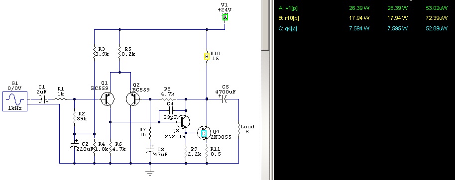

How about this one?
Diff. input stagw, higher gain and a rather reasonable idle dissipation
Again, thanks ...
That circuit looks a little better. The output power is about 0.9 W into 8 ohms. It is not insignificant if we use efficient speakers. The distortion is lower than the previous design. DF is higher (can be read as a good thing).
