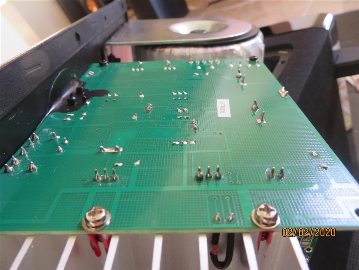

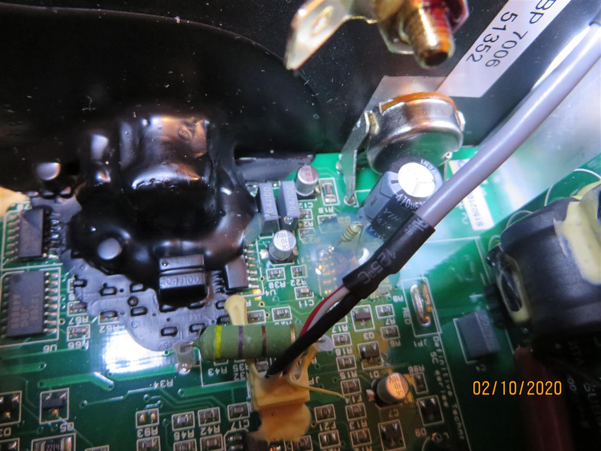

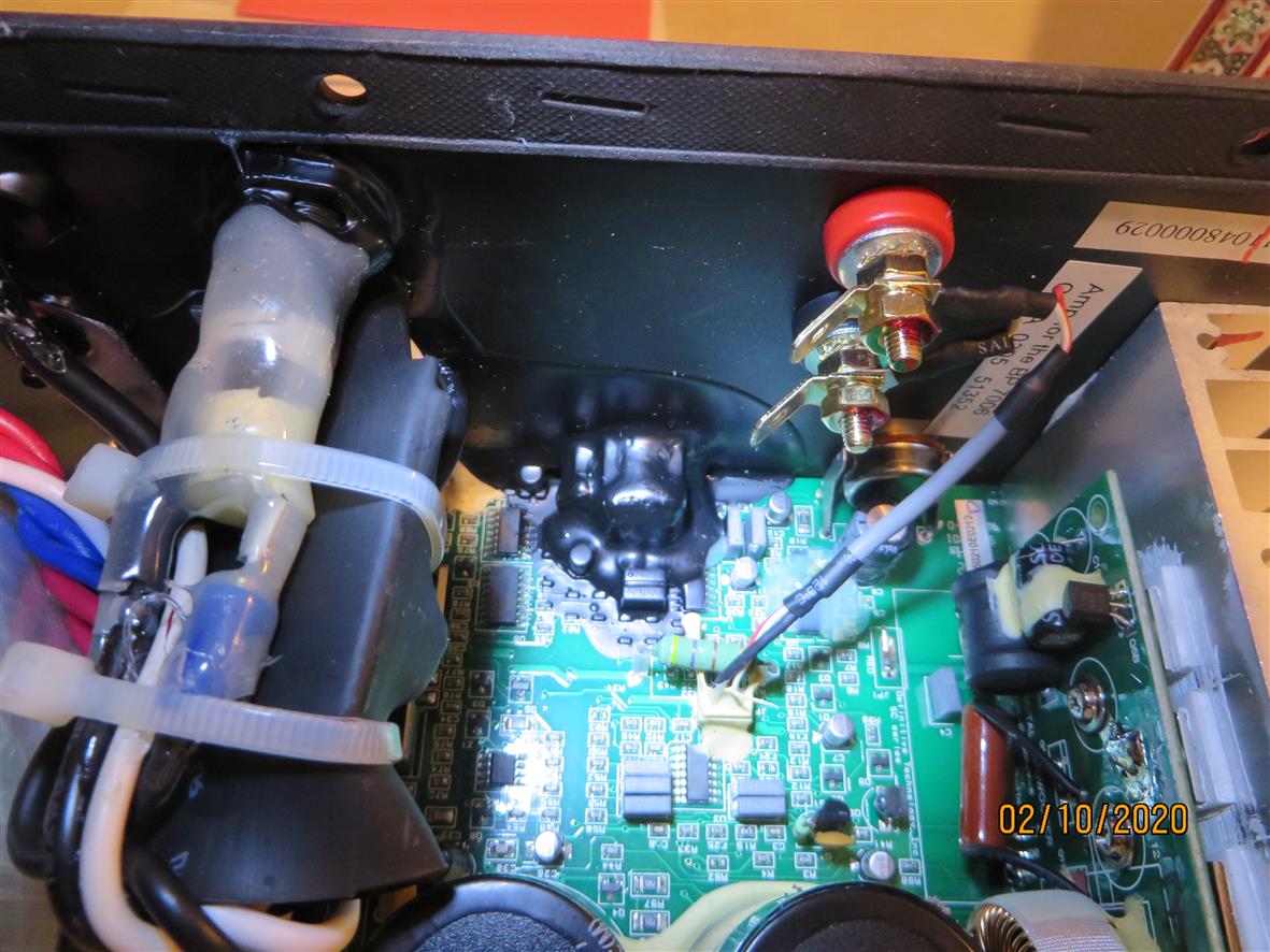

I got a bad volume knob (potentiometer) on this PCB board. To replace the pot, I need to remove the board from the metal plate which is sealed with resin silicone potting compound as shown in the pictures.
I put once WD40 and Acetone on the black colored compound with no success. Also, heat could damage the PCB board and the parts on it.
What is the easiest and safest way to remove the PCB board from the metal plate?

there is no easy way, try mechanical means, chemical wont work
What kind of mechanical means?
milling, scraping, cutting, ripping, fingernails, cutting tools….silicone is soft and comparable weak so use your imagination 😉
If it is genuine silicone rubber, then silicone digester will work, but you ought not to need it, as silicone rubbers don't stick to anything, which is why they are used in mould making.
If it is actually a rubber like polyurethane, then it ought to be very well bonded to the components as polyurethanes are very aggressive in that department prior to its curing. You may find its glass temperature is likely below 85'c, so heat will make it flexible and that will be a way in.

See if you can get hold of dental tools. They are very tough and thus useful for peeling away potting, silicones etc. I also use them for cleaning flux off around large solder points.
I've depotted boards before by carefully heating with a hot air gun and slowly chipping away the glassed compound. It can be time consuming but it is possible.

I have used naptha to break down and remove silicone adhesive/sealant, might be worth a try.
Be sure and allow plenty of time to allow it to evaporate before any soldering however.
