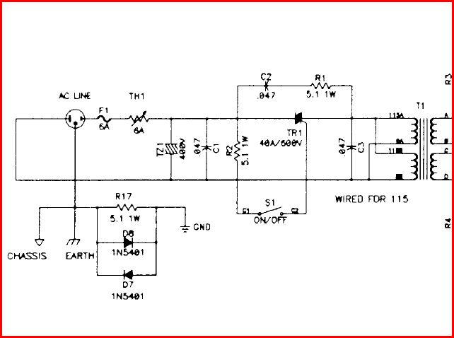

I wouldn't imagine so but you could still use these to control a Triac and switch the load that way.
This is one of Nelson Pass's designs from the A75 (I think). The switch only passes a very low current.
Use of DPST switches isn't a requirement as long as the basic design follows all the safety rules.
