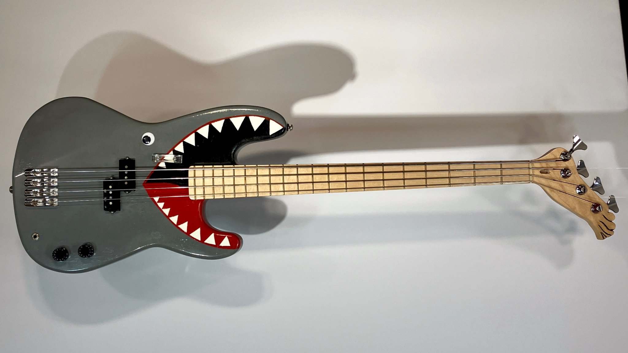

And jordheis, poly fill might address my only real beef about the amp. It's very light and smaller than a 1x12 extension cab. There does seem to be either a midrange wolf resonance or mud issue. I zero the upper-mids knob or else certain notes on the D string give the ice-pick effect. My only bass is a P-bass I made myself, with a Quarter Pounder (Duncan?) pickup and flatwound strings. I'm not really a bass player. I play for my own recordings and I'm used to playing thru an Apogee Duet & KRK VXT6 monitors, uncolored. I need to learn how to adjust a bass amp and the instrument setup. Playing on direct, the string-to-string response was relatively equal, with the pickup height only ramping up a little, from bass to treble. Pretty much a factory setup. Since getting this amp, I have had to lower the E string pickup almost flush to the body, just to keep the lows from completely overpowering everything else. I like to feel a thumpy E, but this is mushy. Maybe it's noise I'm not used to hearing because my studio monitors lack a subwoofer. Or it could be my strings. Flats are comfy to play & there's no scraping, but everything else about them is inferior to round wounds, IMHO. Poor intonation, less equal mass from string to string. Somehow, these artifacts never rose to a bothersome level before I got the amp. I guess, as I write this, I have decided to try round wound strings. Perhaps that will make everything else better.

I installed round wound strings and that improved the string to string volume disparity & the intonation, such that instrument sounds alright with the pickup adjusted to factory height. I rashly set it up with the action too low. Buzzy.
