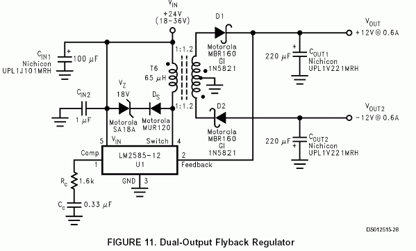

Somebody suggested National. Here's a schematic from their LM2585 datasheet. Looks like the transformer may be available from Coilcraft.
A word of warning: switching power supplies are notorious for being difficult to build. Chances are you'll probably face a few problems while building.
