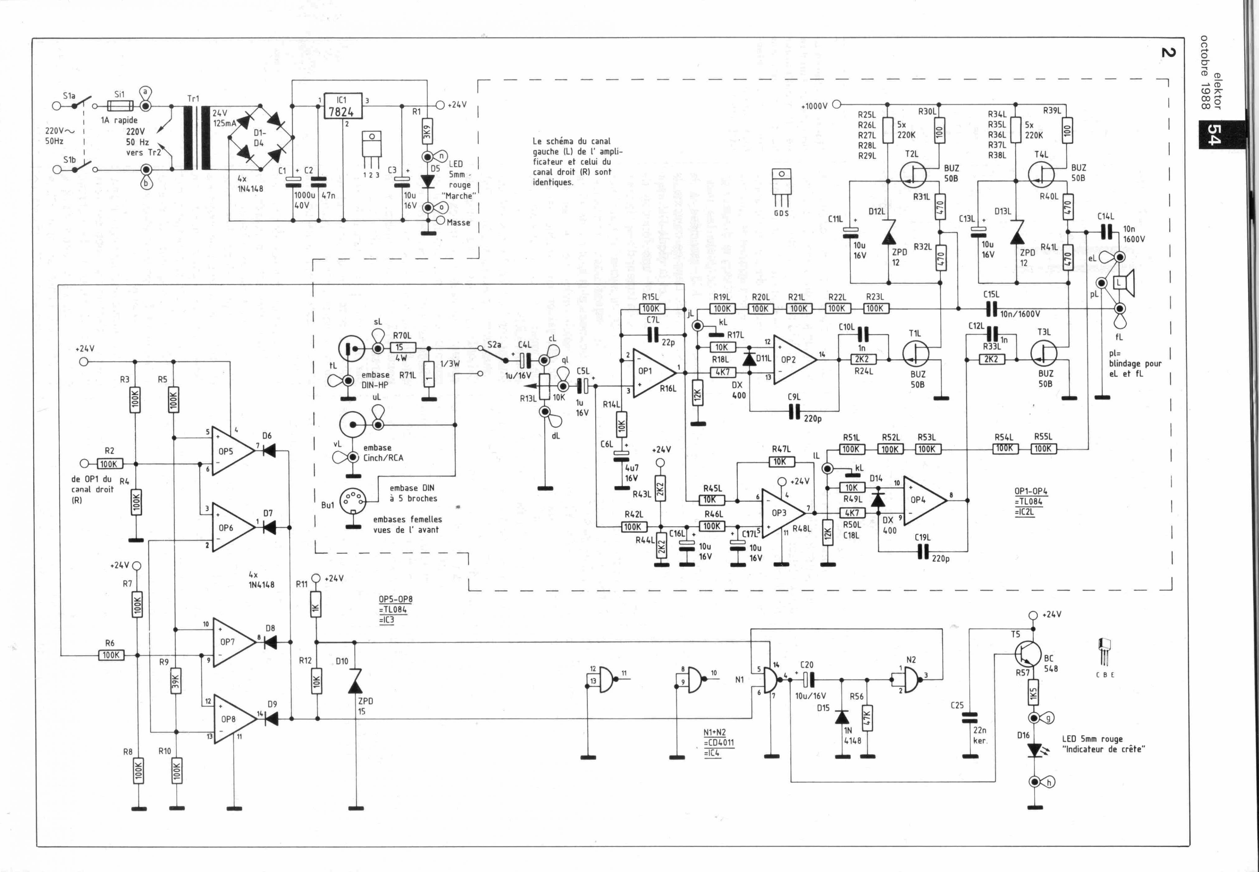

a very old design is quite interesting : direct coupling of the electrostatic speaker to a high voltage tube push pull. All you need is these high voltage tubes and a power supply 5,000 Volts at 50 mA . I tried that once with a Quad Esl and FM transmitter triodes made in Russia. Was absolutely excellent sonic quality until the triodes begun to glow bluish... that was it.
Long time ago Elektor has published an amp for high voltage output.
Perhaps you can find the description and prints still there.
Mona
