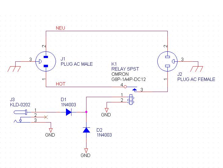

Now that I have a huge amp that draws 60W in standby mode, I'm wondering about creating some kind of switching system contolled by a low voltage power supply (battery eliminator) plugged into the acc AC outlet of my preamp that would control the 20A power circuit to the Krell FPB 300. Any thoughts? Am I reinventing the wheel-is something already available? phil

Re: 120v relay: there's something that scares me about the possibility of crossing 2 domestic circuits (of having the on/off 120v "signal" emanating from a 15A branch/preamp outlet controlling a 20A circuit's outlet. If they are of opposite phase, there would be 220v potential difference. phil

DPDT realy with 12v coil (with contacts rated for your load of course). Simple. The second pole can control a standby LED when inactive and an "on" LED when the relay is activated or a SPST if you merely want to switch power with no indication that it has indeed been "switched", which is the case when running an LED off of a second pole on the power/standby switch itself.

There is something readily available, the Niles AC-3. A device could also be built very easily using a relay and an AC plug and socket (see attached schematic). When finished, connect a 12VDC AC adapter (wall wart) to the switched outlet of the preamp/receiver. When the preamp/receiver turns on, the relay is activated and the Amplifier turns on.

I used Solid-State Relays for this purpose. An SSR has an opto-coupler rated for at least 1000V isolation, a zero-cross switch and an internal triac. It just needs a few mA DC control.
But since I was worried that silicons spoil the sound, I replaced them to ordinary 24V DC relays in my tube amplifier. The heating and bias voltage is permanently on, the relay is powered from the bias voltage through a contact switched by the preamplifier.
