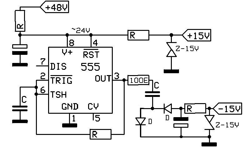

I'm a total noob in DIY electronics and I can't find ANY info, maybe due to wrong terminology knowledge. If it's answered in forum PLEASE direct me.
I'm going to build in-line mic preamp that needs 15-0-15v up to 18-0-18v and my goal is to get it using phantom power 48v from my audio interface. I know that I could get it by using 4x PP3 batteries (getting 0 from middle and +/- from sides), but that wouldn't be in-line preamp and I would have to hassle with batteries.

You can amuse yourself with this circuit with LT-Spice to adapt it depending on the current possebilities of the 48V supply and the need of your application.Seems I have to scrap that idea and use batteries 🙁

Ketje is correct if the zenerr and voltage divider are carefully chosen for the power draw on the +/- rails. Regulation won't be great for the neg. Rail but should be in the 10% range over a limited range.
I think if it were me I would add a 24V zener to the 24v rail. Just my thoughts so take them for what they cost you.

First of all, you should post here the schematic of the working preamp you intend to build, only it needs +/-15V (which you don´t have) instead of +48V (which you do).
IF you do not have such a schematic, just a vague idea about "ina217 is the best mic preamp" then you have a long way ahead and I suggest you build some tried and tested circuit.
IF you do, please post it here for analysis.
The point here is that very probably you do not *actually* need split supplies (we are handling Audio here, not minuscule DC voltages which is the other use for it) so it quite possibly can be converted to 30V single supply operation, which if properly done is equivalent to+/-15V
If you do not have a working mic preamp schematic, I´ll suggest a single supply application for INA217 , no big deal.
Only problem is that it has a relatively high current consumption, some 10/12 mA ; will your Phantom supply be able to sourde that?
Even if available voltage is less than 30 V at that current, no BIG deal either, since you will handle relatively low level signals it might work with as low as 15V DC supply ... single supply of course.

1. 48V 6800ohm gives max output power of 0.34W.
+/-12V * 12 mA=0.29W. So there is not too much margin, but possible. And INA... can work with lower voltage also.
