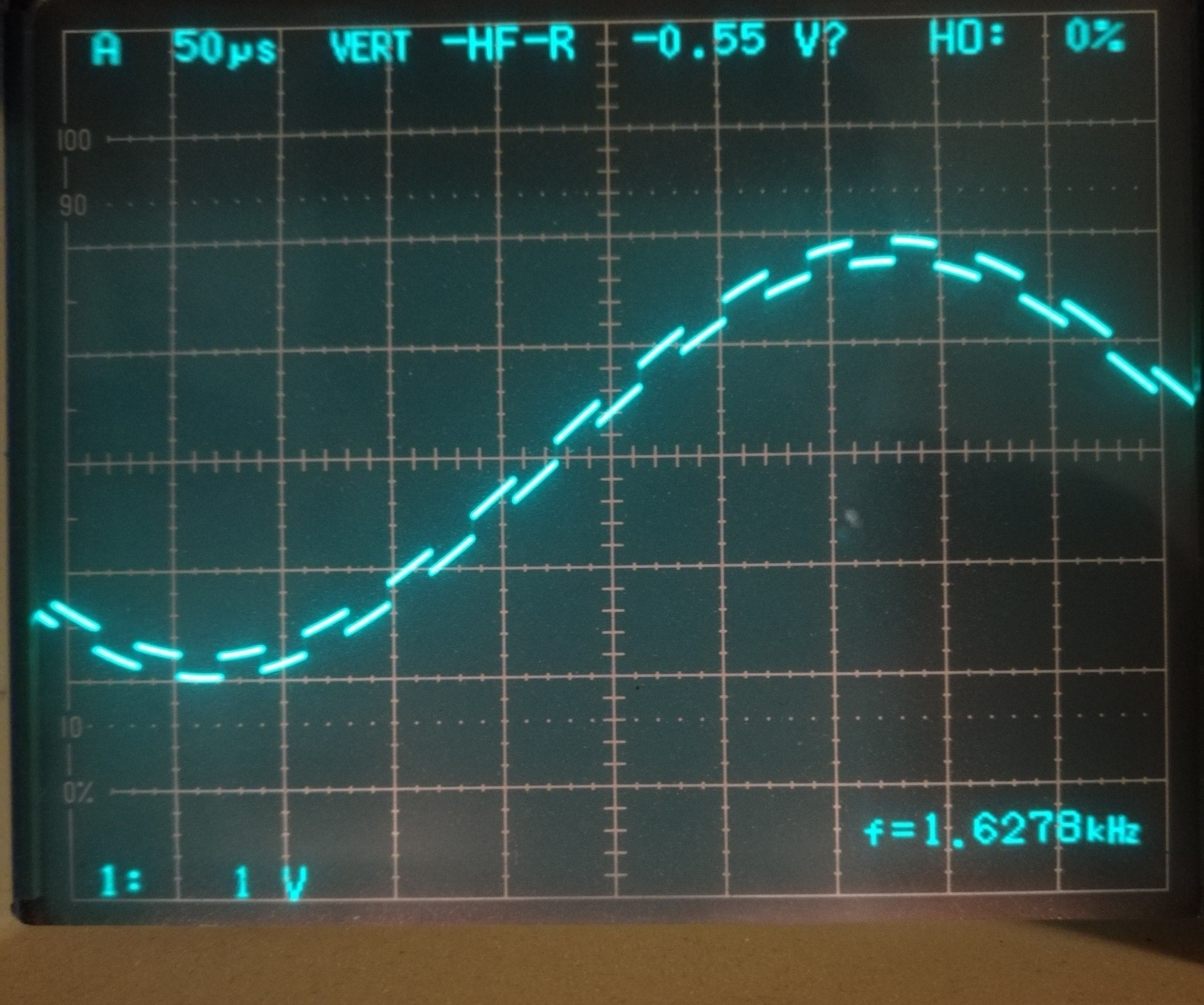

A "castlellated" sine wave could also be used to "tickle" an amp to help find her difficult spots. It is a small amplitude square wave riding on top of a large amplitude sine wave. castle-sine.jpg
The sine wave would drive the amp to just shy of clipping, and that's often where the stability margin is less ample.
This would be a more gentle way of poking and probing than with a full amplitude square wave, as it doesn't stress the amp as much.
In the attached waveform, the sine is at about 1.6KHz, the square is at 16x that frequency and they are phase locked, locked so that a clear and stable waveform can be obtained on an oscilloscope.
I documented this signal generator project in This Thread
Reactions: 3 users
