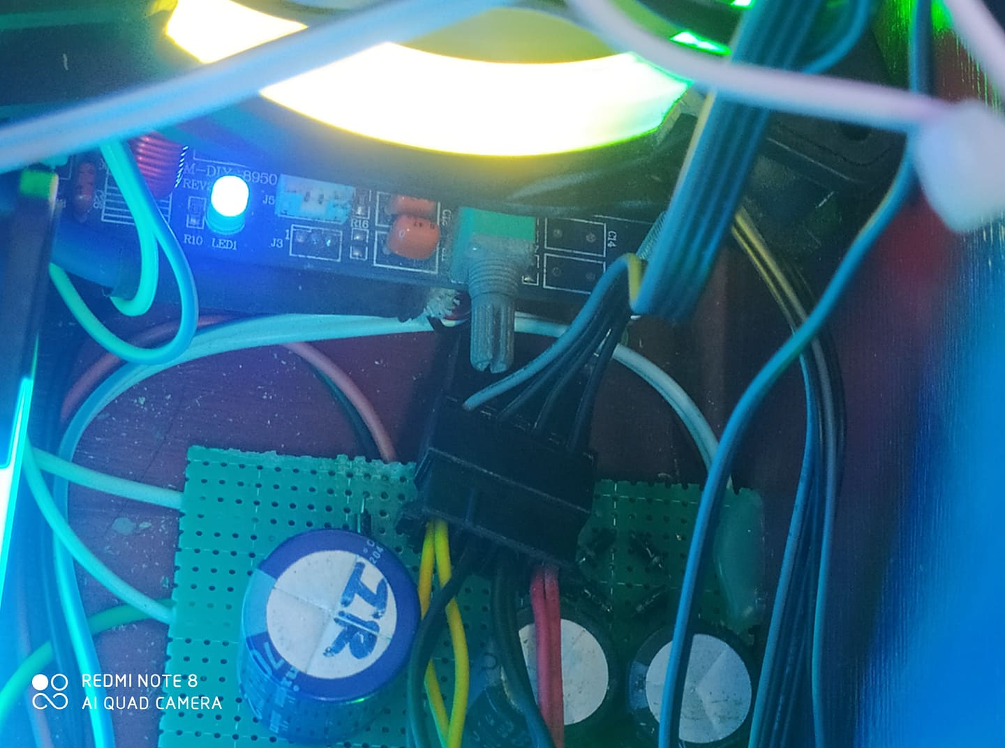

hi members ...
i need to build a gain module to compensate for the input sensitivity of my TDA8950 (dont know why it has low input sensitivity). But now the problem is after the low pass filter the signal will pass into an inverting op-amp section which has gain of around 8db and this has given me Hum problem when the subwoofer volume potentiometer is turned more than 60%.
Low pass filter is 2nd order LR and there is an inverting summing opamp stage that combine the Left and Right channels and this stage has unity(1) gain ... only the final stage operates with gain while inverting back the signal phase
thanks
hi
As you can see in the photo there is a pot that controls the gain of the TDA8950 module ... the sensitivity now is reduced because i turned it down ... if i increase this pot more than 50% i will start to run into problems of Hum ... so it is not the problem of the low gain of the TDA8950 but i've reduced it ..
Further checking yesterday i found that the hum is coming from the low pass filter module and not the amp module ... if i am using a balanced output from the low pass filter and balanced input for the TDA8950 will it cure the hum problem? thanks
