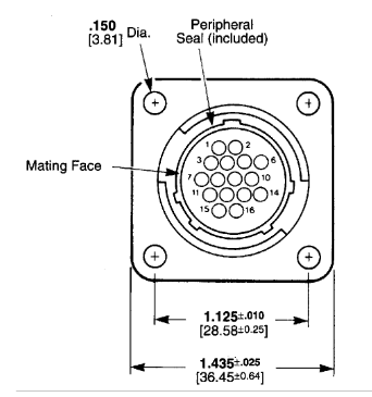

How the heck to I remove pins from this 14-pin power connector?
I am trying to follow the (attached) instructions to add RFI filter capacitors to the power leads connecting the power supply and preamp modules of my Audio Research SP10. The problem is, I cannot figure out how to remove pins from the connector! The illustration provided shows little "fins" that could be depressed by a pin tool, but I don't see any evidence of these fins in the pictures.

I do not think you cannot get the pins out without damaging them. You would need pins that fit that connector. Look for a diagram of the pins and you should see a retaining flap that compresses when sipped in and will expands when the pin is pushed far enough in.
There are pin extractor tools designed for that, otherwise it's impossible.
There are many kinds and sizes, but it has to be exactly the right size for the particular connector.
The mfr part number should be somewhere on the connector, possibly it's an Amphenol circular connector.
If you damage the pin, you will need a much more expensive mfr spec ratcheting crimp tool to install another pin.
An example, but this may not be the right one. You need the mfr connector part number to find the proper extractor.
https://www.amazon.com/JRready-Extractor-Removal-Connectors-Connector/dp/B0B6FMZMH4/ref=sr_1_5
Thank you, I figured I would need a tool similar to what @rayma linked. I was hoping it would be somewhat generic to the diameter of the pin, or that these sorts of connectors were following some sort of common standard. I can contact Audio Research and see if they can help…
In the mean time, is it possible to cut a notch in the insulation to “tap” the wire and connect the drain capacitors? Or would that be “bad form”?
I went on Mouser, browsed to “circular connectors”, then selected “DIN connectors”, then selected number of pins, and found many connectors similar to what’s on my unit, like this: https://www.mouser.com/ProductDetail/Amphenol-Tuchel/C091-31G014-200-5-U
That would seem to indicate that, at least what I found, is somewhat “standard”, since there is a category for “14 pin DIN connectors”. Shouldn’t I be able to buy a tool for “DIN connectors”, or something similar?
