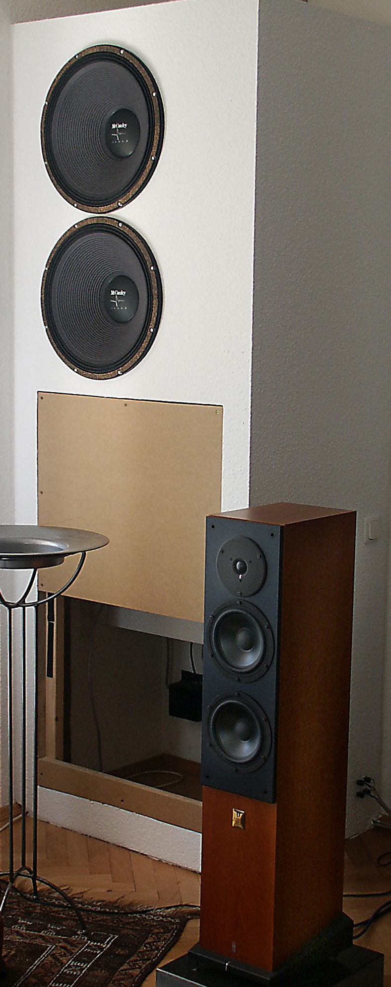

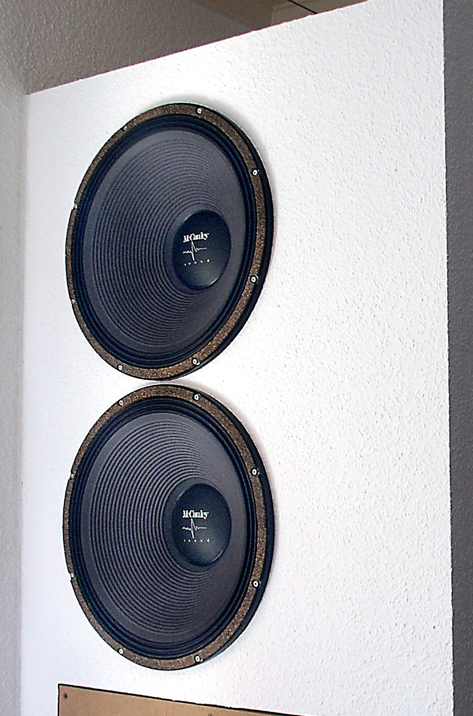

8 years ago I have realized some sub bass projects with the 6258 in the kind as to see on the attached pictures. Until now no problems were noted.
Here the data sheet of the transducer:
McCauley.com : Products: Components > 6258: Overview

The difference between home-audio (or domestic hifi or "household usage", as you say) and public address is present in such kind, that PA speaker driver components provides a strongly enhanced sonic quality in all respects than typical home audio loudspeakers resp. household stuff. Even by the tweeters (have a look to the "Glockenklang" 99db dome tweeter from the BassArt III based on RCF's TW116 and Stage Accompany's SA8535 so as various horn drivers from the German brand BMSpro).
Have a look to your pictures by post #1 about
http://www.diyaudio.com/forums/multi-way/147101-dipole-bass-oris-horn.html
Very very fine handcrafted workmanship in regard to the process policy.
But do you seriously believe, that this dipole bass sounds better than the bass system mentioned here by post #4 ??
I don't know other companies, where this is possible. I think a good solution.McCauley drivers are built like tanks. The basket and magnet assemblies are field separble. You can order spare baskets that include frame, diapragm and voice coil for field replacement in the event one gets smoked.
