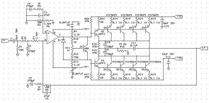

Values of C1 & C5 or way to low
after looking again .. those 1N4148 ? what or they doing there ?
and the imput filter, is that realy needed those inpedance/fase corrections ?

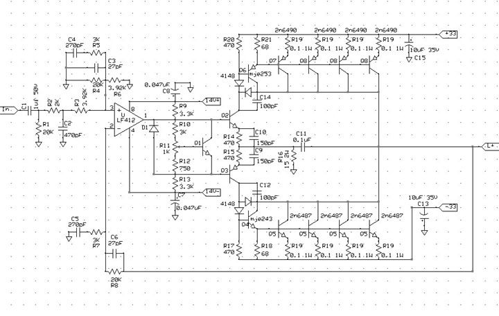

I don't know those power transistors, but that opamp (a dual) is not a very fast one. It will have phase shifts at higher audio freqs. That's also why you see those phase correction networks on the inputs and feedback leg. I think this amp is robust, rugged, almost undestructible, but may have more hf THD than necessary using modern components. And no, you CANNOT plug in another (fast) opamp and hope it will be OK. And yes, as said above, the C1 is too small for good lf response. C5? That's for phase correction, I asssume it is correct, but there's no quick and easy way to say it is or isn't.
Those 1N4148's are there to keep the output transistors from saturating when driven to max output voltage. Seeing that old technique used here, I get suspicious that they are quite slow (low Ft).

Yep I Based this design on a circa '87 amp design. I have already gone through the design and replaced some obsolete components with ones that are still in production. What kind of output transistors would be a suitable, modern replacement?

Sorry, I omitted them. On the original schematic they Q1 was listed as a06, Q2 as 6716, and Q3 as 6728.
Last time I saw this Baker Clamp technique in audio was on the old Apt 1 Power Amp with some old Motorola output devices - kind of slow but rugged (for their time). I'm thinking you may want to use some other diodes here; I'm remembering FDH400 or something like that maybe for capacitance and leakage reasons?

This is a competent design, but perhaps not the best for audio. It would have a high measured IIM distortion. Of course, the 712 can be updated to a newer part.
If you delete the MJE driver transistors and the Baker clamp it looks just like a Rockford Fosgate Punch 150, it only had two pair of outputs per channel.

"Last time I saw this Baker Clamp technique in audio was on the old Apt 1 Power Amp with some old Motorola output devices - kind of slow but rugged (for their time). "
The APT 1 used two pair MJ15022/23 outputs. Later versions were rated at 250W/2R, that's 16A collector current, 8A per pair. The gain-bandwidth product of these was 2.5Mhz at 8A.
The ever popular 2SA1302 is about the same, and the 2SC3281 is well below 2Mhz at this kind of current.
