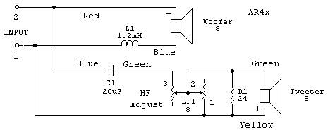

I’m curious about the sound when I swapped speaker cable, between positive and negative, at speaker terminal. At first, I believed the sound would be the same whatever wired conventionally or reversed polarity. After trial, however, I can hear the different of sound! Could anyone please confirm me that the wiring polarity, at terminal, is matter? Also, I used to see some speaker’s schematics, not sure if they were vintage AR speakers, were put the passive network components on negative line. It would be very helpful if anyone has a microphone setup for doing a frequency swap, please assist to measure the response and phase for both cases. Thanks in advance.
The designations 'negative' and 'positive' are a misnomer as the audio input to the speaker terminals is an alternating voltage which is constantly changing in polarity.Also, I used to see some speaker’s schematics, not sure if they were vintage AR speakers, were put the passive network components on negative line.
Note that, on the attached AR4x crossover circuit, the legends '1' and '2' are more approprately used to designate the input 'lines'.
It makes no difference whether the passive components are in the '1' line or in the '2 line'.
For example, the inductor in series with the bass driver could equally be placed in front of the bass driver as behind i.e. in the '2' line instead of the '1' line.
An added complication of the attached crossover is that the tweeter is connected in reverse phase compared to the bass driver i.e. the + terminal of the tweeter is connected in the '1' line while the + terminal of the bass driver is connected in the '2' line.
(You should be aware that the + terminal on a driver indicates that its cone or dome will move in the forward direction when a positive going voltage is applied to that terminal.)
Confused? I wouldn't blame you if you were!

Reversing the polarity of all the drivers is EXACTLY the same as reversing the connections at the input terminal...no difference at all, so if you heard a difference, it originated between your ears, not outside of them.
