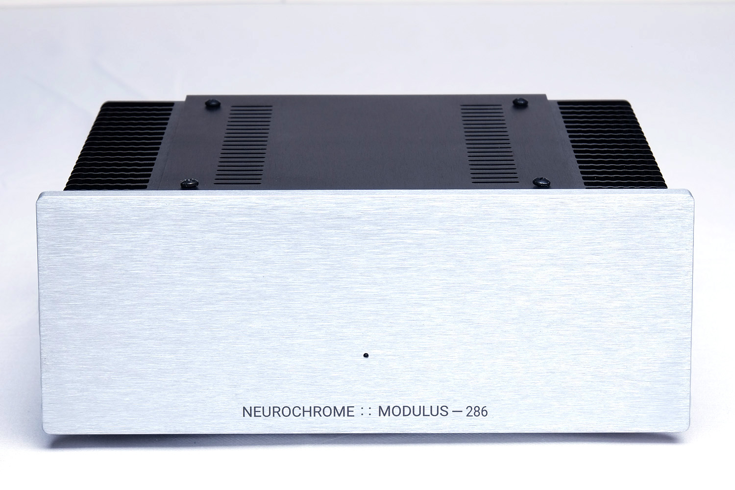

I like putting handsome indicator LEDs like the one below on the front panel of stuff I build.
But I also like those lovely 10mm thick brushed aluminum front panels from Modushop.
Problem is: I’ve not yet found an indicator LED with threads long enough to reach all the way through the 10mm panel. On my last amp I drilled out a massive hole to fit the nut into. It’s still very hard to fasten & unfasten the LED.
How do you folks attach panel-mount LEDs to thick front panels? Or do you? Hs anyone found a panel-mount with 12mm thread? Snap-ins that work? What about T-nuts which can be turned with a wrench?
Any clever ideas?

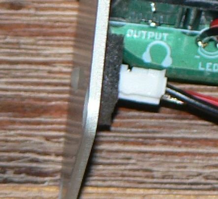

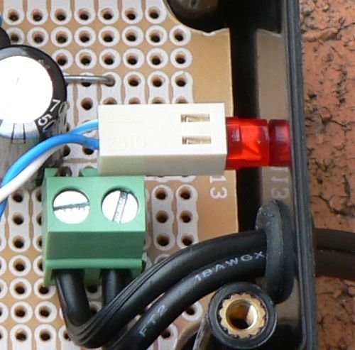

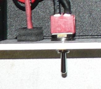

I did a similar thing but used an LED without a flange on thicker front panels and with a flange on thinner ones. Held in place by self adhesive foam on the back side with a punched hole which grips the LED or wires and BluTack also works. Not good examples but gives an idea and later build used connectors instead of soldering.

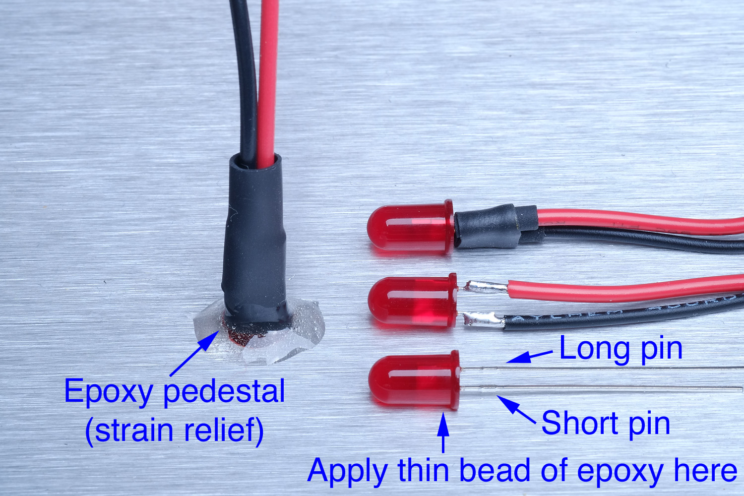

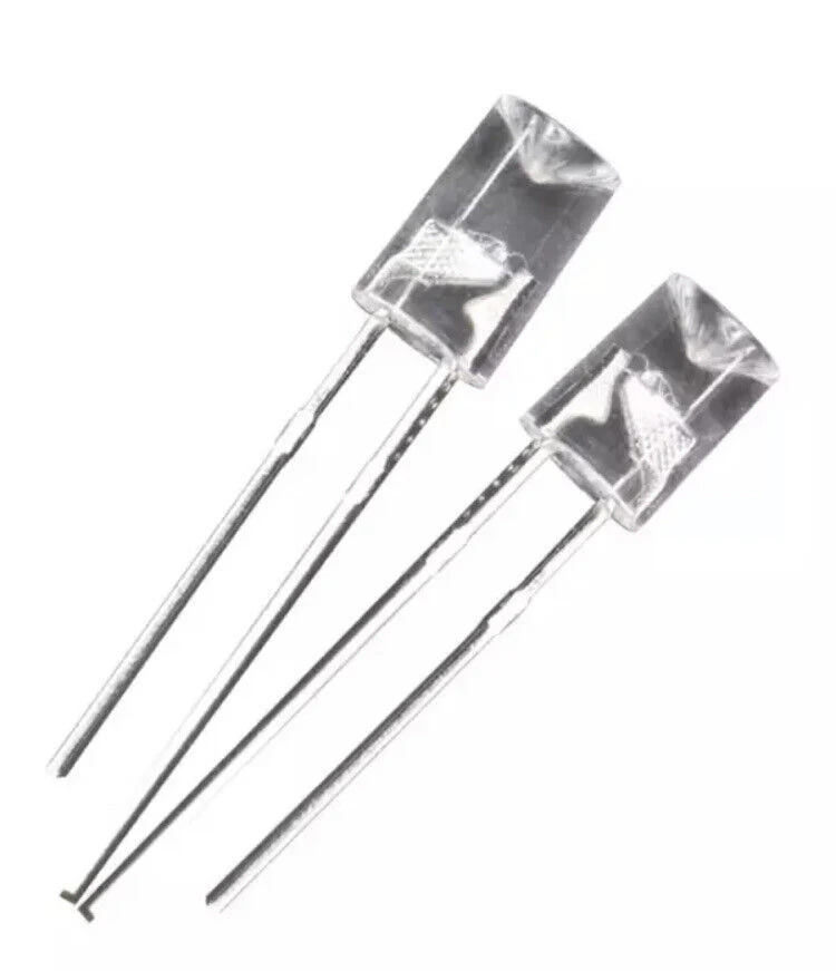

I've used flat top LEDs in the past like these:
I drill the panel out to size, tape the outside face with Mylar tape, then epoxy the LED into place from behind, flush with the outer face.
When the epoxy dries, I remove the release tape and it's good to go.
If the panel isn't finished already, I do a 'brushed aluminium & clear coat' - including the LED face - which can give a very good hidden look when turned off.

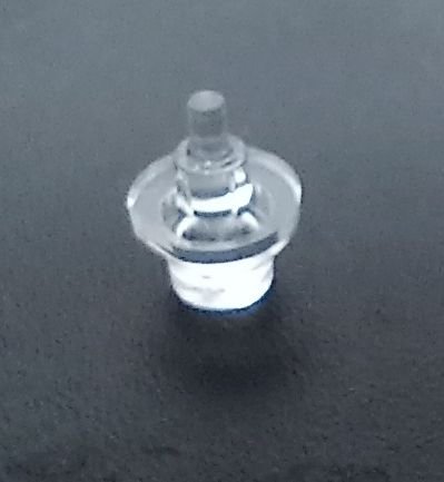

Like this one (first pic) and I use them on thin face plates after trimming the 2mm end. A 2mm hole gives a snug fit so doesn't require other fixing.
I've seen these (second pic) on commercial gear and only transmits the light from a LED behind the front panel usually on a control PCB. Some extend some distance with bends to reach the LED.

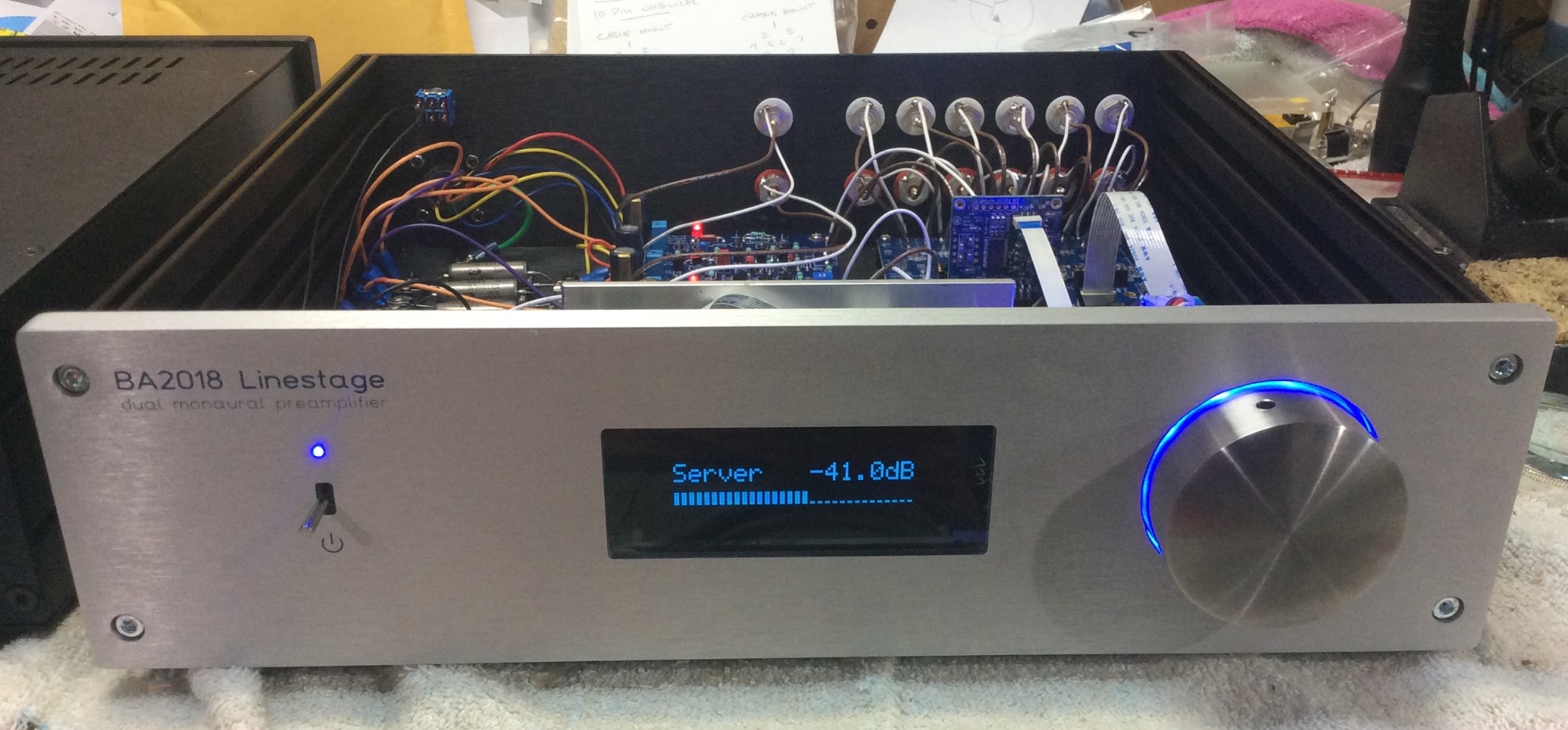

My process is similar to tomchr's. Drill a 3mm (or 1/8") hole from the rear face of the front panel in, stopping 2-3mm short of the front face. Drill a corresponding 1.5mm hole from the front face. A 3mm LED will fit snugly in the rear hole, kept in place with clear silicone glue. Simple, works great and the hole on the front panel is large enough to serve as an indicator but not so large as to be glaring.
I use this method to provide both source selection as well as to illuminate knobs from the rear.
