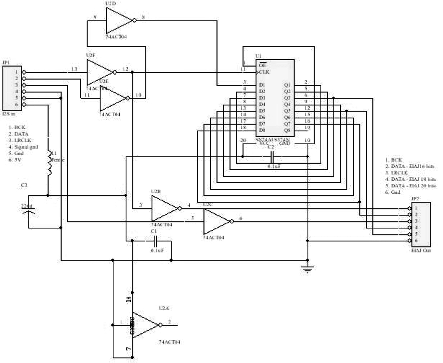

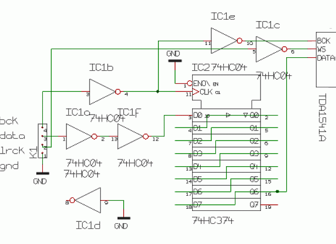

How about using one of those 2 circuit to convert 64 bit frame to 48 bit frame (I2S to Sony ( aka EIAJ )) ?

But neither of those circuits do that. The main clue is the BCK line, on each of the above circuits it is only inverted twice, coming out more or less the same as it went in.
Frame length and BCK frequency are analogous. If you have data with a sample frequency (fs) of 44.1 kHz (which you do), and a BCK frequency of 64 x fs (which a CS8414, DIR9001, DIR1701 and DIR1703 all output) then the BCK will cycle 64 times per sample, clocking out 64 bits, hence a 64 bit frame.
So, for a 48 bit frame you'd want BCK to have a frequency of 48 x fs, a different frequency. If the BCK frequency hasn't changed, neither has the frame length.
That said, it is still possible to connect a S/P DIF receiver to this CXD1244. If you used a DIR9001, setting it to output 16 bit right justified data and a 384 x fs recovered master clock, deserialised the data it output, latched it, and reserialised it using a clock divided from the recovered master clock, you'd be away. This is something you'd want to use programmable logic for, and something with a fair few macrocells as well. This wouldn't be a trivial undertaking.

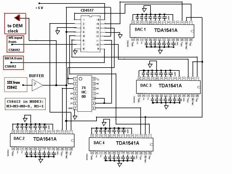

There is also a better solution, it's a kind of shift-register 4X analog oversampling, here is the schematic, what do you think of it ?

Looks quite cool, though you'd want to have a good supply of TDA1541As!
Sound wise, it's too hard to say whether something will sound any good just from looking at a schematic. The only thing I would watch is the CD4517, they're getting hard to find due to the prevalence of programmable logic, and it'll be running at its limit, so you'll need to get a good brand one.

I've try few kind of dac, but I still hesitate to try this analog oversampling, but with so much chip and the CD4517 it may have lot of jitter ?
Have you seen any errors in that 4X analog oversampling schematic ?

Mucking around with glue logic can be unpredictable. It may sound better than four TDA1541As in parallel, or it may not work at all, and I can't tell which from one very incomplete schematic.
I especially steer clear of those designs since I don't like to prototype. You've got to do a lot of prototyping o make stuff like that work well.
