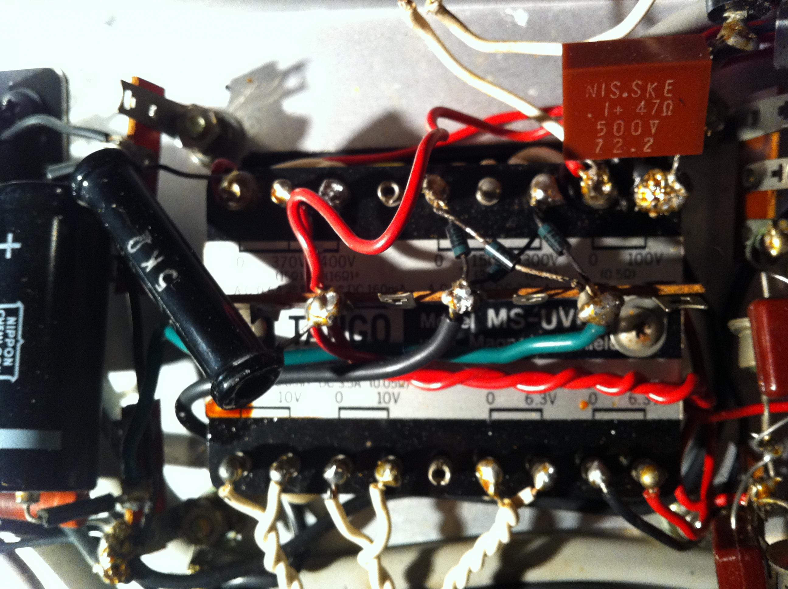

If I understand correctly you'll need a xformer with a 20V secondary. Primary and secondary winding are then wired in series (Fig4) and used as a voltage divider.
Thank you guys for the information.
It seems like the best way to reduce the voltage is by using a buck transformer.
Do I need to buy a separate transformer or do I use the secondary voltage of the Tango power transformer that is in my amplifier?
I see that I would need a separate transformer.
My main voltage is 124V. Seems like I would need a transformer with 24V secondary. What about the primary voltage?
Could you guys tell me where I can get a good transformer?
Current transformers intended for the U.S. market generally have 120V primaries, no real choice here. Anything in the 20V - 24V range is going to work fine.. You haven't mentioned what the current consumption of this amplifier is on 100V - that is a part of the puzzle that is missing, and I usually like to chose a transformer that is rated at twice the maximum current I will use it at for this sort of application.
Antek makes toroids that are pretty good for this application for very reasonable money.. Digikey, Mouser and Allied Electronics also sell a variety of transformers that would be well suited for this application.
I haven't measure the current of this amp. I need to replace the fuse on my meter. The amp is an 845 SE so I suspect that it draws about 300w or 3 amps.
I will measure the current when I get the fuse. Assume that it draws 3 amps, what is the current of the transformer I should get?
Apex Jr. has a 160va toriod with dual 24v secondaries. If you wire the
secondarys in parrallel that should be good for 24v at 6.6A. By the way
