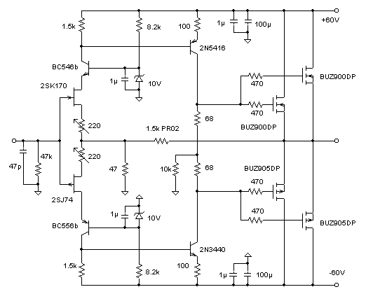

The JOB amplifer is probably some variation of a current feedback amplifier. For more on this topology check
http://perso.wanadoo.fr/jm.plantefeve/
An example of a current feedback amplifier
