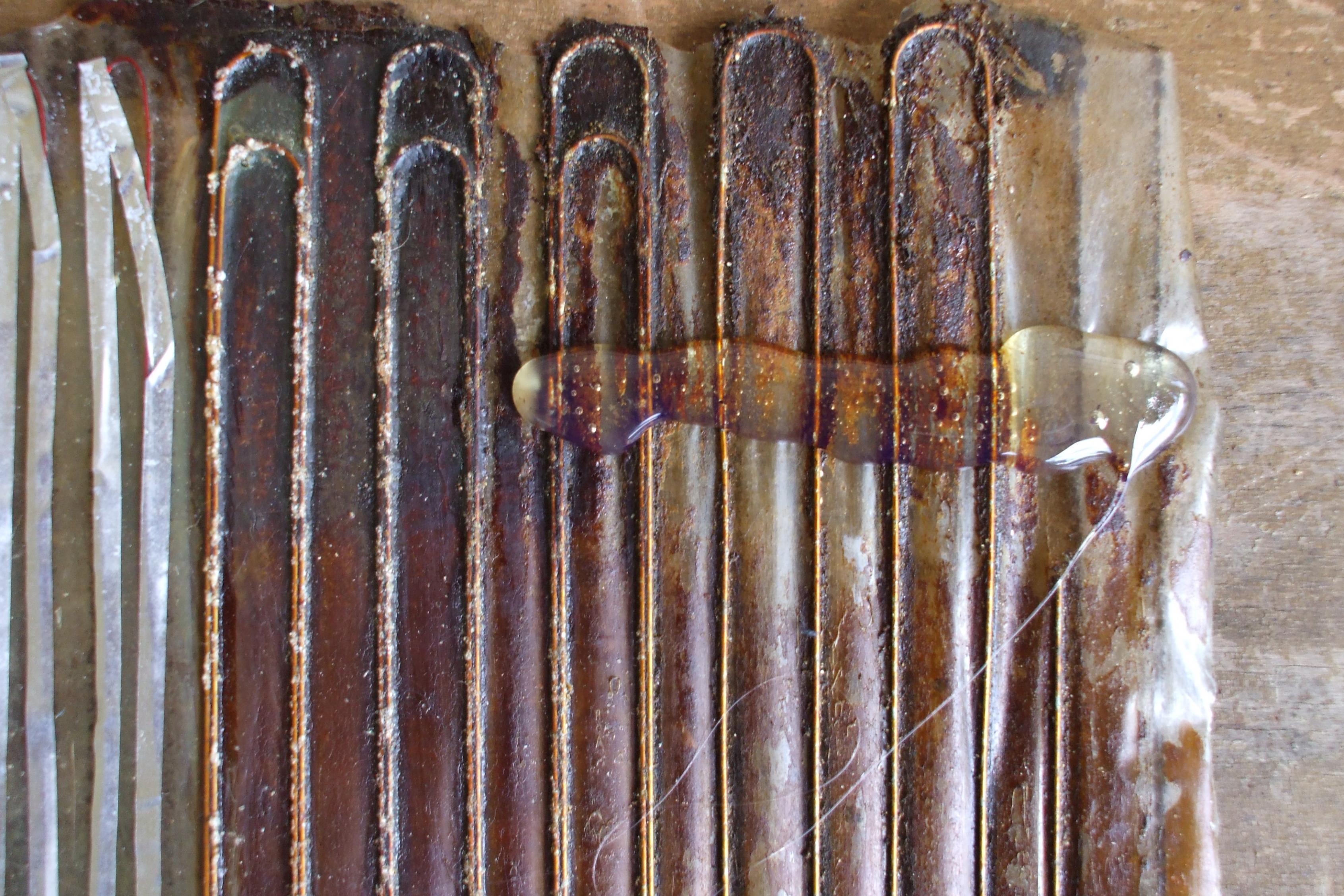

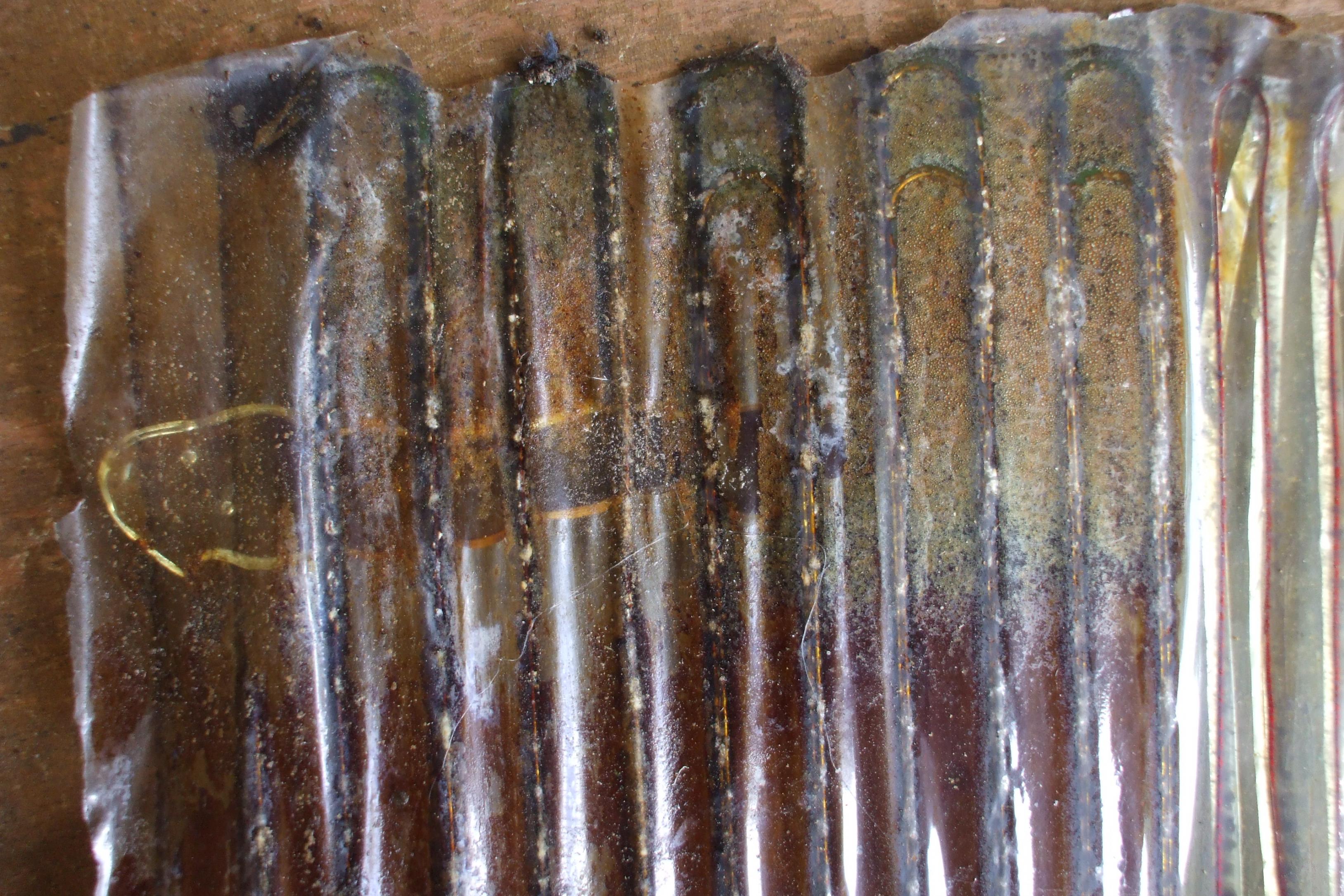

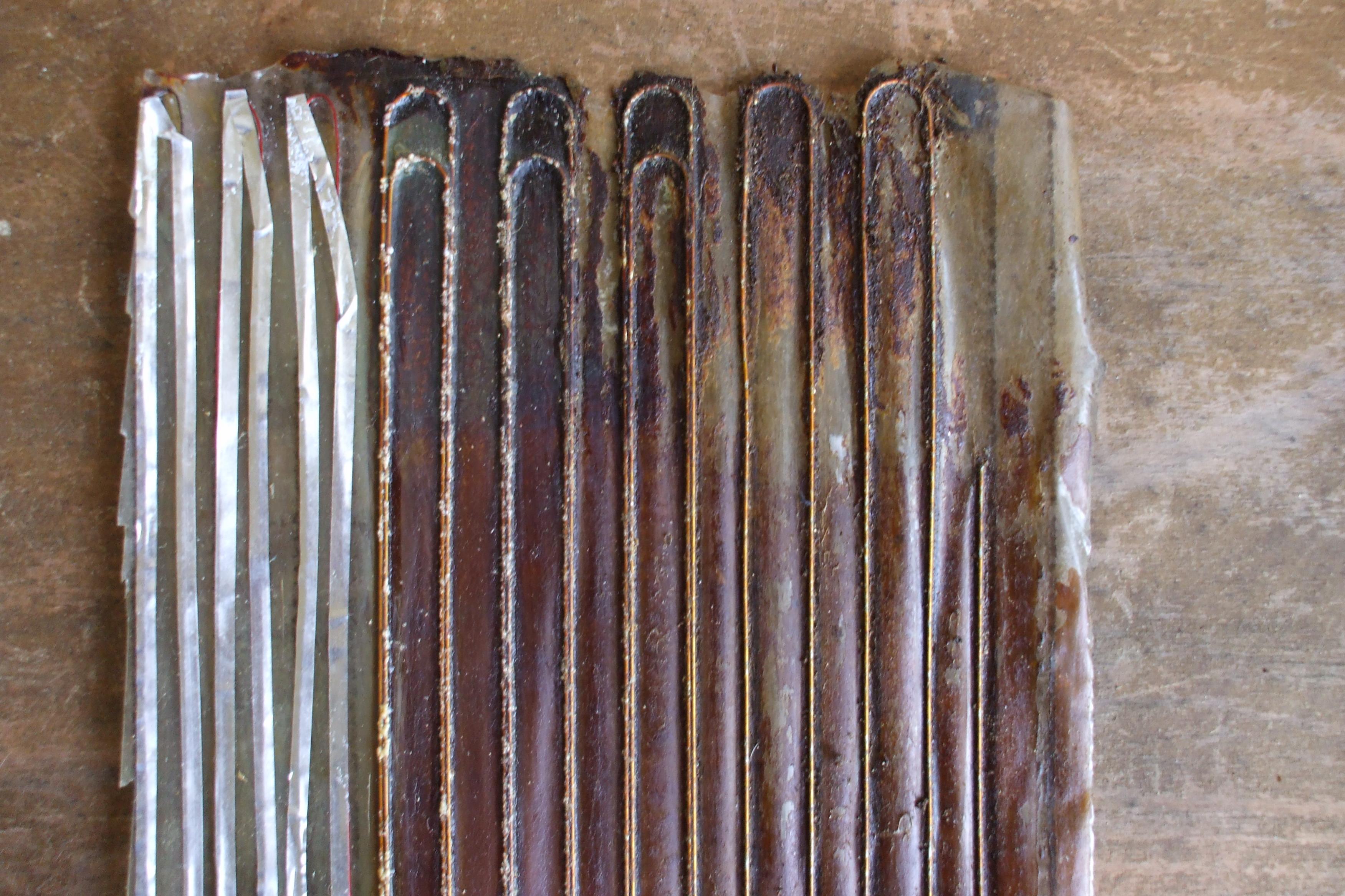

I am Saying DO THIS AT YOUR OWN RISK! IT is What It Is..
This is 30year old Magnepan Stock Mylar!...Off A pr Of Smg.....
I put the QR foil you see... as a test 4 years Ago....Foil Give Less output than wire!
I have KNOW WAY OF NOing what magnepans MYlar is to day!
Pic 1....Old Mylar...
Pic 2.....HotGlue 40 watt gunn...on 5min....
Pic 3 Back of Mylar..
...You Own your own from here...
Looks to me like it did not pull much...if i were doing this...AN I AM NOT!
It well add wate to the Mylar...but it at the ends SO...Big So...
I would not go strat from the glue gunn..
I would put the glue on something an then put on the wire....there Maggys...
Remimber.....................$6-800. +SHIPING FOR RE-dO,s From Magnepan at lest...
Good luck
