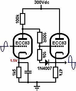

I have two DC coupled cathode followers; one with 100k and the other with 47k off the cathode.
Both resistors are hot to the touch even when idling. Measurements show they are drawing less than half a watt. I changed one of them to 2W but it is too hot as well.

How did you measure the dissipation? Not clear to me which resistors you talk about; when you say 'off the cathode' do you mean the cathode resistor or some load resistor?
I see in one schematic a 100k cathode resistor with 212V across it - that would be less than 0.5W.
A 47k with 350V across it would dissipate some 2.6W and that one would definitely be hot.
What is the total current the amp draws from the supply? Did you measure that?

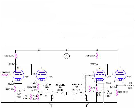

In the upper schematic, V3a output seems heavily attenuated and that could account for the high noise. But the circuit doesn't seem to be right - why the high attenuation?

C = 340
PS DC Amps = 8mA Two other 12AX7 dual triode gain stages are also being powered.

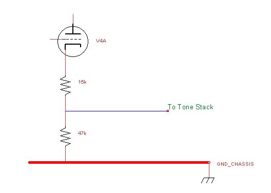

V across R25 100k on V3A is 167V = 0.28W That one is not noticably warm with 2W metal film resistor.
V across the 15k on V4B is 43v = 0.12W Also not warm with 3W resistor.
V across the 47k on V4B is 133V = 0.37W Too hot with the same 2W metal film resistor as R25.
The attenuation on V3 output is to bring the output to pro equipment level which I understand is about 2V. Tapping further down, or reducing the 2.2k to ~ 200R will bring it closer to instrument level (~100mV) at high gains and medium inputs.

Maybe your idea of 'too hot' is too restrictive. If you can barely keep your finger on it, that will be about 45 degrees Celcius which is not hot at all for a resistor.
Are you sure the resistor value is correct? It's easy to make a mistake with one of the color rings and be a factor of 10 off.
Still puzzled about that 1st stage. The attenuation on V3a appears some 45 times, that's a waste and may be the cause of the noise.
You should chuck the gain stage and use just the cathode follower, much better!
Edit: taking away C11 on V3b will give better performance and lower gain, that will help already a lot!

It says 47k and measures the same. I looked up the code in Vishay Dale and it says it's 1W.
Ok so it's not 2W, but it's still more than twice the rating necessary, yet too hot.
