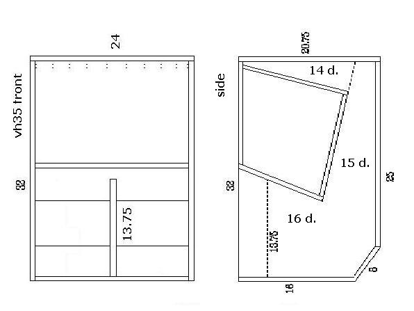

Thanks for the reply. SPL is prefered over extension becuase this is for a mobile DJ.
One box would probably be better than two, but I could talk to him and see how he'd feel about two.
Thanks for the plans, do you/anyone have a suggestion for around 300-400 in parts (excluding wood, screws, etc, and even x-over possibly).

This would probably be the smallest design that meets your stated requirements and you could build 2 with the budget listed. Look around at the other designs on the site too.
http://www.billfitzmaurice.com/plan..._id/5?osCsid=f45317ea41ad977863bf98268a6aba0f
Consider a TAP...
William's 60 Hz TAP Horn will give you flat response to 50 Hz with a 10 inch driver in a very compact box that is as simple as it gets to build. With room gain and a little EQ you should be able to squeeze a little more bass extension and be off to the races. Bonus it runs flat up to 260 Hz.
http://diy.cowanaudio.com/index.html

"The Tuba 36 looks promising though..."
Here is what one of the BF Tuba's actually does:
The cyclical peaks and dips are from too small of a mouth. If you used eight of so in a stack it would smooth out quite a bit.
Here is what four Eminence can do in a tapped horn design:
Each box ends up about 36x36x24W
