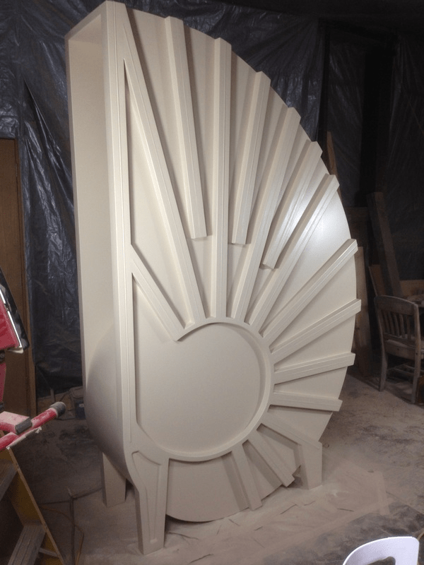

Spiral Horn should give you a idea
what it takes to get bass.

A back loaded horn make about 3 octaves - thats math (more or less). So either 30->240 or 1,88<-15k.
Thats it really - it is not possible - if you want any of the desireble horn characteristics. Of course you can force it but it won't be good. It has noting to do with the driver, this limit is solely in the horn (the acoustical impedance transformer)
