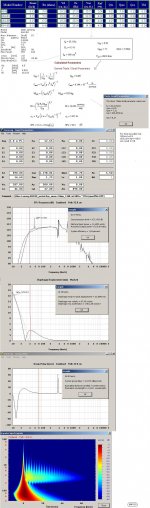

Heres my question/s How do I calculate the proper bass alignment and box volume for my Altec Lansing 604 Duplex speakers?

You've already given the answer in your preamble - find Qts, VAS and Fs. Then use modelling software. There are published alignments that are good for starting points, but if you read up on what group delay is you should be able to come up with something reasonable yourself. Just keep one eye on the frequency response curve and the other on the excursion curve and thermal power curve.
