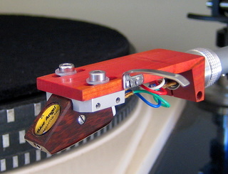

Hello Guys
I have a couple of sme-type h/shells laying around - some of which are so dated or plain ugly they don't really get used. I also have some genuine sme 'shells but those I will keep for errr...historical reasons.
I tried my hand at milling a hardwood headshell and this is the result, made from a small piece of Pink Ivory.
The shell was milled in one piece and features azimuth adjustment with a 1.5mm stainless steel capscrew and nut.
The shell itself was not too difficult to make but it's a real pain to separate the connector from the old headshell.
The weight is just under 7g.
Regards
bulgin

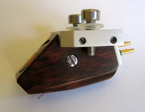

Excellent craftsmanship Bulgin! I cobble up stuff also (see photos) but not as well as you. I want to grow up like Bulgin!
Ebony headshell
Denon 103 ebony casing
Brass baseplate for Denon 103

Nice work!
Have either of you considered using "stabilized" wood? Stabilized wood is wood that's been impregnated with acrylic resins and then cured. It not only gives the wood much greater mechanical stability, but can also be finished to a high polish without having to apply a traditional finish.

I acknowledge seeing some incredible woodwork (including an unforgettable Garrard plinth) made in the Philippines. The pink ivory h/shell was just a 'one off' and the design is not original. I had an old aluminium headshell on my workbench which I think came off some Marantz equipment. I liked its simplicity and decided to try copying it in wood with a few changes. It is slightly narrower than the original and the coupling for sme is clamped to allow for azimuth adjustment. The compound angle(?) milled at the back underneath makes it very strong and I see Mandym had the same idea.

I think the sound is more natural and spacious and the usual clicks and pops have almost disappeared.

Btw, making headshells like Mandym does, ain't easy as great precision is required to do a decent job. And then there's also the unpredictability of working with wood. Often, at the very last milling operation, a crack, flaw or weakness becomes evident...

Pjotr said:Hi bulgin and mandym,
Very nice work. But I would omit that metal resonating lift thingy![]()
Next time mill it straight out of the one piece of wood if you can’t do without
Or drill a small hole and insert a thin wooden dovel of contrasting wood.
Hi Pjotr,
I am not too sure that the finger lift's resonance is significant. It is light and very stiff, it's resonance may be beyond the audible band. I really would like to know if I am mistaken so that I can make adjustments.
I know one tonearm manufacturer eschews the finger lift apparently for the reason you give, but I am not yet convinced that there is real gain in it.
Mandym
Mandym
