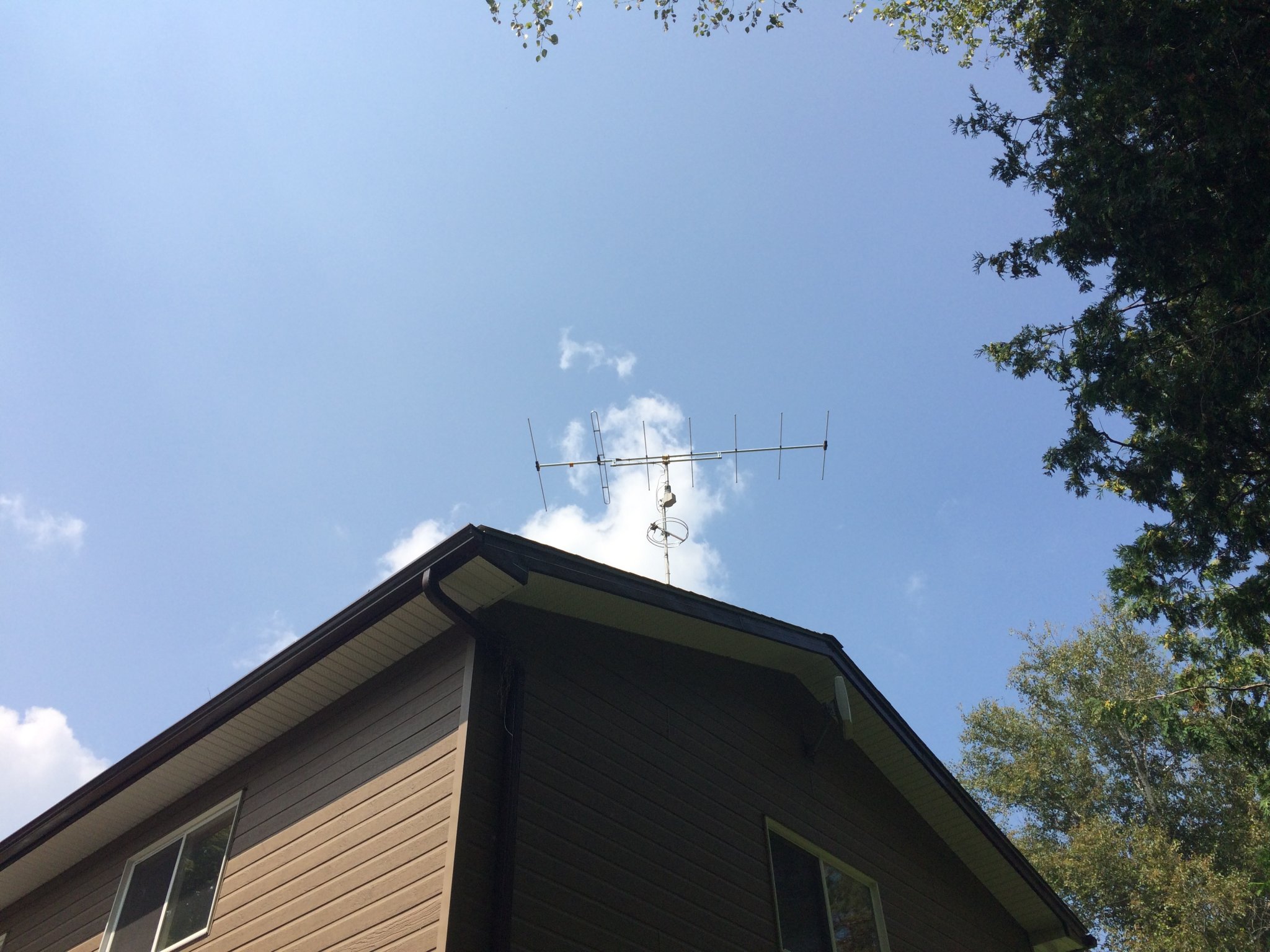

Myself and a neighbour installed imitation wood siding from LP on my 2 story garage/loft a few years ago. I liked it more than hardie board. We used typar house wrap over 1/2” exterior ply, did not want to cheap out using OSB which most new builds use because it’s much cheaper.
We also did the window trim, I used silicone to seal the windows before and after the trim. Glad I did it before Covid hit as cost must have gone up substantially

The only pic I have on my phone showing some of the siding we installed and other stuff like the metal work, fm antennas, Bell internet modem and the robins nest on the down spout 🙂
I did not know what bursitis was until it happened to me. Up and down the ladders many times, standing on them is hard on an old man. It has cleared up but it’s still there.
Enjoy
