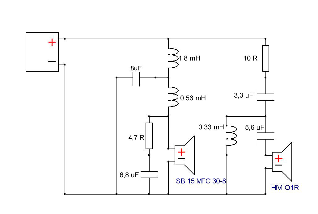

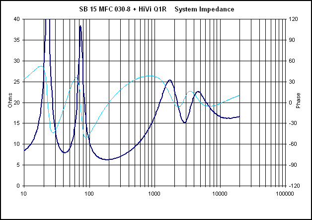

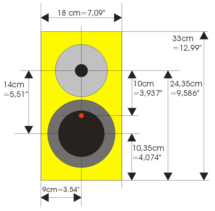

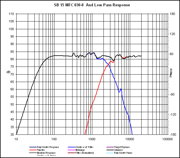

I can't recommend building a speaker based only on manufacturer's
plots, so this serves only as an exercise. Acoustic offset is guessed
to be 20 mm, and the driver phase is far from being optimal. The red
dot is mic's position. Baffle step is acounted for as the drawing suggests
with 0,25" rounded edges. Driver slopes are true acoustic LR4, in this
theoretical case, 10 litres box.

Thnx a lot, may i ask you what program you have used?
At first i wanted the make the cabinet really narrow, nearly as wide as the woofer its self, due the reflections.
But i was reading on the page of Troels Graven and i noticed the bit that the edges need to be round, so i went from 15 to 18cm and 30/32cm tall.
The faceplate of the tweeter is 12 cm so thats quite big and will get me in trouble with the lay out if i dont go around 30/32 cm of height
And may i ask why you did used a series filter?
Im kinda new in the XO world and i want to know how it works so i dont have to bother other people anymore with my nonsense 😛
I always thought a parallel filter was easier and more precise due the fact you split up the signals... once again im new in to this and this is just my own theoritical brain fart.
thanks again for your effort.
Greets Marcel.

The filter is a straight parallel type, it's plotted differently than usual.
Read through older threads and you'll find all the information you need.
