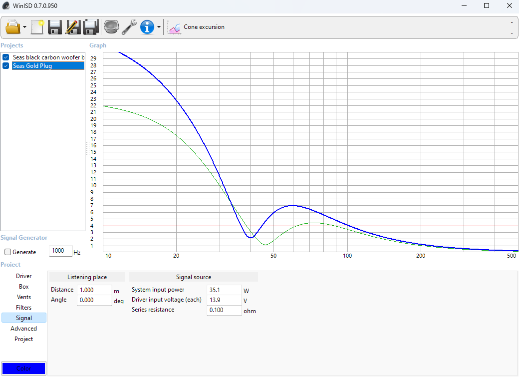

Hey guys, I am running into an excursion problem when modelling a ported 650 cubic inch enclosure with the Seas Excel W15CY-001 5.5" Magnesium cone woofer.
I seem to hit Xmax at only 12 Watts. Is this normal or am I doing something wrong? I downloaded the data from Loudspeaker Database and imported to WinISD without any modification. I use the Butterworth preset.
Here is a graph at 35 Watts. I have not added any filters.

Beyond its Xmax rating, no driver can handle much power down below Fs/Qts' or ~105.56 Hz per the factory specs, just as WinISD predicts.
(Qts'): (Qts) + any added series resistance (Rs)

Ah so if I understand correctly, I need to add a highpass filter above qts?Beyond its Xmax rating, no driver can handle much power down below Fs/Qts'.
Qts is the driver's quality/damping factor and where you high pass depends on how much power you want to feed the driver higher up in its mass controlled BW (Fhm = 2*Fs/Qts' = > ~236 Hz).
