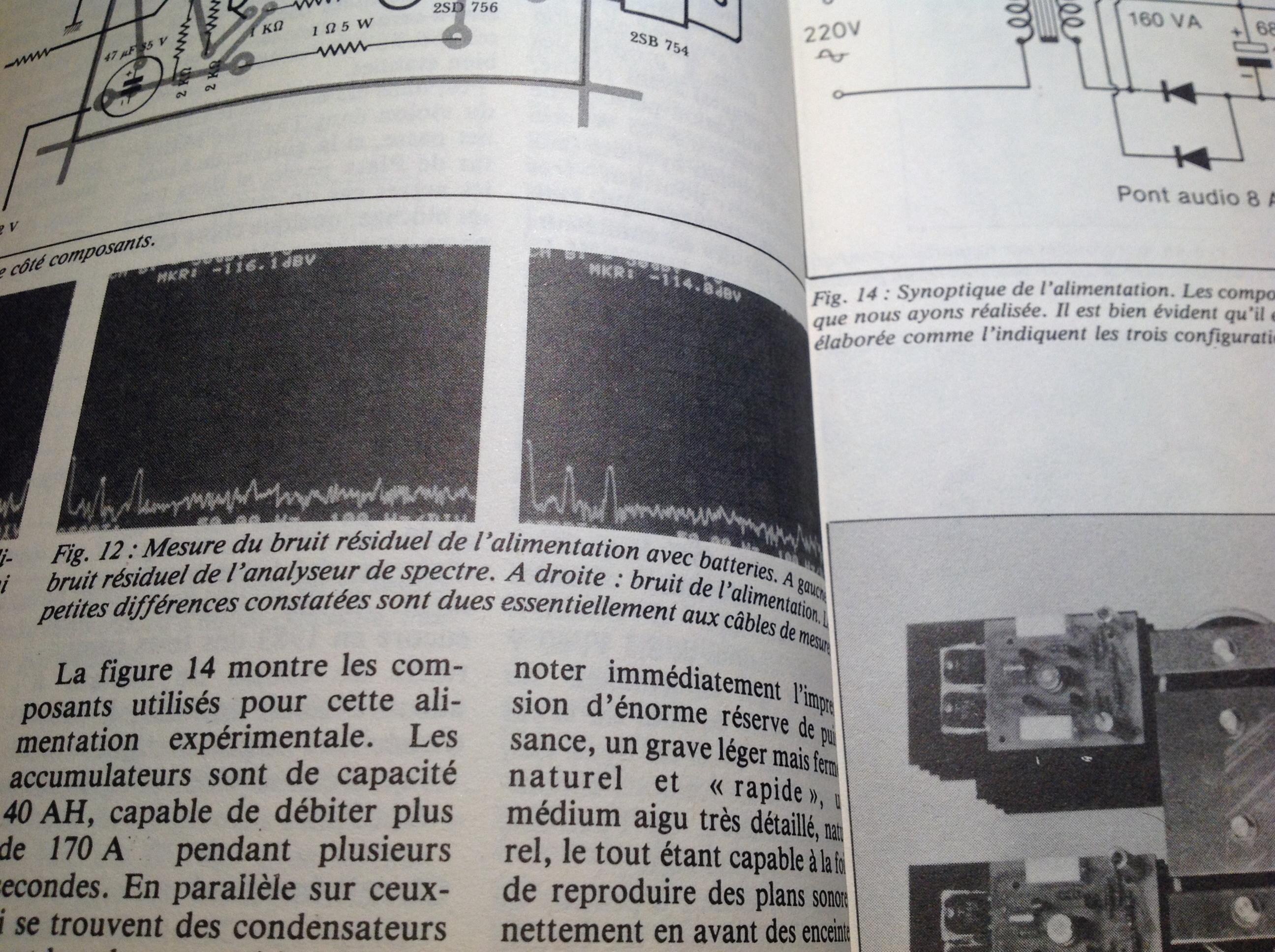

My idea is to build the power supply accordingly to the picture below
Now my question is, the batteries are parallelled with amongst others, a supercap 0.47 F but what voltage should be choosen??
I presume I should at least have 12 V (since I am parallelling 12 V batteries) but that is getting tricky, have problem finding those values.
Any help out there??

Ahoy TIC37
Very interesting project.
This is original psu schematic for " Le Monstre " from L'Audiophile by J Hiraga.
On last photo noise figure of classic psu are much higher
if compare with noise level of battery psu 😀 Have fun !

3 supercapa's rated 5V connected in series = 15 V is OK
Try find 10 V so you need two connected in series = 20 V is the best solution
6 or 4 scaps for this amplifier
