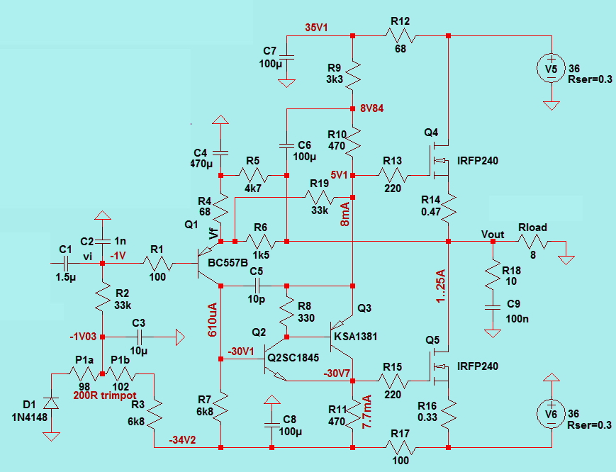

Then i found the old simulation..and i could make it a little it better....made it today..some improvement...but efficiency still 20 percent and this all i could have.
Reducing voltage and current, to reduce dissipation, then i have lost power...naturally..now 8 watts is 0.1 percent distortion (THD) and 5.5 watts with low distortion of 0.045%... you know.... even higher distortion i had in the first amplifier, the Dx Amplifier...seems to me to go backwards alike a crab... mine amplifiers, now a days are 0.002%... some are 0.00167%.... i will not tollerate to listen all these harmonics...you see... no crossover distortion to clean the sound that will be plenty of annoying harmonics...you know..looks bad business...bad solution...then i always give up to make it once again.... will be waste of time.... alike all other Class A i have build.
To make it again...well...this does not mean progress .. this is a return to a kind of old .. performance far outweighed nowadays.
To zener diode hatters.... this one will not produce noise because the huge electrolitic will "eat" the noise generated.
Performance of this one is alike the toy i have made a couple of days ago... a 555 chip together a BD139 and a BD140... a class D unit...power consumption ridiculous.... 1.2 watt to produce 1 watt of audio..and distortion is almost the same of the Hiraga...you see..how crazy this stuff is?
This Hiraga i have tweaked is 45 watts of consumption to generate 5.5 watts at 0.045% or 8 watts RMS at 0.1 percent...you see the difference...the ratio of consumption versus effective audio.
You see the trimpot, it is there to adjust the off set..but if you increase pot value, then you current will also increase...if you remove the 560 parallel resistor your stand by current will jump from 868 mA to each rail to almost 1.7A per rail.... heat will be huge...and power will jump to 19 watts RMS if i can remember....but imagine...each rail with 46 watts of heat...transistor gonna melt..you will need 2 pairs....and if you increase the voltage the hell gonna be even worse!

This "new" design of yours is rather similar to a commercial amplifier that we don't have permission to publish ?
Which schemat is that, Gareth? Which designer? Looks a bit like the JLH, actually, or even something like Pass' version?
Hugh
Hugh
any product's schematic, circuit topology is fair game for discussion - as long as you redraw it, don't make a exact optical/mechanical/digital copy you aren't violating copyright - copyright only protects the exact image - not the ideas, transistor types, parts values...
only active patents can restrict your use of circuit topology/idea - and the patent is explicitly public to spark examination/discussion/experimentation "to promote advancement of the useful arts"
proper attribution of the source is nice - but avoid violating Trademark - and promoting "Clones" of active commercial product is socially discouraged here
Joined 2009
Hugh
Well Hugh, you and I know which amplifier it 'resembles' and where the inspiration originated 😀
