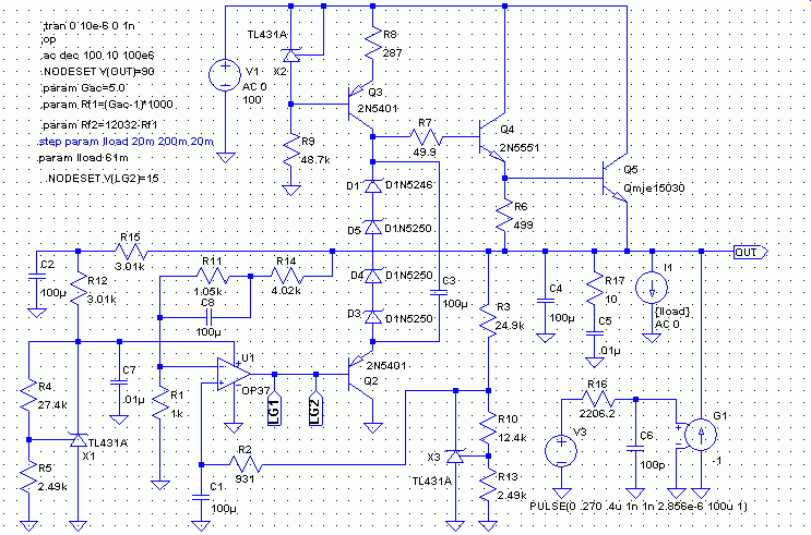

Here's a 90 Volt version of the "super reg" topology. Watch the dissipation in some of the resistors! Also the dissipation in the shunt reg for the op-amp is too high to use a TO-92 for the TL431. You'll need a DIP or surface mount package here.
I haven't built this yet, but stability and recovery from transient load currents have been simulated to death. A key issue in the stability is that it depends strongly on the non-ideal characteristics of the 100 uF load capacitor. Both the series resistance of around 0.25 Ohms and the series inductance of ~30 nH come strongly into play here. The load capacitor's series resonance is at about 93kHz which forms a low-Q notch filter which helps stabilize the circuit. Don't put a high Q 0.1 uF capacitor for a load! It will oscillate.

Andy C,
Your mods to the super reg look most interesting !, I had'nt thought of losing the voltage across those zeners whilst keeping a low impedance drive for the next stage with minimal phase shift as I would think this would do.It could be interesting to replace Q4 with a push-pull follower with a touch of forward bias and then change Q5 for a low-on-resistance P-MOSFET of suitable current rating(the op-amp inverting and non inverting inputs would have to be reversed to maintain the correct feedback polarity). If this proved to be stable, I suspect this could be as close as I am likely to get to the ideal power amp supply, especially if a much faster op-amp remained stable and in conjunction with remote sensing.
I also found the output capacitor to be critical in high performance regulators, simulation shows oscillation with ideal output cap which can be tamed with a small series resistance, about 0.007 R was about optimum in my simulations of other , lower voltage regs (tend to look inductive at output).
