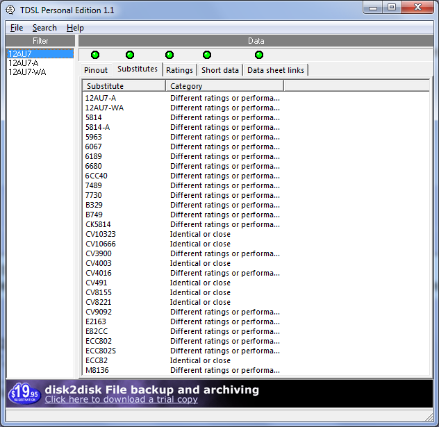

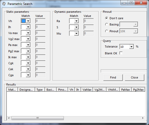

I haven't used this for a few years as it doesn't work on a Mac, but if I remember correctly it would be perfect for this search.
TDSL has a parametric search function which I've found helpful in odd situations.

It was by using TDSL that I was reminded of the ECC804.
