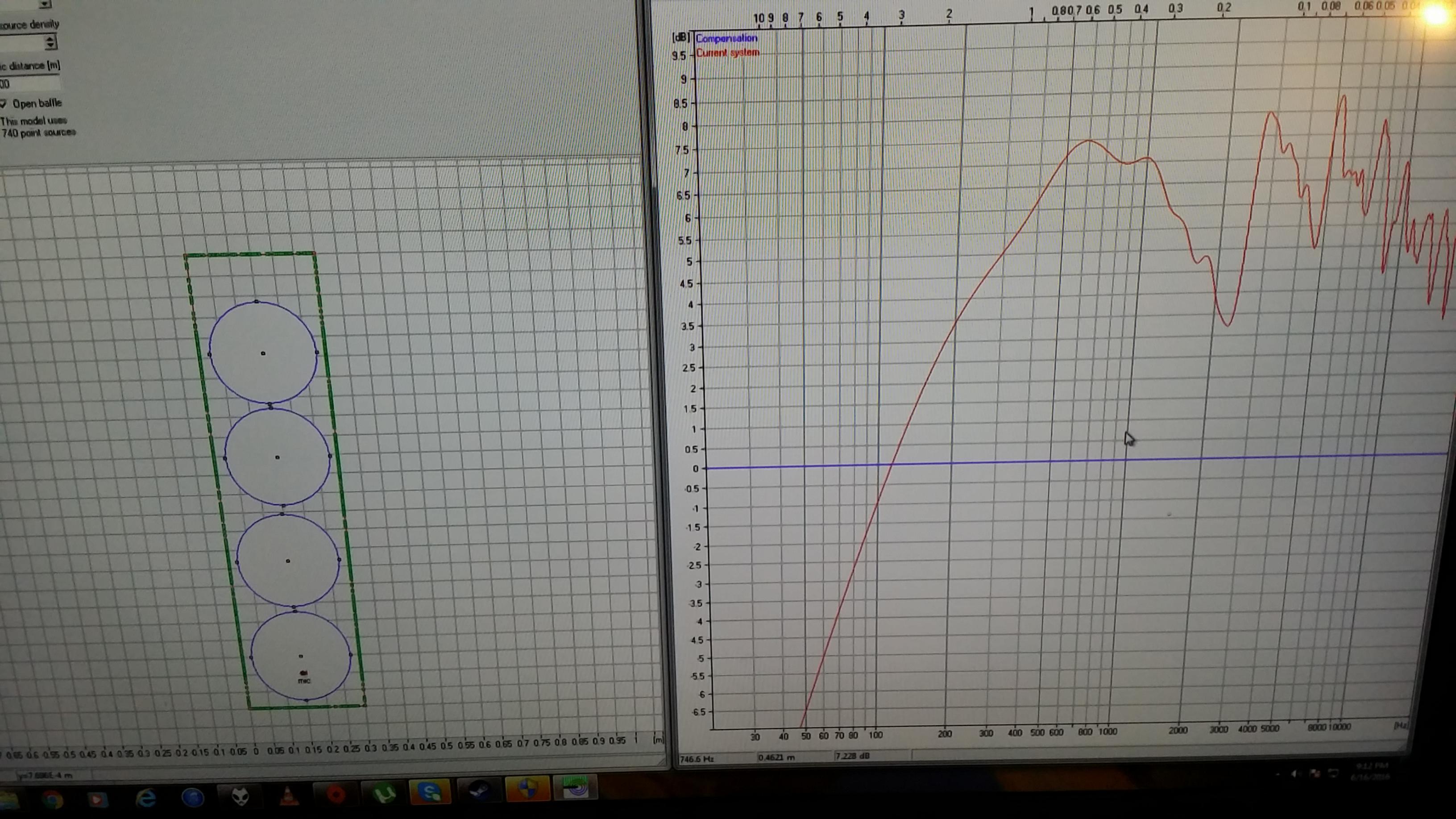

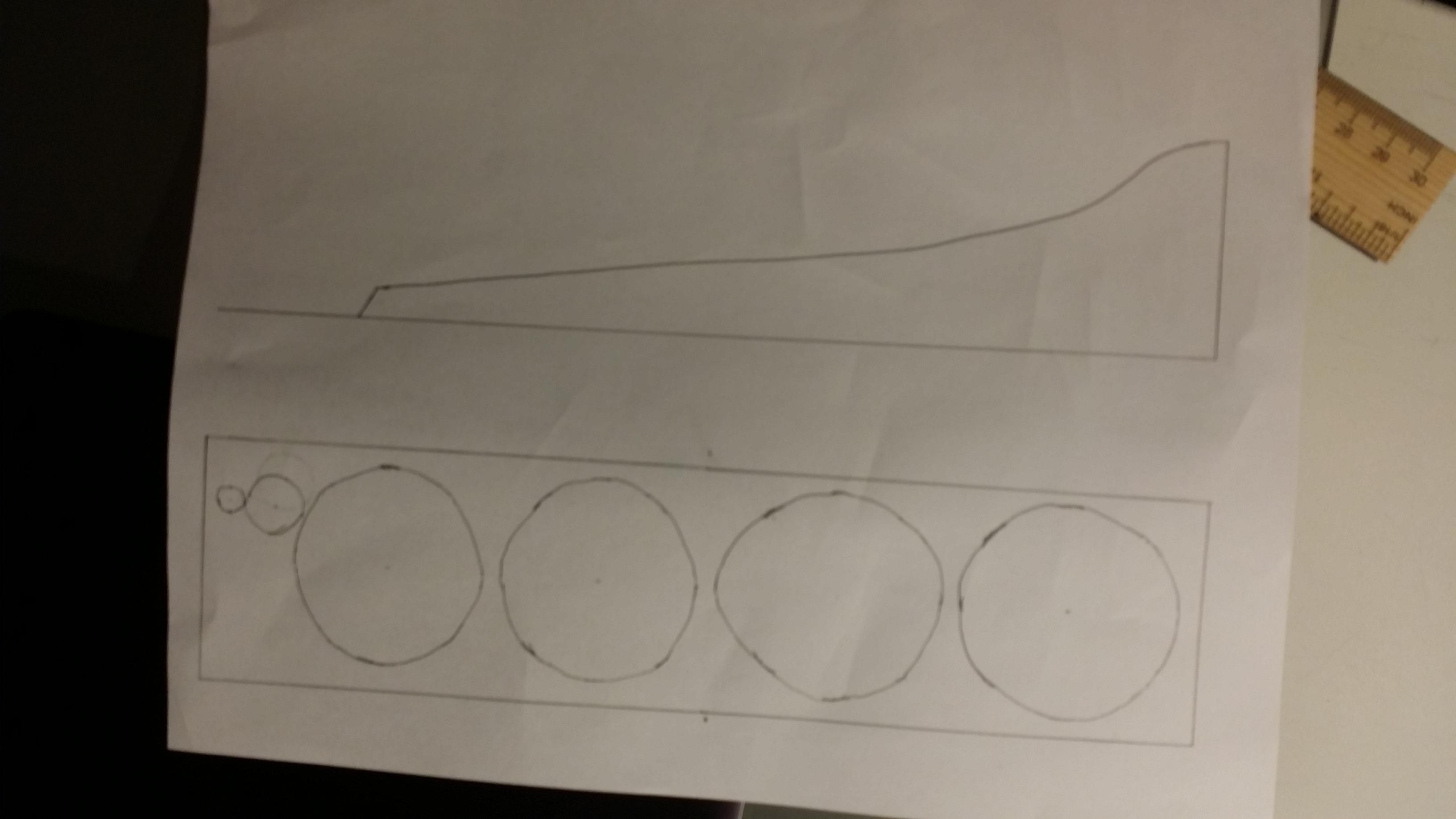

I think I'm gonna stick with the 4 x 10inch max width. Since I think I can achieve my 50hz goal pretty well with that, I'd personally prefer the sleaker look and especially the smaller footprint in my 200 Sq ft. Living room...
I drew out what I want to box to look like and it's something like this but with the 4 woofers a little closer together. Scale is 2 inches per centimeter and the baffles are 48x12 inches
This size baffle in edge gives me this response
The dipole peak is at 600hz which is a good spot for my crossover to my 3 inch midrange. And it is -12db at 50hz which means the 4 woofers in OB would have the same excursion at 50hz for the same output as 1 woofer in a sealed box. From previous experience 1 10 inch per side in a sealed enclosure can put out good clean output down to 50hz and if I need moreally headroom I can always bump the crossover up to 60hz.

I would not use multiple drivers over 100Hz
Curious, what is your justification for this? Interference? The effective "width" of the driver is 40 inches, which doesn't lead to any reasonable interference up to 400hz, and even then that's only in the vertical axis.

Martin King uses a small magnet high Q woofer and a wide baffle.
When you said 4x10" I imagined a square arrangement. A narrow line like that is going to limit you.
As John Busch can tell you, wider baffles sound more dynamic. You might be able to cheat some with side wings.
