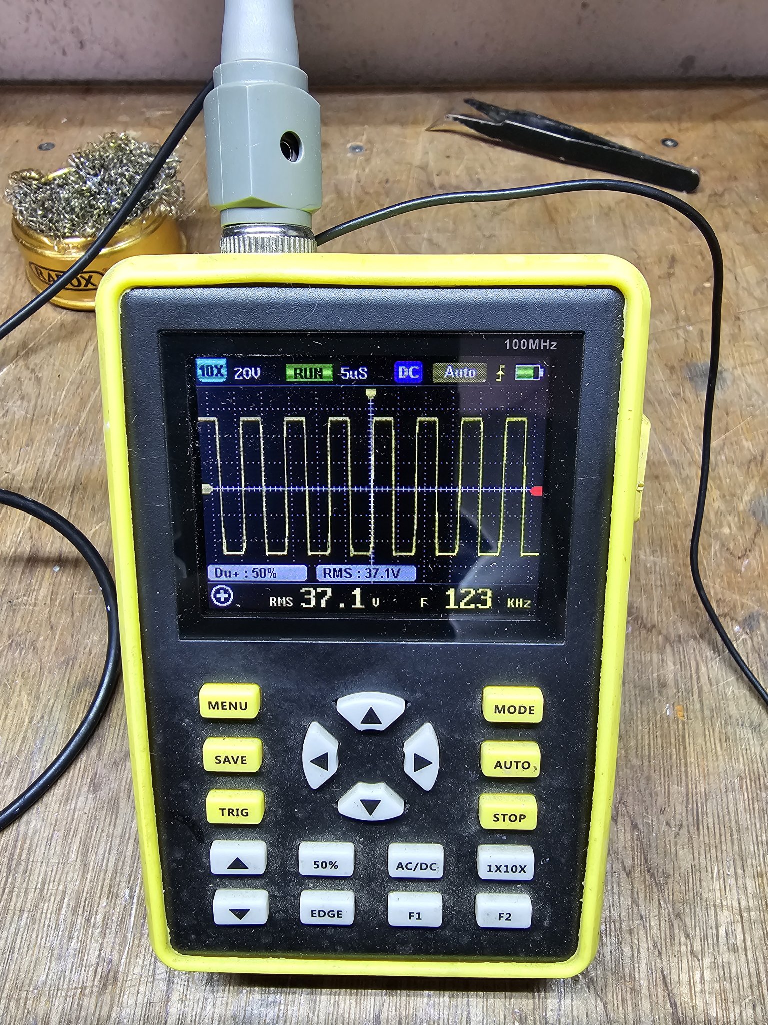

Hello friends, again bothering you, I have a Hifonics BXE2500.1 amplifier and the problem it presents is that the power supply fets heat up and the supply voltage drops from 12v to 9v with a high current consumption, I have limited the supply to 2 amps and consumes them, if I increase to 5 amps, it consumes them. The strange thing is that the signals for the power supply and amplification are fine and there is audio at the outputs, I do not understand why the power supply fets heat up and the excessive current consumption, in advance greetings

Good morning, Mr.

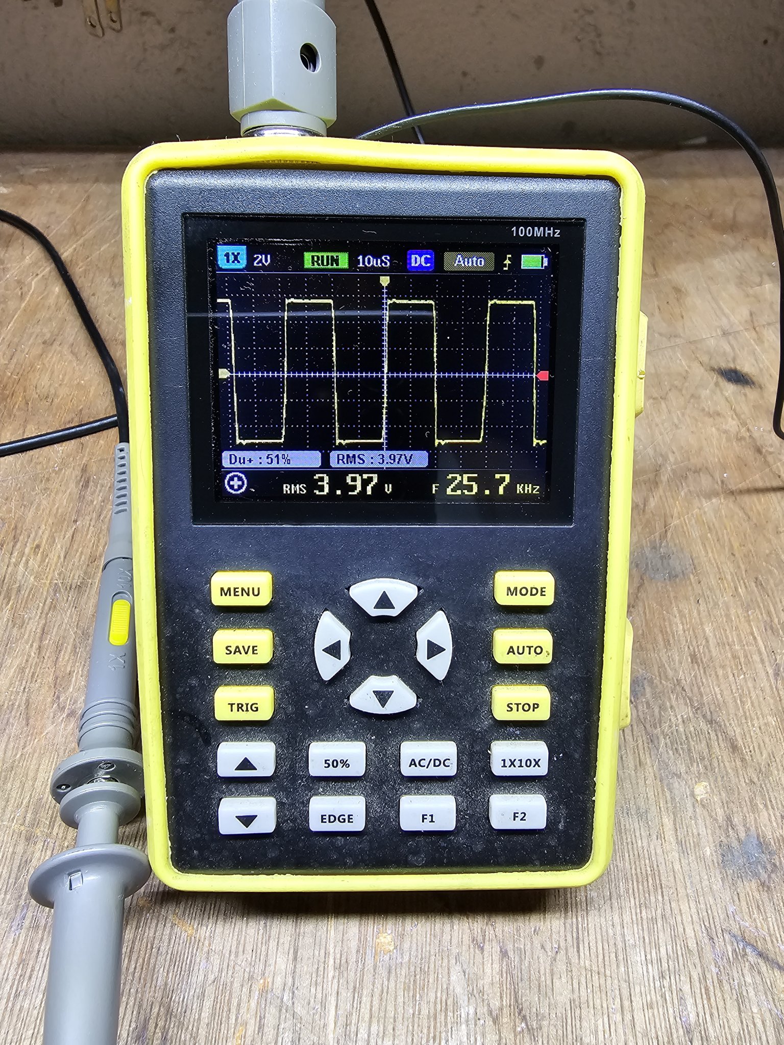

The amplification part remains cold while the current is limited. Note that when you raise it, the IRF9640 heats up, but the IRFP064N triggers brutally. I leave you an image of the frequency in the power supply.

Are the outputs swinging fully rail to rail?
Can you power up with no limiting long enough to see if they switch fully rail to rail at full current?
Are you sure that the PS gate drive signals are OK?
On these amps, the transistors at the top of the driver board (Q7, 11, 19 and 22) are always suspect and get replaced before there is any extensive troubleshooting. Do you have those on hand?
That is what is in all the banks of the outputs, this is done with the 10 amperes that the source gives, the current consumption increases to 7 amperes, I have changed transistors 7, 11, 19 and 22
