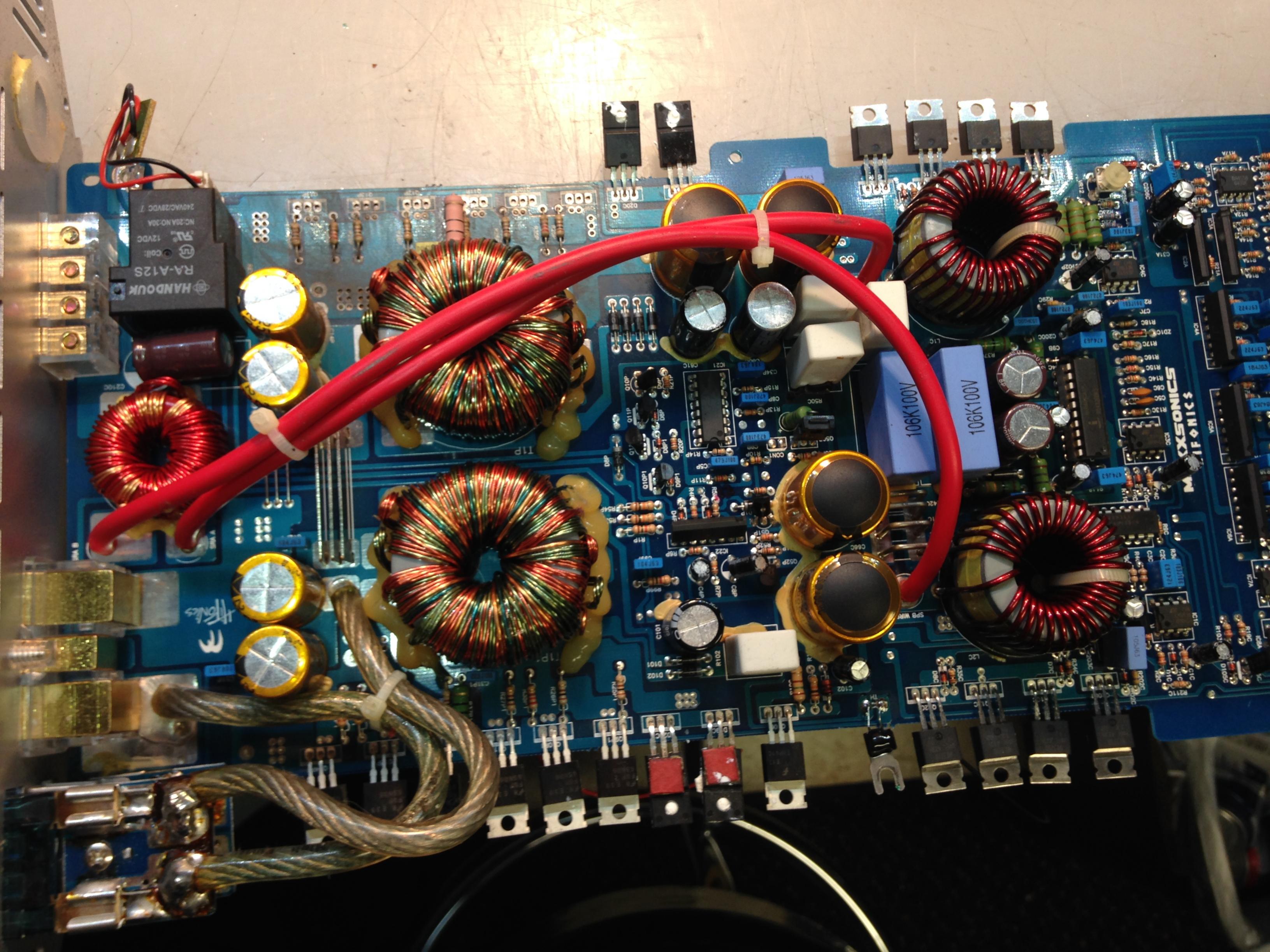

Amp will not start.494 is not getting b+ at pin 12 with remote applied.
Board is tough to trace due to being multi layered.
The sip opamp is also not getting B+.
Half the power supply was blown,not sure if there's a connection between both issues.
There is continuity from remote terminal to a resistor near 494.
Anyone know what's in the remote chain or have a usable schematic?
Remote drives Q51P on which drives Q52P on.
This is only a 2-layer board, as far as I know (no inner layers).

Hi Perry Babin.
Sorry for open here mi question..
I get an old bx1500D and it was not turning on. But was due to a bad trace. Now i fixed and it is working but the amplifier I believe that is not carrion the full power. it means when it kicks hard the amplifier goes to protection mode.
The legs of the transistors were verified and are not broken. I don’t know if the IRF3710 could be the root cause. I will replace for the IRF3710Z and I will review.. but if there is any other thing that I need verify please could you let me know.

THe IRF3710Z fixed the protection mode when it is working now the amplifier kicks hard....awesome things with only one kicker L712 at 1ohm.
but if any boydy knows the part number for the thermal switch TH located in the BX1500D board i will appreciate that.
In the future, please don['t post in a thread started by someone else unless you're trying to help that person. If you need to reference a thread or post, start a new thread and post a link to the previous thread/post.
The diagram states that it's a 150k thermistor (not a thermal switch).
