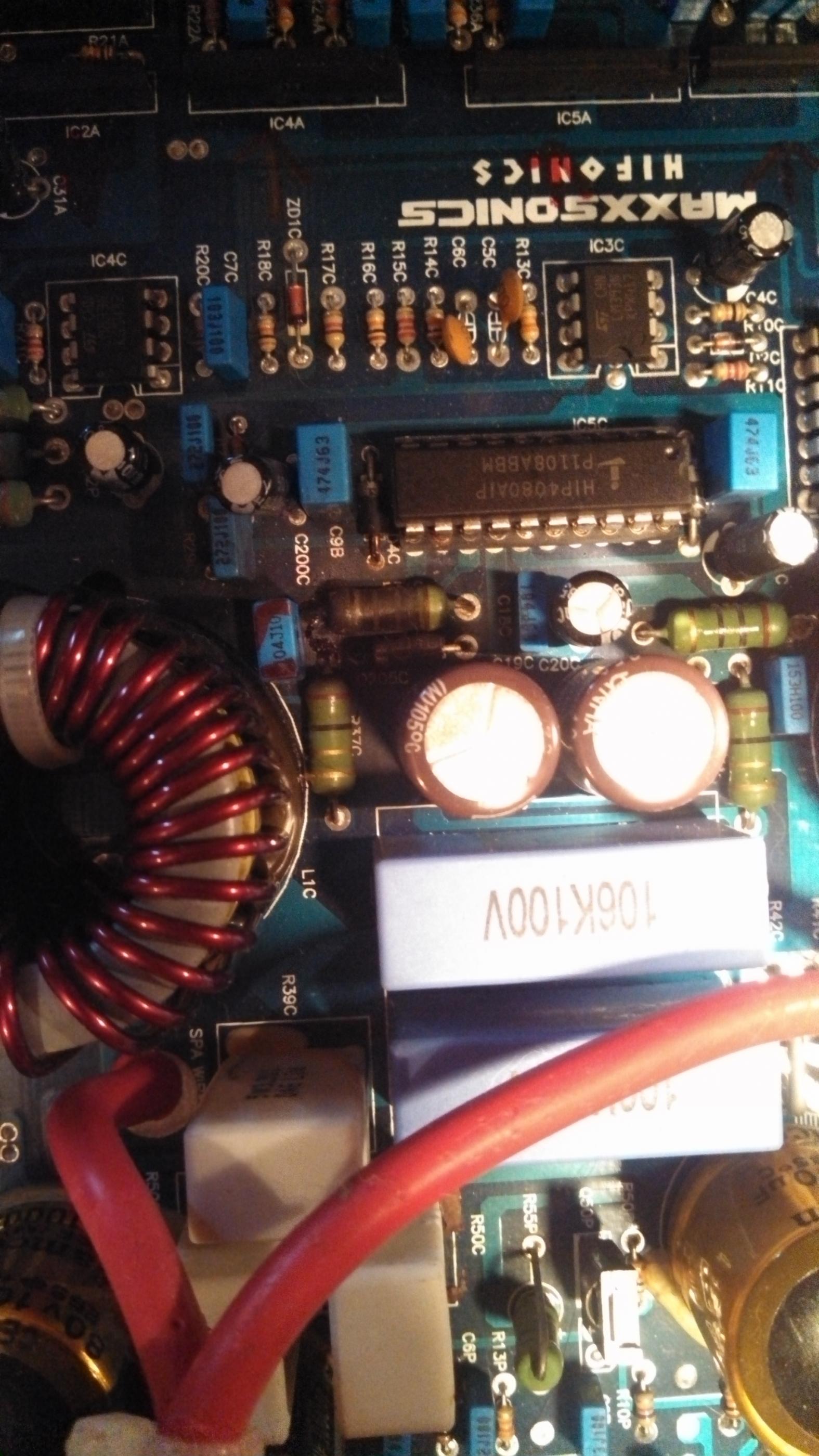

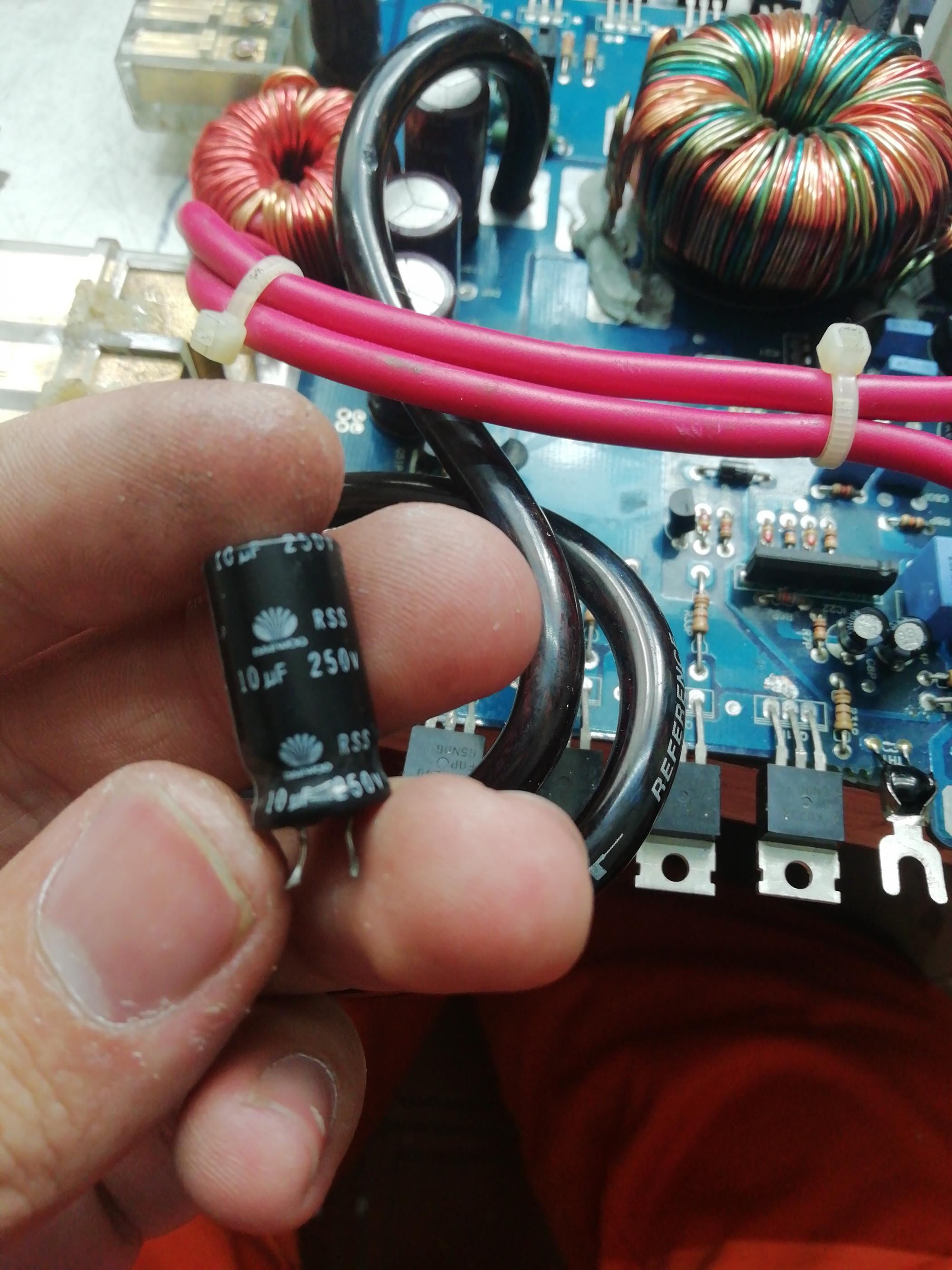

polarized capacitors typically have a line that indicates the negative terminal. Does this capacitor have such a marking?

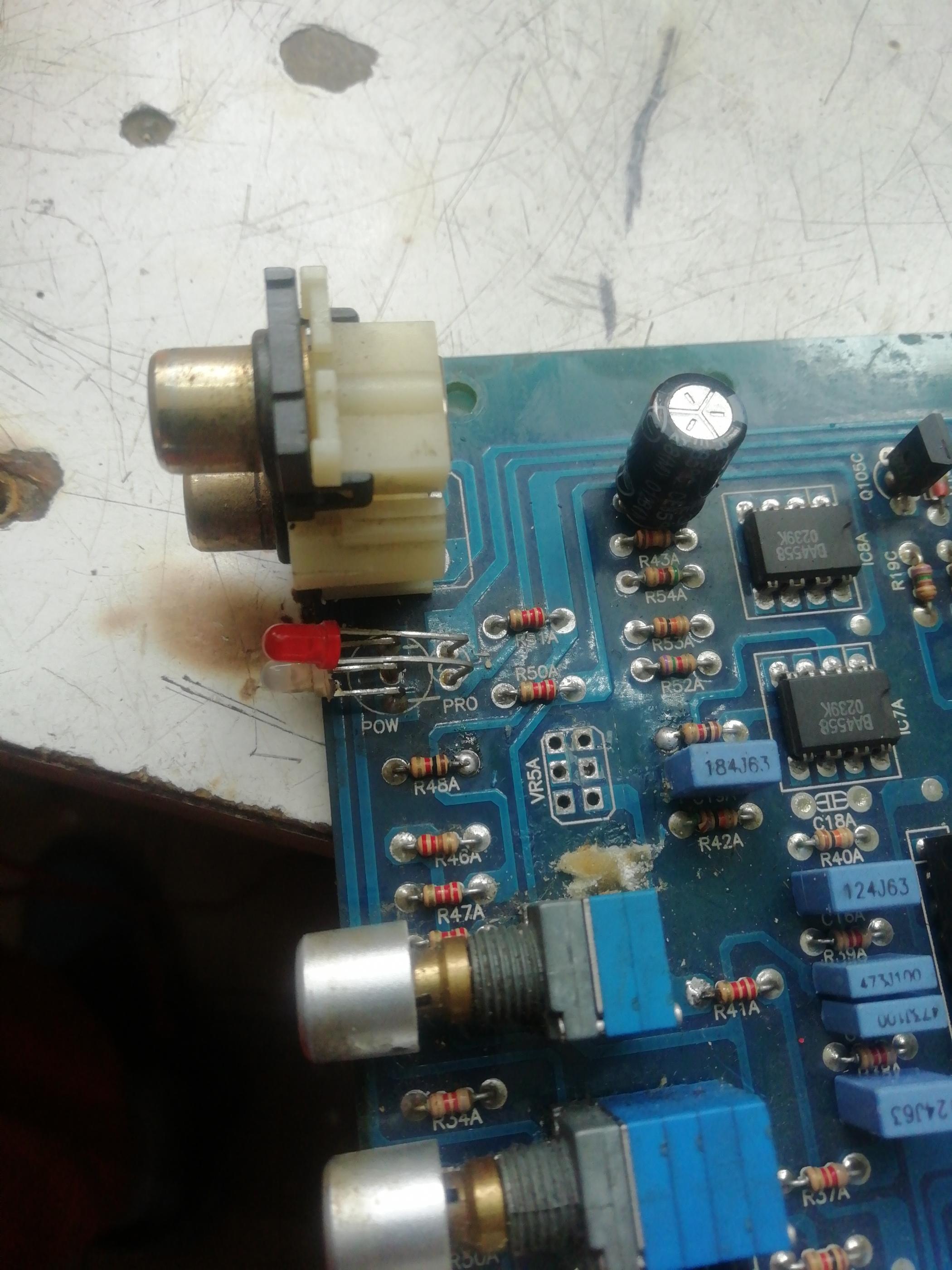

One LED has 3 terminals. The other has 2.
Does one terminal of each capacitor read 0 ohms to ground?

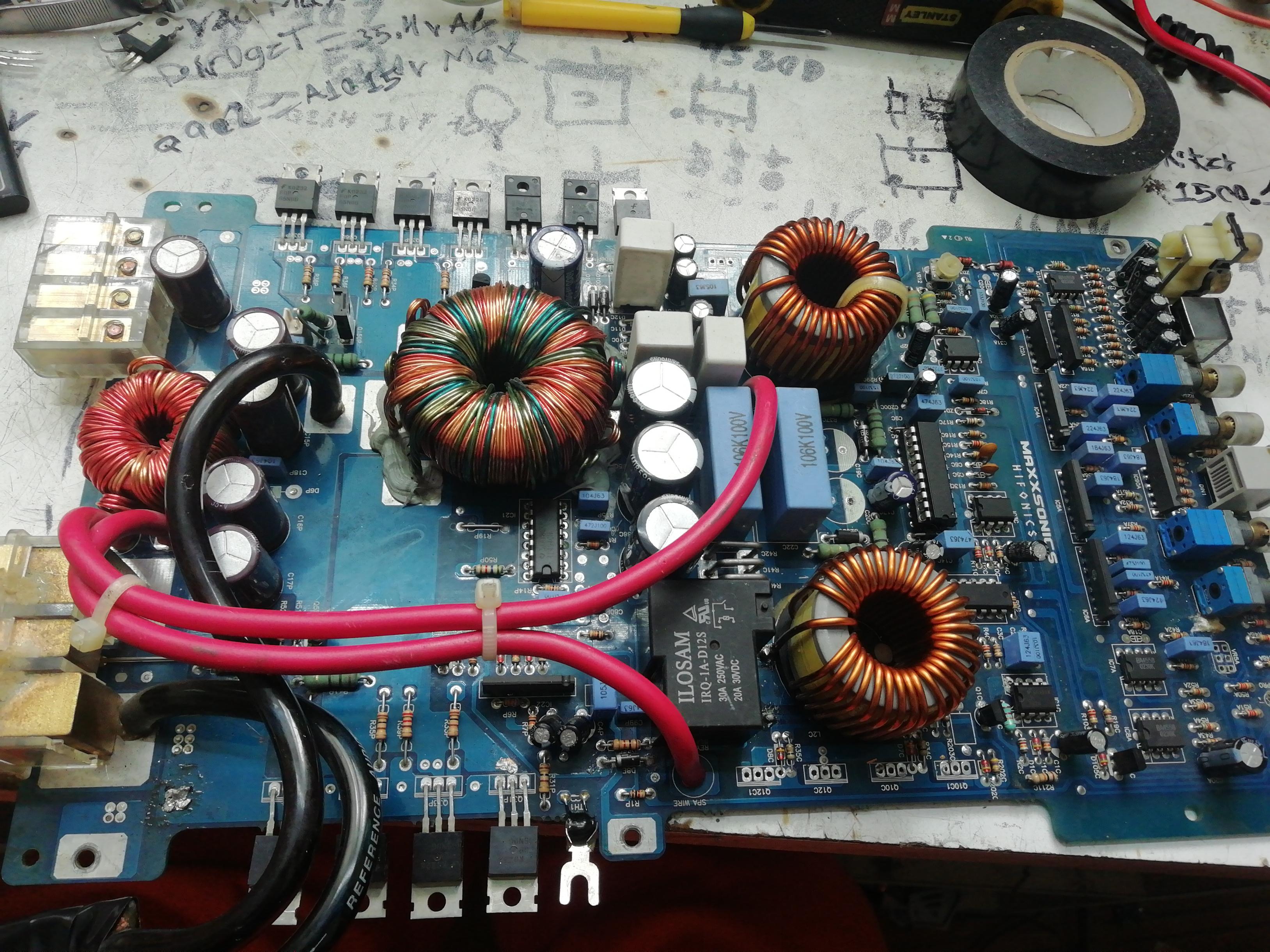

is that the problem I have is that the red LED turns on, not the protection LED the other one and the relay is not activated there is no audio the mosfet output is fine as well as those of psu leeo 46v 15+ 15- check the 2ohm resistances and pk diodes are ok does the same with or without the hip4080ipz
