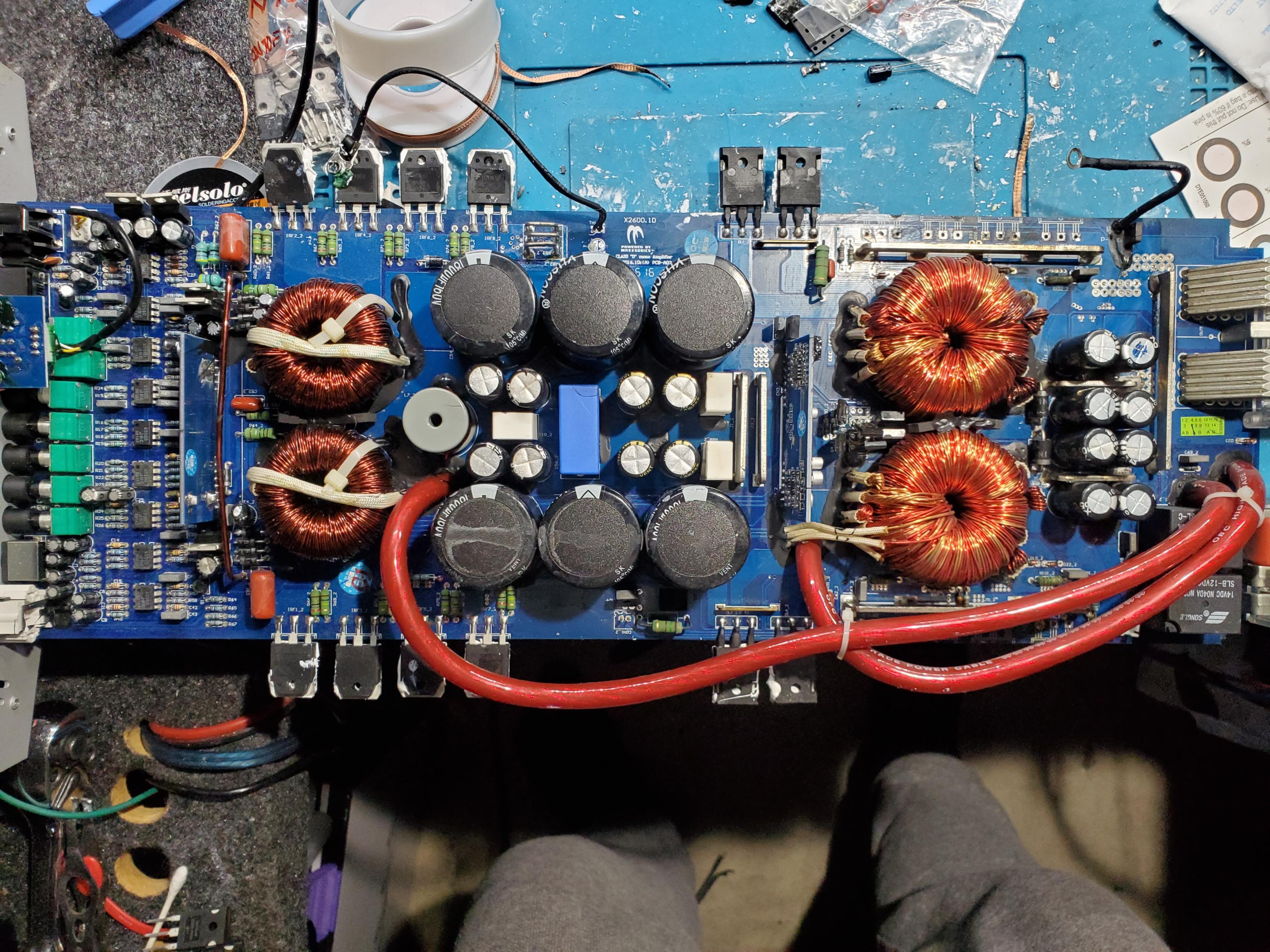

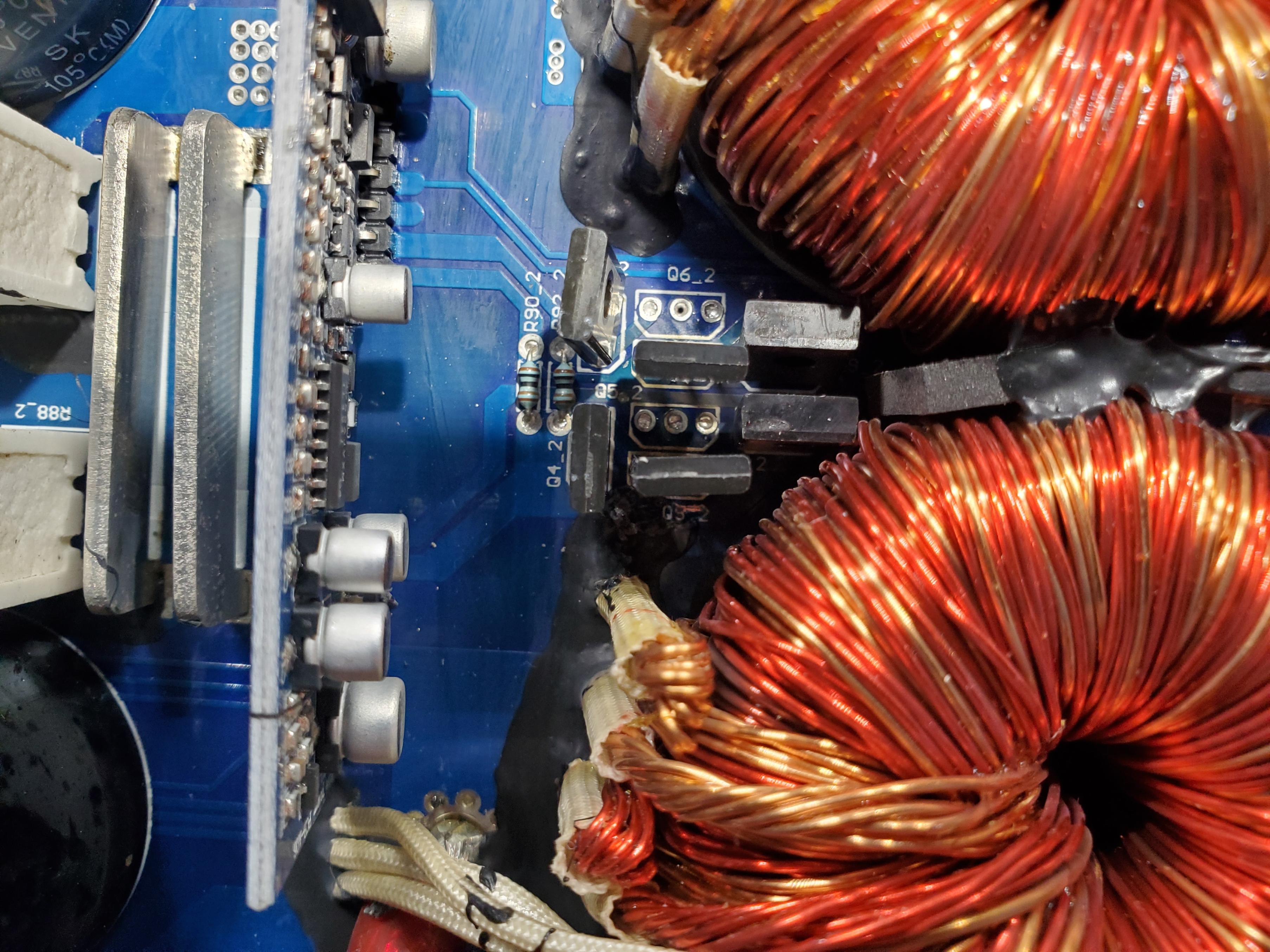

i could use some help with these drivers for the power supply. There may or may not be transistors missing. This is what i have.
q4_2 2sd669a
q3_2 2sd669a
q6_2 Empty
q5_2 2sb649a
q7_2 Empty
q8_2 2sb649a
q9_2 2sd669a
q10_2 2sd669a
are the empty ones i have for pnp drivers as well.?

Whenever you have an emitter follower configuration in power supply drivers, the PNP drivers will have their collectors connected to ground.

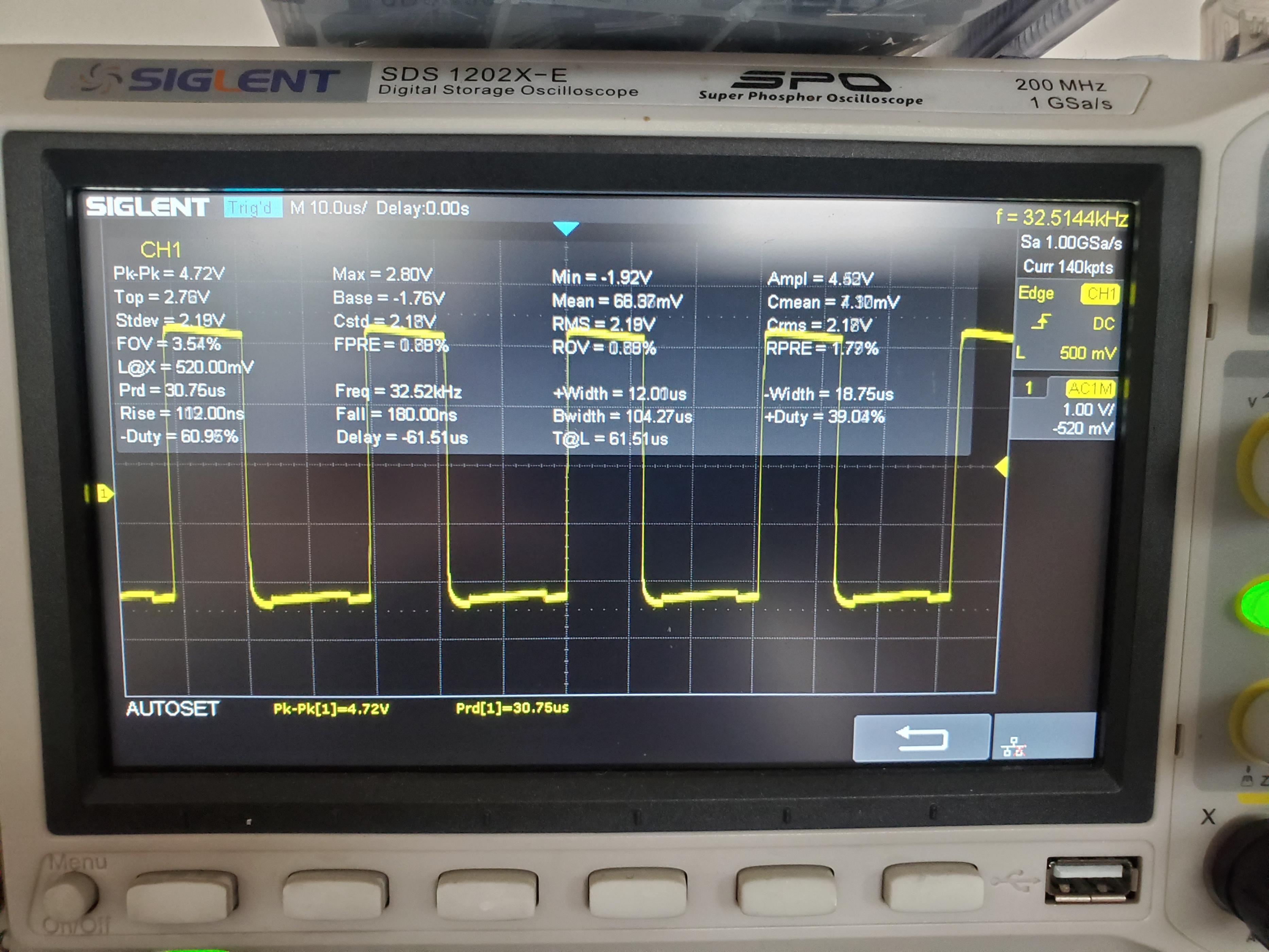

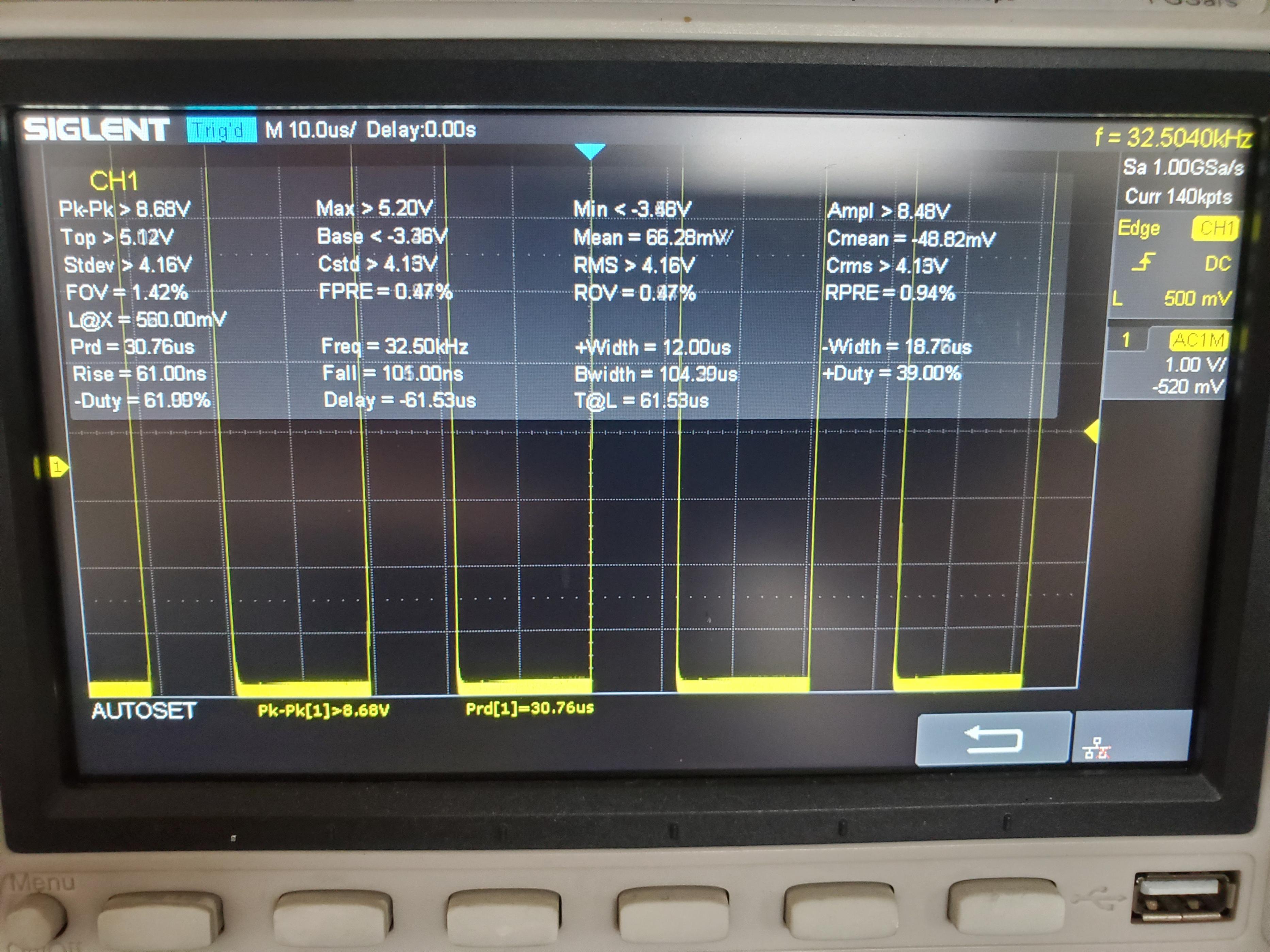

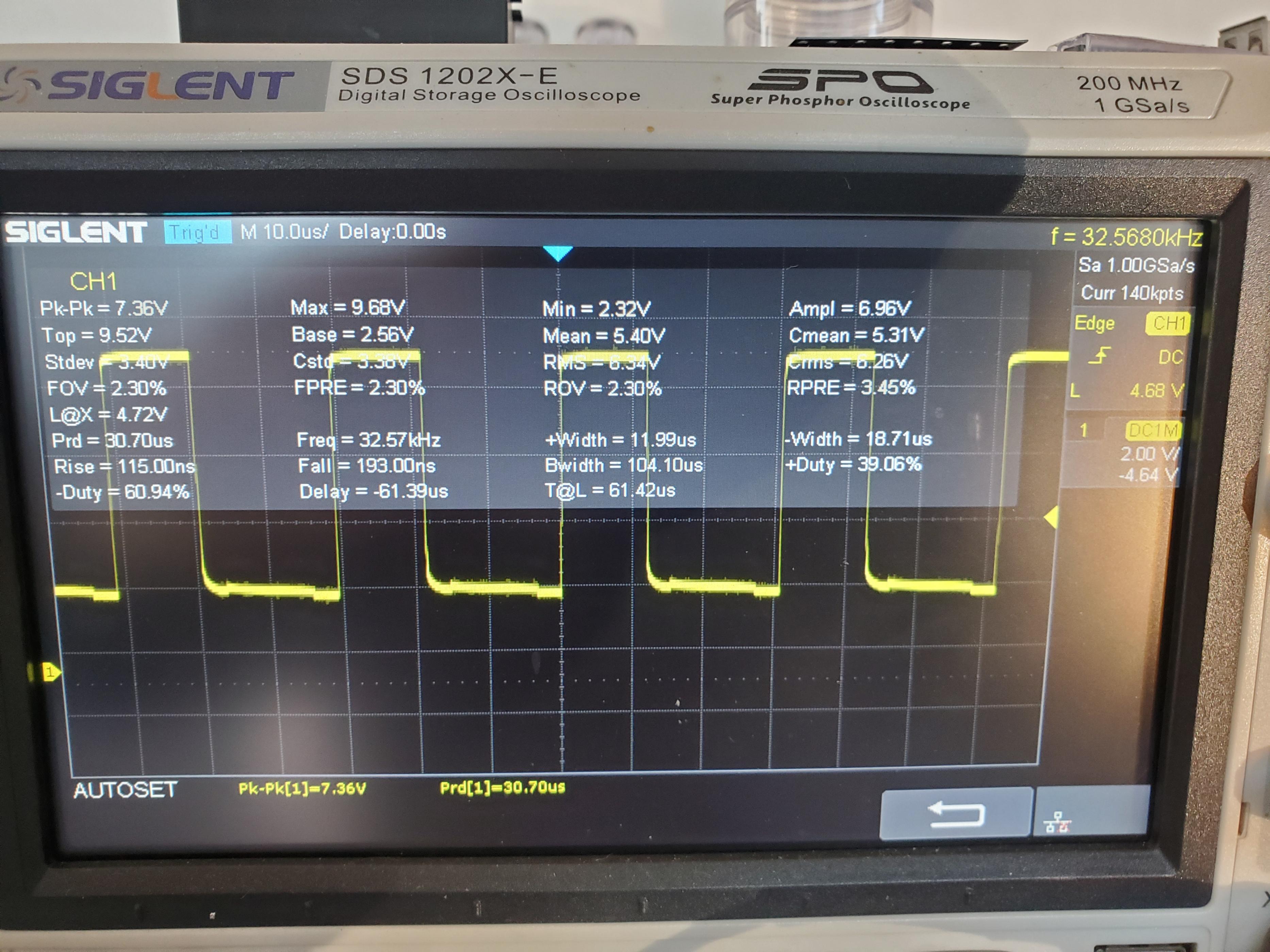

something in that bank pulls the drive down when mosfets or a capacitor is in circuit. drivers, or possible something on the driver card?
Are you saying that the amplitude of the drive at the emitters of the driver transistors drops when you use a loading capacitor (~0.1uF) across the gate and source of the PS FETs?
