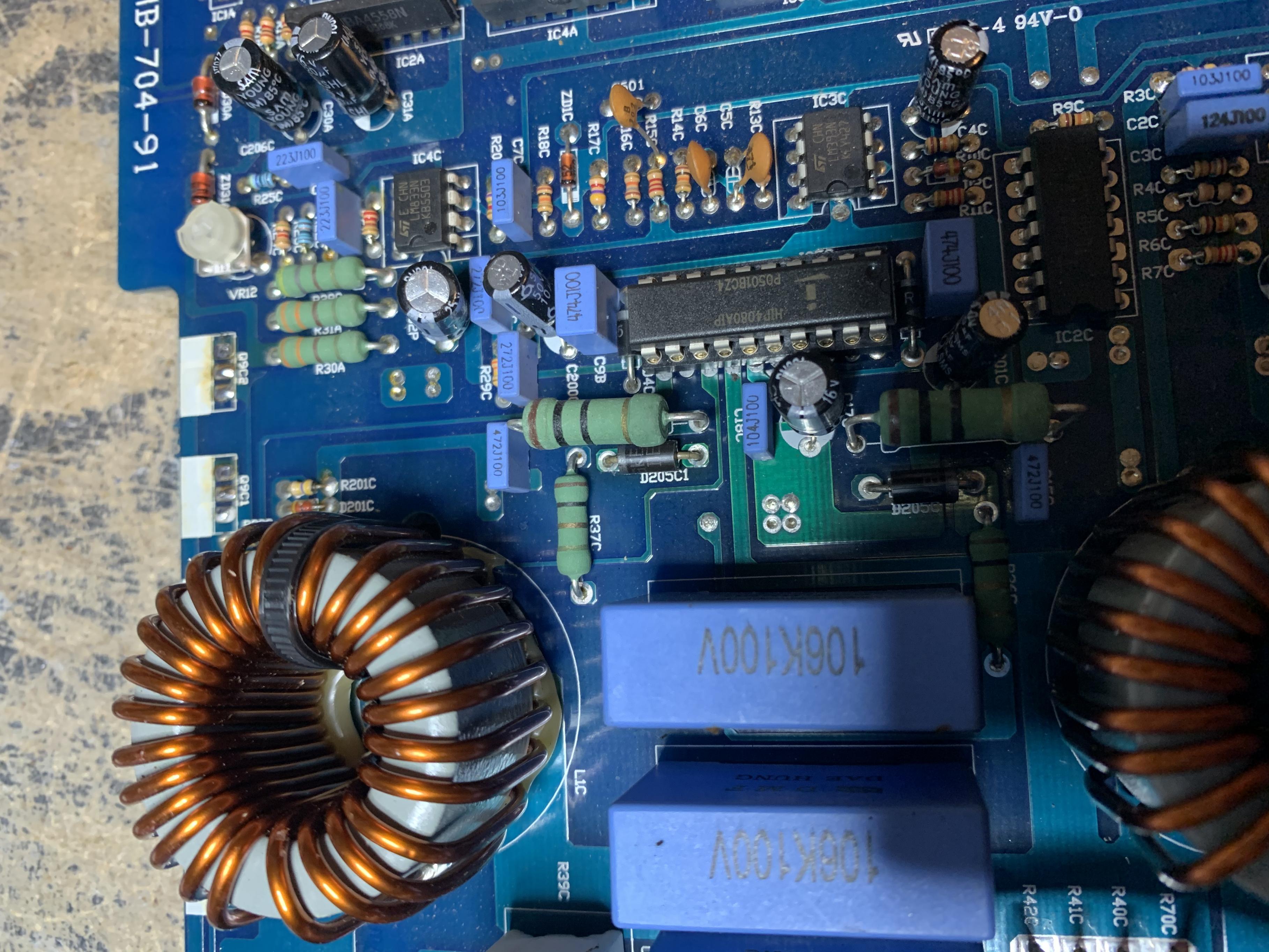

I’m working on a Hifonics Brutus amp with a HIP4080 IC driving the outputs. One side of the outputs showed shorted, and when I pulled the output mosfets from that side, only half of them were shorted. The gates resistors all check good, D205C1 tests shorted and R37C tests at .460 megohm. The sister resistor on the other side of the output section R36C test at 3.6 ohm.
The Anode side D205C1 connects to pin 12 of the 4080 IC through the larger resistor located beside it R31C at 12.6 ohms. The Cathode side of D205C1 connects to the inductor through R37C that is reading .460 megohm. I’m trying to understand what caused this failure and is it possible that the 4080 was damaged also.

Did you replace all known defective components AND the 4080 and it still acts like there is a shorted output?
No. All I did was pull the output mosfets. I don’t have another 4080 IC. I’d have to try to find one if it’s shorted. It is socketed though. I could pull it and see what happens. I was curious as to what caused the diode and resistor to fail. As in, did the IC fail and cause the short or did the mosfets fail and cause the shorted components. The mosfets didn’t show any outward signs of failure.
In most all cases, both fail and it's difficult to know which failed first.
Without the outputs, you can check the drive signals at the output gates to see if the IC survived. Few do and the ones that work often do so marginally.
Should I pull the output mosfets from both sides or will I be able to check just the side that was shorted without pulling the other mosfets?
