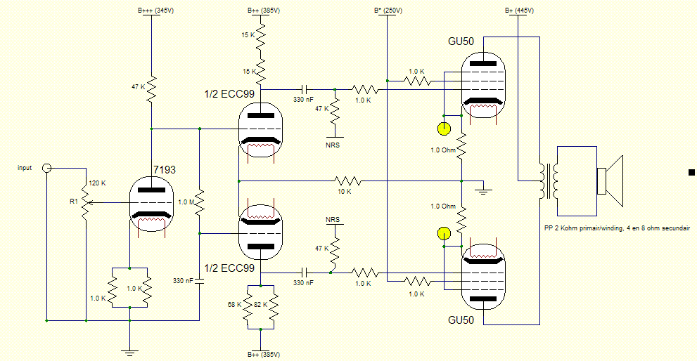

I made a GU50 push-pull for a first project. A little over 60Watts!.
The lows are incredible!
It's a derivation of a schematic that was meant to be cheap and good. The 7193's can be interchanged with any 6sn7 equivalent!
If you are interested in a schematic:
